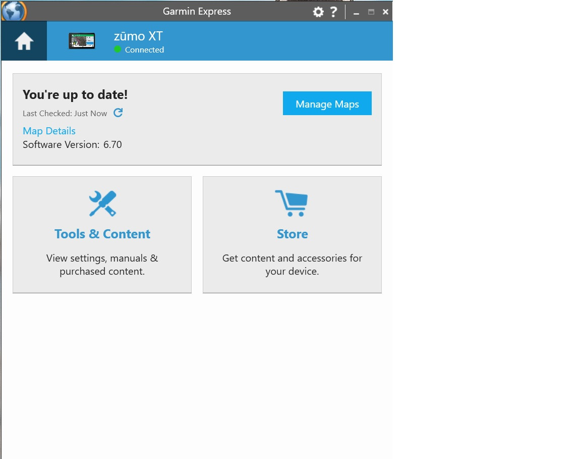

Here's what I get with GE 7.28.0 with Win 11.
Initial page

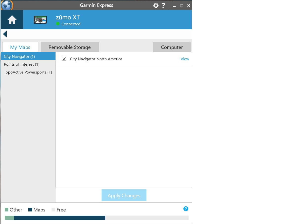

Then after selecting the Manage Maps button I get this screen.

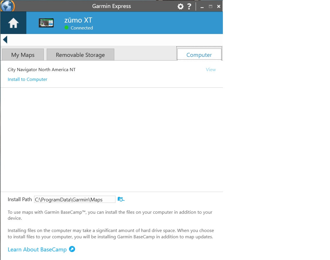

Then I select the Computer tab.

Thanks to @electro_handyman for showing me the way. I'm old, and that's the story I'm sticking to. :oops: :roll: . For what ever reason, I never even looked at the Computer tab, all I kept focusing on was that under Map Details, there wasn't the option for installing the maps to the computer. And I did install the new maps to the XT2 with GE 7.28.0.0, so in my mind there should have been that option there. Under the Manage Map button, to me it looked like it was just listing the maps installed on the Device, Removable Storage and the Computer, and since I know I didn't have it on the PC, I just never looked there.
