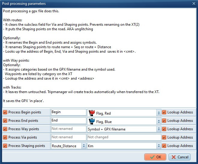

Maybe, just maybe this is the result of the Postprocess function of TrIpManager?
I have never noticed weird results with CEP when a GPX was postprocessed by TripManager, but if it would, I would like to know.

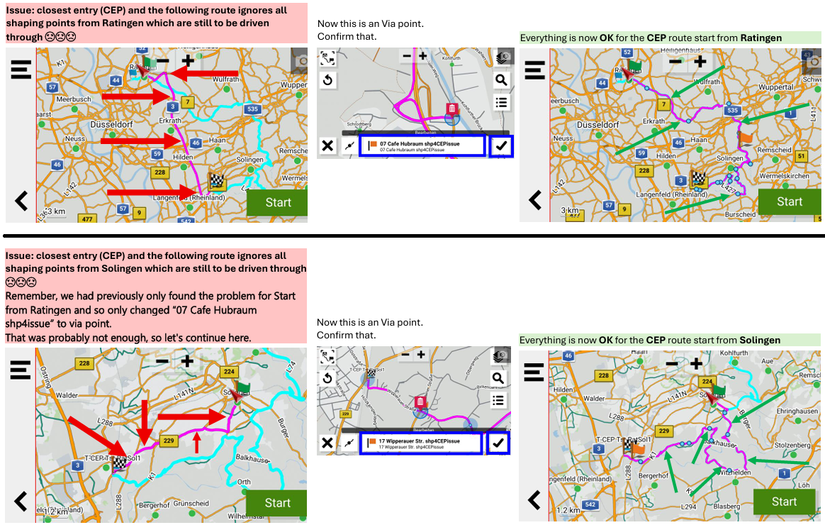

So, it's done for now.
I have now also worked out the appropriate demo for the compilation of CEP findings I posted a few days ago.
CEP Tst RatSol BCshp Nok.gpx
(357.41 KiB) Downloaded 19 times
Don't worry, it's only a “small” route with 2 issues included.
Additionally the CEP issue also is documented step by step. You can see how two CEP Issues issues appears and how I was able to fix them myself during the trip with the zumo XT2 as an example.
_CEP_Issue_Guide EN.pdf
(2.16 MiB) Downloaded 21 times
Please take a little time here :-(
Attached is the matching PDF and the matching GPX template.
Content al little bit more like this ;-)
Hopefully my experiences will also help you. :?:
