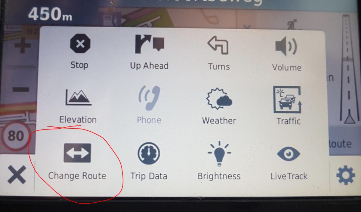

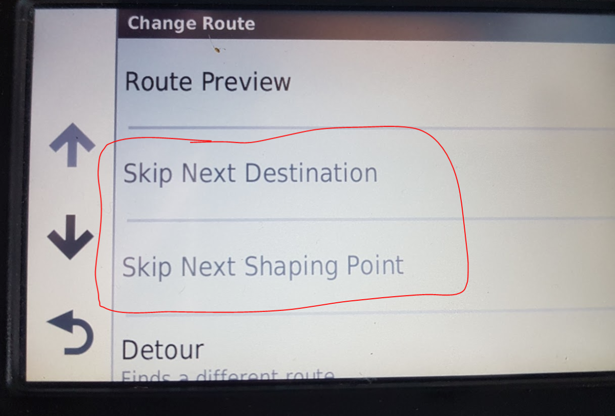

'skip next destination' is in the Change route menu in Map Tools.

When I select Settings/Map & Vehicle/Map Tools I am sent to "Select Map Tools". I am given a checkbox for turning on or off Change Route. That is, I can add it or remove it from the "Quick" tools button. But I cannot 'skip next destination' there, not on the 595.
Am I doing this wrong?

you can find the 'Map Tools' on the map page, wrench button, lower right corner.
not the most easy accessible place though.
