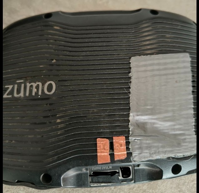

I wasn't comfortable with my soldering skills.
So I bought some electrically conductive tape and added two layers of it to the pins in the device.
After a day's test ride, this seems to working.
The duct tape is there because I lost the rubber cap sealing the usb port

Re: 396 goes off and on by itself while navigating.
That's a better solution.
With hindsight, the adhesive on the reverse side of the tape may not make a good electrical contact with the pads on the Zumo.

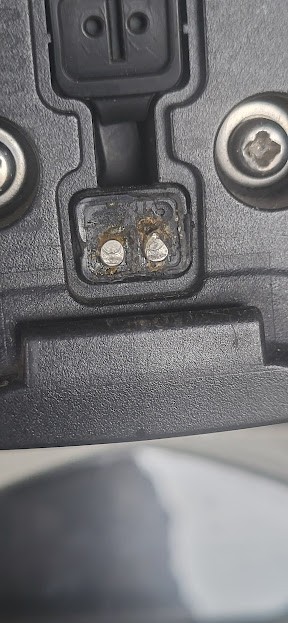

Yes, I have. It's a 390 but looks identical on the photos. The pins on the cradle were visibly recessed too far, and indeed were bending over. I kept having to re-align them with a small screwdriver, but this was only a temporary cure. So I carefully blobbed a bit of solder on the cradle contacts. It takes a bit of care and persistence, as the gold contacts don't like solder. And I took off a bit of surrounding rubber with a scalpel. But I succeeded in the end, and have had no problems since then. (Well, until my Zumo died last week, after downloading an update!Totti wrote: Mon Jul 28, 2025 6:27 pm , I was wondering that has anyone tried to solder these pins so that they would be higher and the connection would be better and firm?
