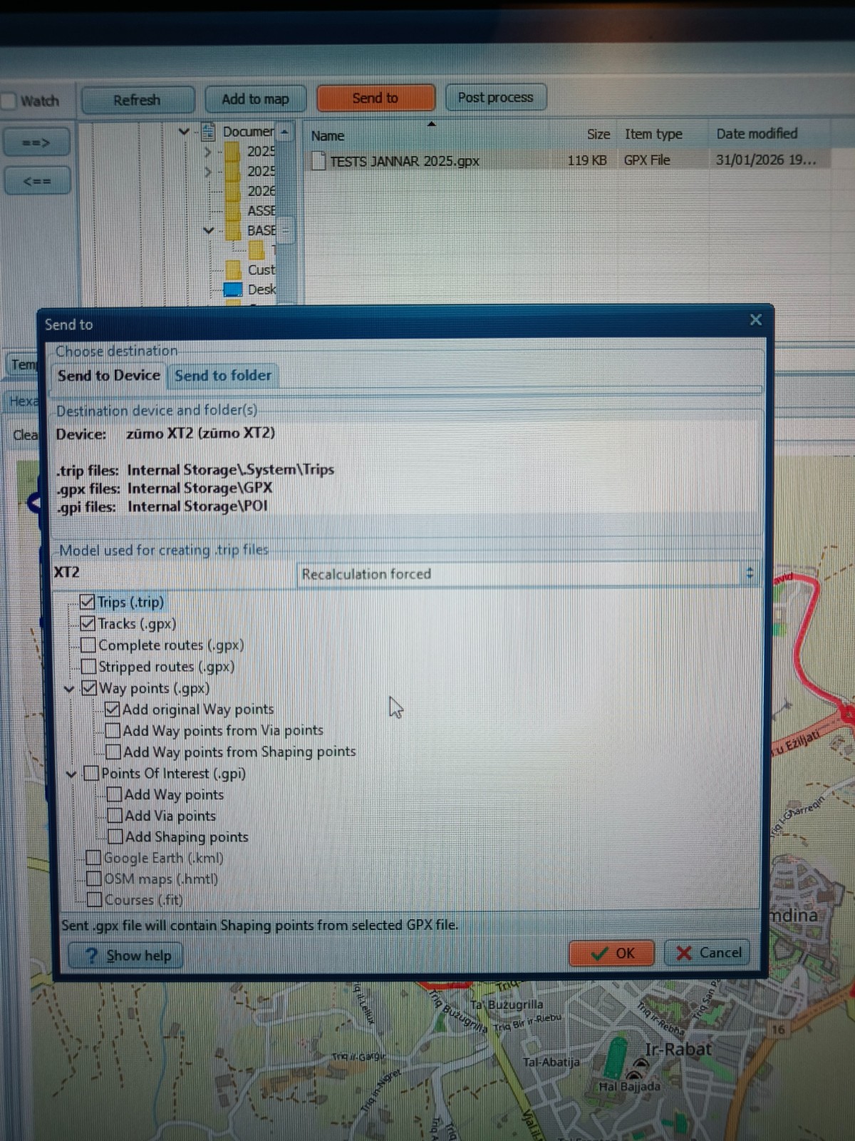

5) Ticked Trips, Tracks, Way points and Add original Way points and clicke OK.

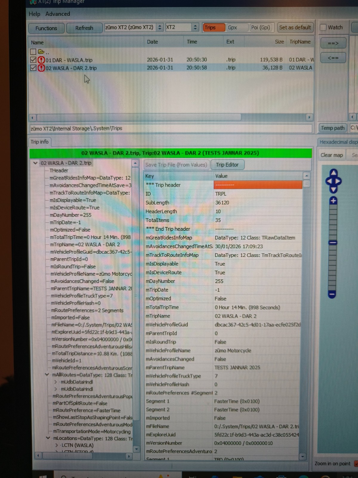

7) Disconnected device and powered it up.
8) Opened Routes on device and clicked one of the routes. But this message came up: Maps used to create this route was not found on the device. Recalculate and save a new route using currently available maps? Choosing No takes you back, choosing Yes recalculates Route BUT although all Shaping and Via points stood their ground, route was definitely recalculated through different streets. This happened with both routes. Process was repeated multiple times with same result. What am I doing wrong? I have planned routes on Basecamp with THE SAME maps on device and to be extra sure plotted them on maps on device rather than the same maps installed on desktop. EDIT: forgot to say that device is set on Fastest calculation

Re: Introducing TripManager
I see you have 'recalculation forced' set in the Send to dialog. Set it to 'not forced'.
If that does not help, can you post the GPX?

Thanks Frankb!
I have done some preliminary planning with NO recalculation forced (Basecamp calculated GPX only). On powering up the XT2 and choosing routes message "Maps used to create this route cannot be found on this device. recalculate and save a new route using currently available maps?" was not displayed.
