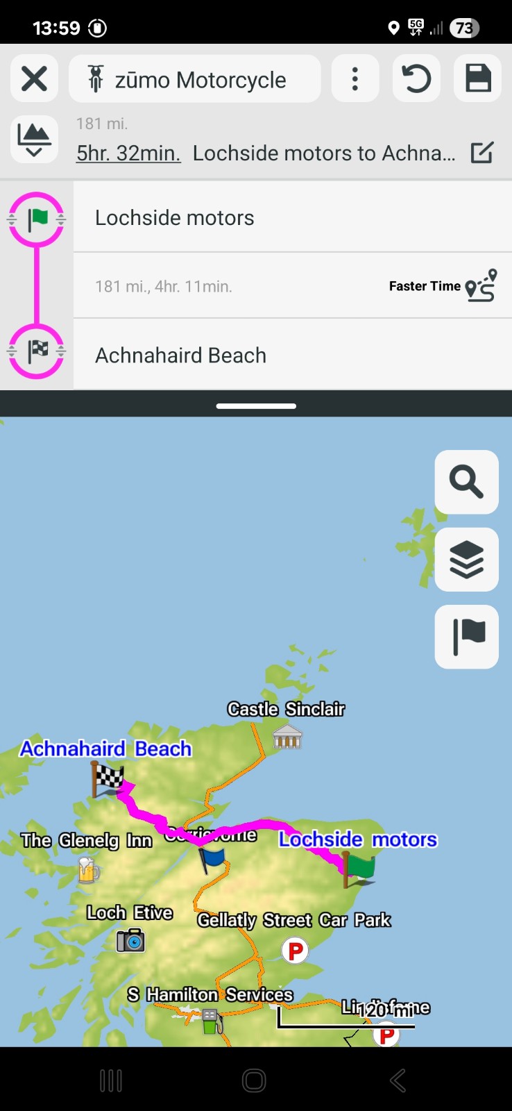

A new problem, or one I'd not noticed before.
The time between the start and only other point, ie the finish, should be the same in the headline journey time as the time between the two points. Except for the attached it is badly wrong!
Reported in Tread.
