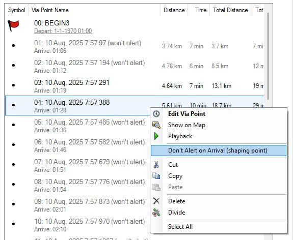

This is what very likely happened. The 550 had no notion of Via and Shaping Points. So you never had the problem with the 550. The XT(2) has, but the nr in a route is limited.
In Basecamp a point in a route can be set to 'Alert on arrival = Via', or 'Dont Alert on arrival = Shaping point'
When a XT(2) receives a route above a certain nr. of Via Points (Alert on arrival) it will split it up. Dont know the exact figure, but is something like 30. The resolution is to set the points to 'Dont alert' in BaseCamp and send again.
