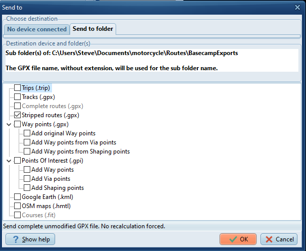

Thank you @jfheath and @Peobody I now understand Peobody's issue. I did not realize that, when the route is built from Waypoints, Basecamp includes the Waypoints in the exported gpx even when you try to export only the route (the selection).
I think Trip Manager offers a possible solution. In "Send to" it can send "Stripped routes". That will keep the route, but remove the waypoints from the gpx file so it will prevent the waypoints from cluttering up the saved list.

smfollen wrote: Sat Dec 06, 2025 2:40 pm

jfheath wrote: Sun Dec 07, 2025 6:00 pm I don’t know about that.
I do know about that. (I should!)
A stripped route in TM is a route with it's Ghost points stripped. You will only find a route <rte> with routepoints <rtept>. Much like the MRA GPX 1.1 format. Neither does it include tracks <trk> nor Waypoints <wpt>
