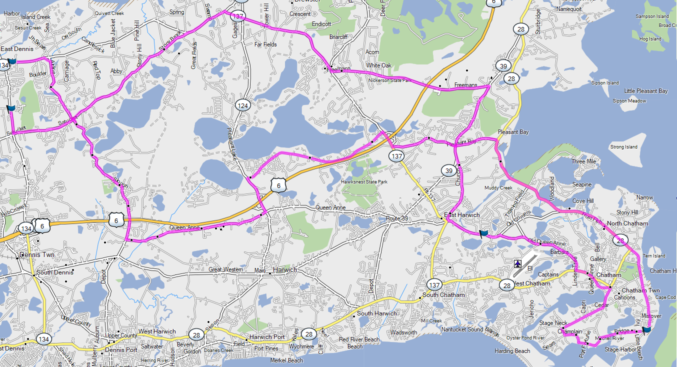

The issue I originally reported, and recently retested, starts with a route containing multiple via and shaping points, imported onto the XT2 via gpx file. That route is not on the Tread App, nor on the Explore Web page.
The route in the gpx file imports without issue and is unchanged on the XT2 as long as no sync occurs. This remains true over long periods of time.
If I later allow a Tread / Explore sync to occur between my XT and my [one] phone, then the route on the XT2 is changed. The via points are not changed, but the shaping points are moved significantly. It appears that something in the sync process is either moving the shaping points or is deleting the original ones and creating new ones.

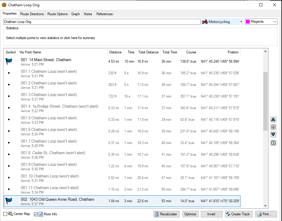

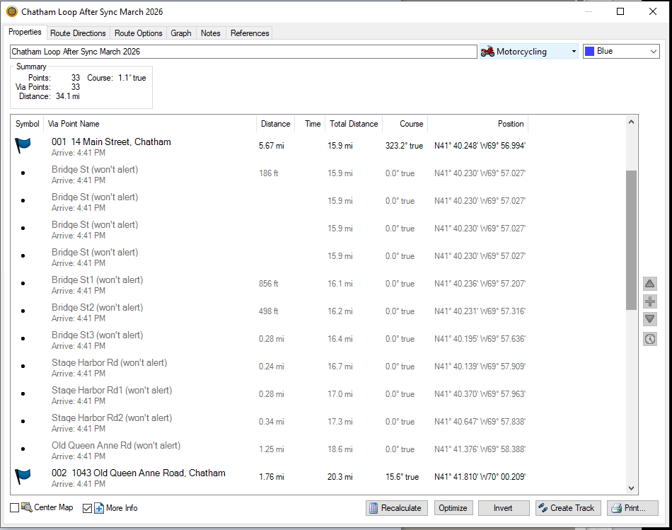

Here are the 11 shaping points between one pair of via points in the original route
and a very different 11 shaping points between the same pair of via points in the route after the Tread / Explore sync. Note that the first four shaping points are the same point repeated.

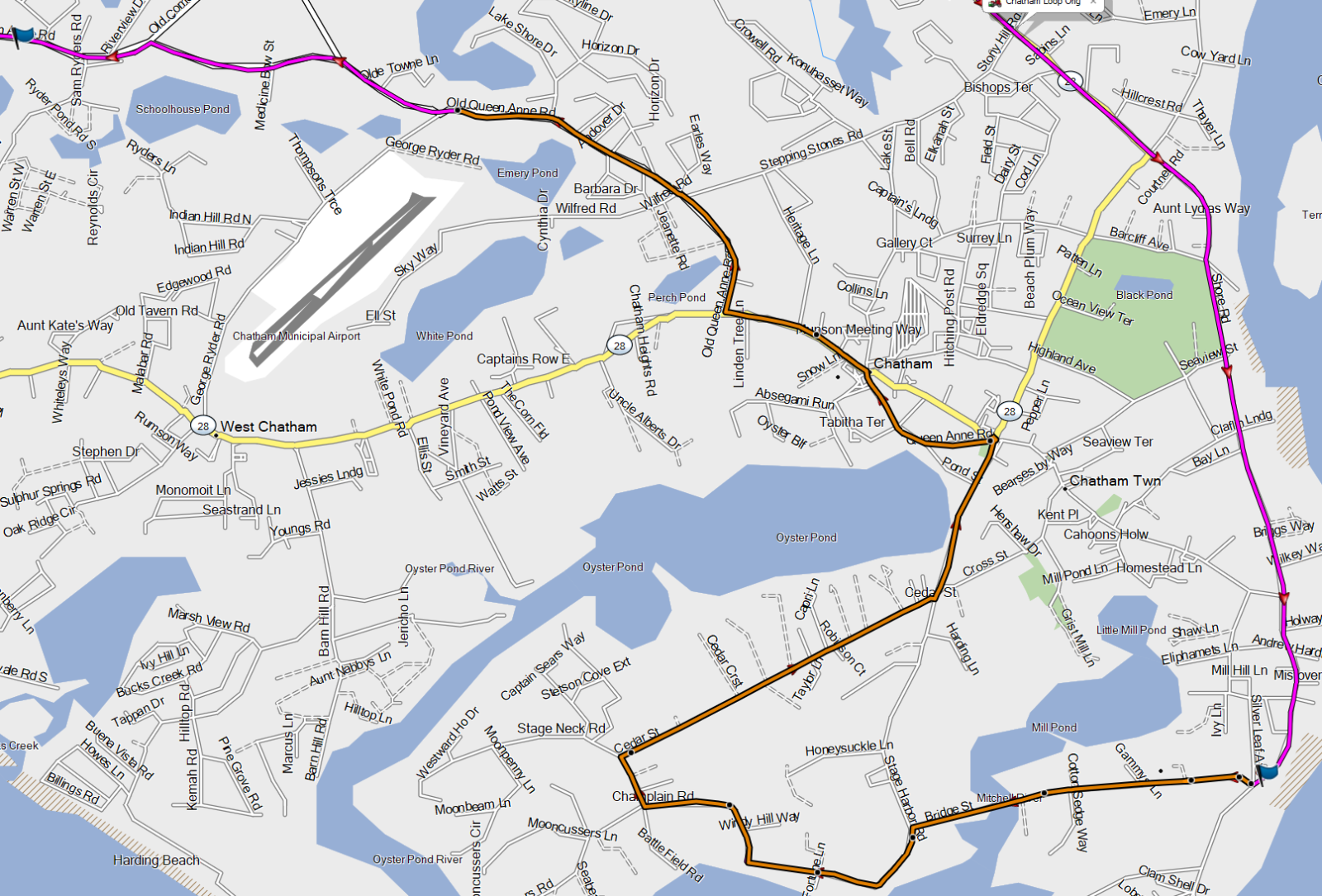

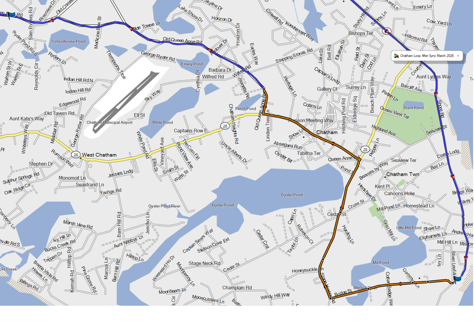

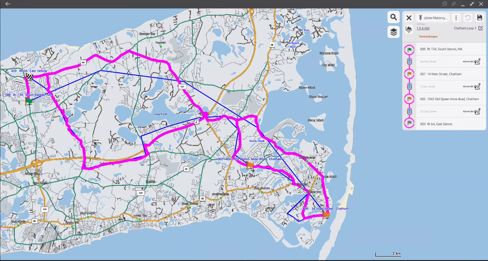

On the map, the original segment
and the changed segment after sync
Note that I used Basecamp to illustrate and capture screen shots here but the routes are the exact routes from the XT2 before and after sync.

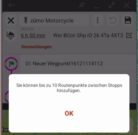

Regain wrote: Sat Feb 28, 2026 5:58 pm @BasPost where did this message about 10 shaping points between via points originate? I have some routes planned for a tour in June and each one of them calculates both in Tread and the XT2 with many more than that. I’ve just tried one of them that has 37 shaping points between vias and it runs just fine.
Francis wrote: Sat Feb 28, 2026 6:07 pmMaybe it's not 10 shaping points in total in whole route, but 10 shaping points between every two waypoints?Regain wrote: Sat Feb 28, 2026 5:58 pm @BasPost where did this message about 10 shaping points between via points originate? I have some routes planned for a tour in June and each one of them calculates both in Tread and the XT2 with many more than that. I’ve just tried one of them that has 37 shaping points between vias and it runs just fine. ...
Just for your information,Regain wrote: Sat Feb 28, 2026 6:20 pm @Francis that still doesn’t seem right, as stated I have 37 between two via points (start and finish of the 186 mile route).
In newest Tread App i also saw this message today with the maximum of 10 "Route points" between destinations.
I don't know if it really is may a “new” restriction, as I often have more than 30 shaping points between the VIA points myself.
Let's see how it affects things in the future.

Ok, I’ll keep checking. I’m on iOS and my updated version of Tread is still 3.00.03. I’ve read on here others are on 3.00.06, maybe that’s Android? Anyway, maybe I have this to come. That would mean using way more via points which would not be my preference.
However, what is a “route point” in Garmin Tread speak? I bet someone on here knows. I’ve tried a Google search which gave me an AI answer and led to some Garmin pages. Inconclusive. Maybe a maximum of 10 via points on a route?

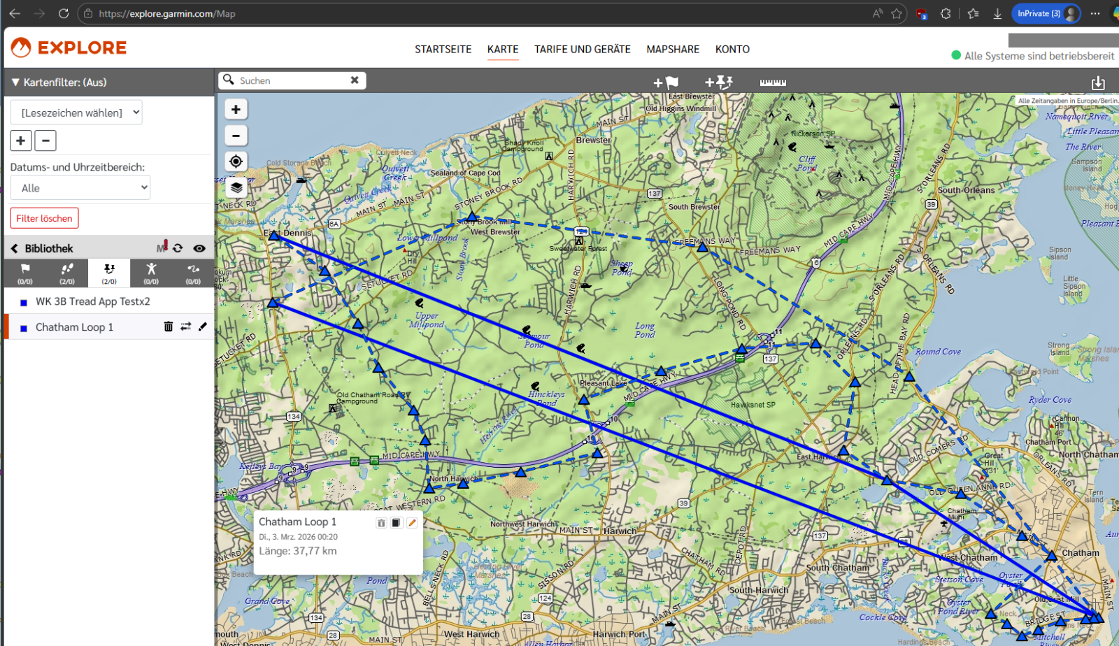

There is that invisible step in synching - everything gets sent to the Explore.garmin.com Explore database. That gets the updated data from the XT2, processes it and sends it back to the Xt2 via a different 'channel' in the app.proofresistant wrote: Mon Mar 02, 2026 10:42 am My example was only meant to show that I personally suspect that the problem is not the synchronization with the Explore DB itself![]()
As mentioned, I think it's the interaction between zumo xt2 (or Tread 2) and the Tread app![]()
I think that it goes: XT2 route -> App on phone -> Explore database and software -> Phone data channel (via the Tread app) -> XT2 route.

Re the 10 shaping points between stops issue, I think I may have found something. It also happens (I get the pop up message) on my version if I try to edit an already imported and fully built route on Tread. However, I tried to disprove it by building a quick route on Tread and editing it. It accepted way more than 10 extra shaping points between my ‘stops’. So, I don’t know if it’s bogus.

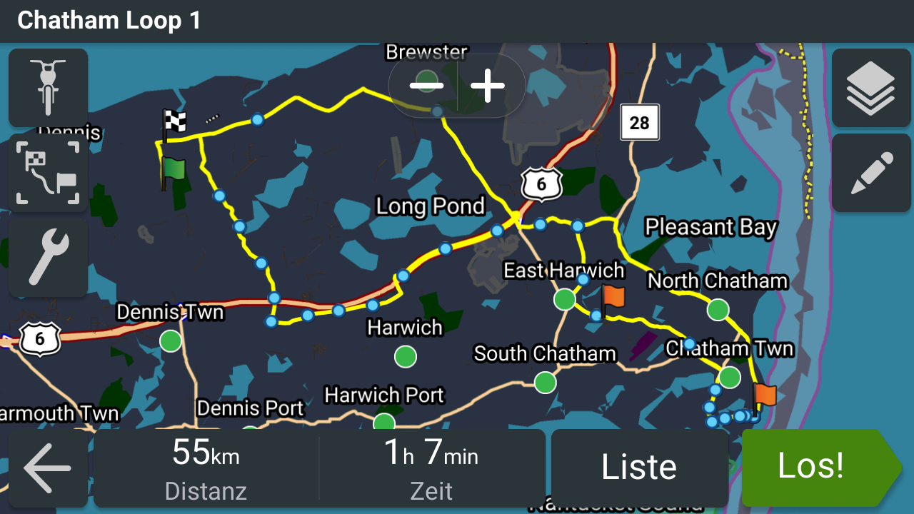

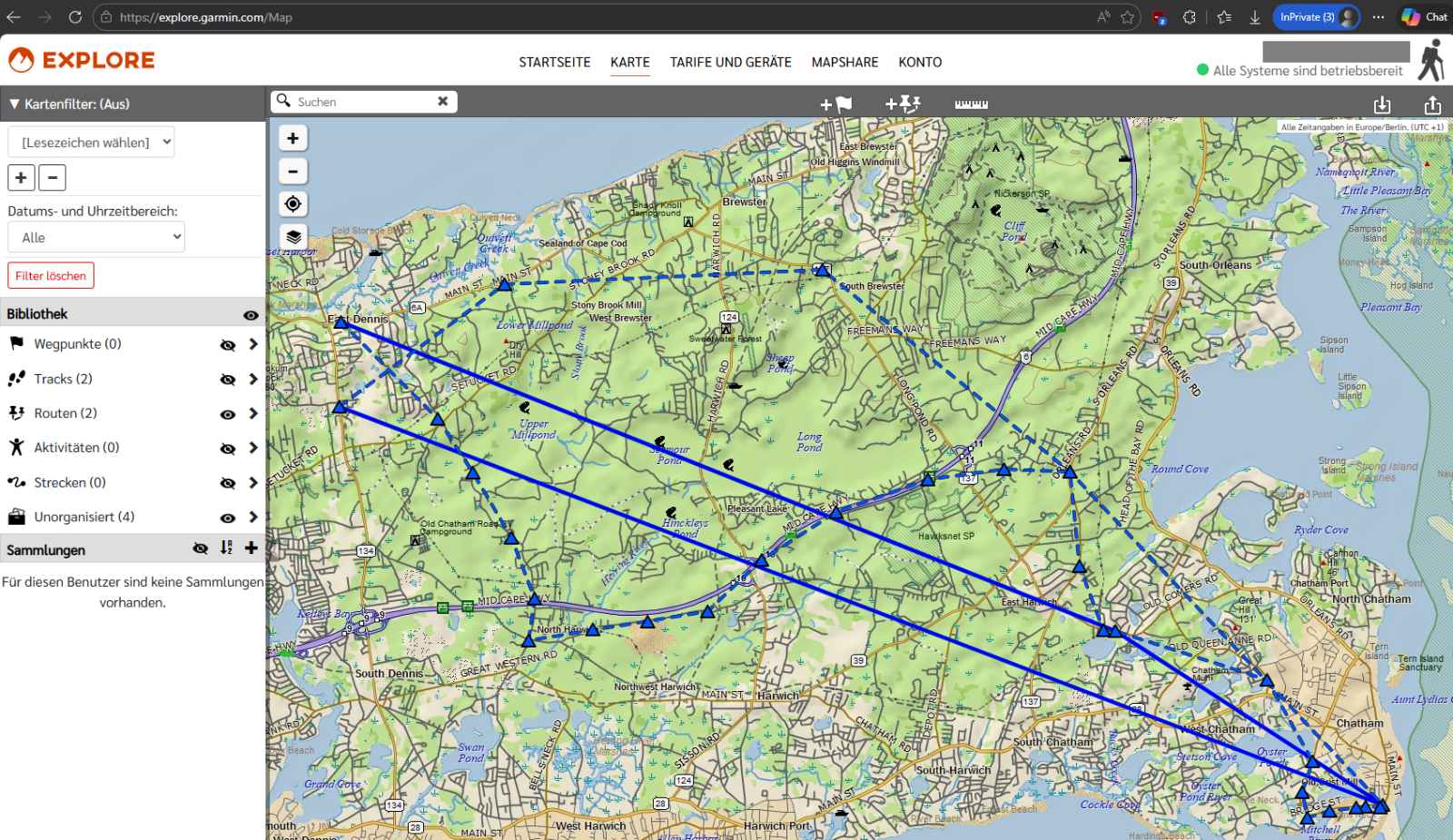

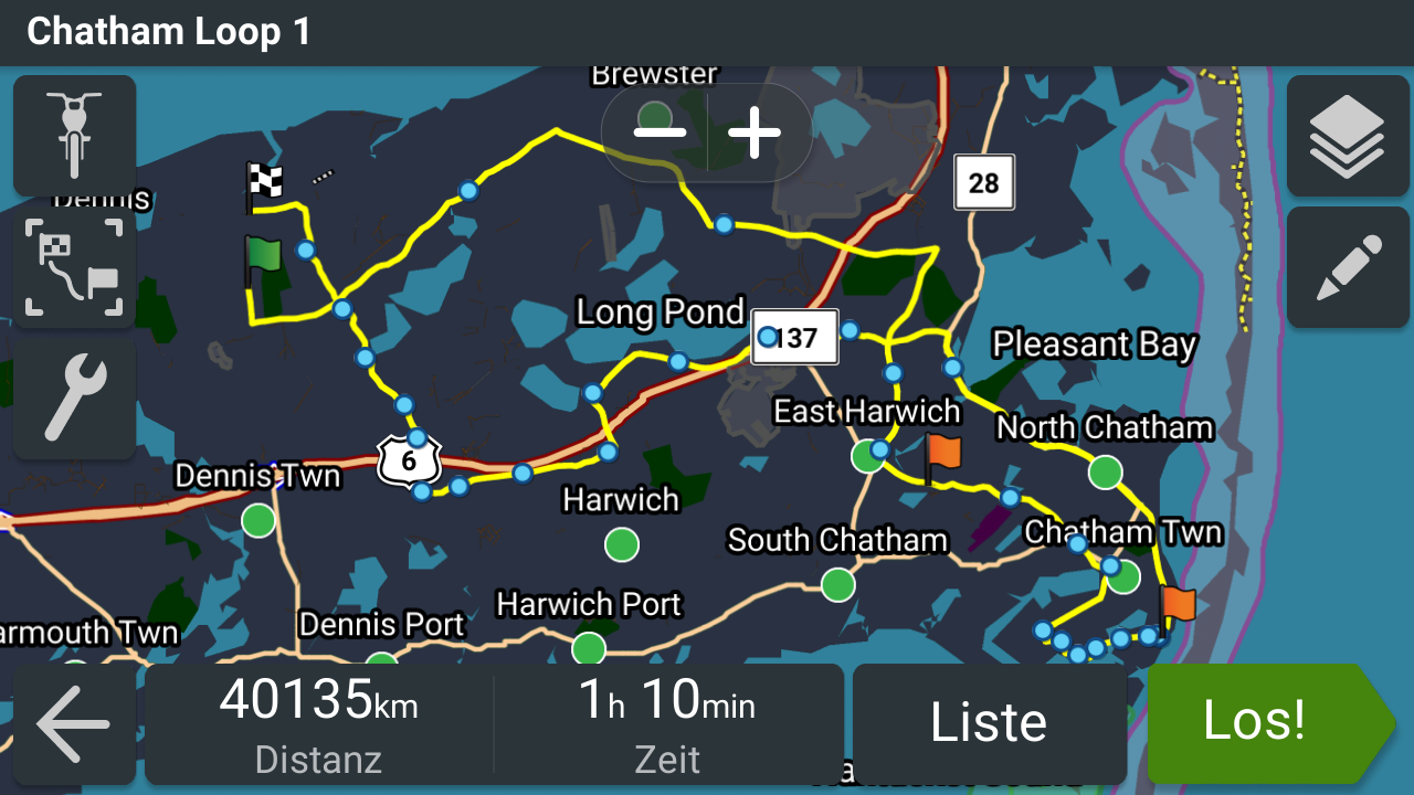

Just i tested also. With map City Navigator North America NT 2027.1, Tread App version 3.00.06 and Tread 2 (edit: i tested Tread 2 not zumo XT2 firmware 6.40. )
I have never seen such serious differences before.
OK, you had already described it, but when you see the reality live, you quickly get a different picture.
Anyway, here are my results step by step.
- 1 BC source
- 2 Tread 2 Imported (edit: i tested Tread 2 not zumo XT2)
- 3 Explore Cloude arrived an track created
- 4 Tread App arrived (and soon changed?)
- 5 Explore Cloude Resynchronized
- 6 Tread 2 Resynchronized (edit: i tested Tread 2 not zumo XT2)
@smfollen
Where do you think the error is in your example, between Explore Cloud and Tread App?
As you already suspected?
Or is there something else unexpected?
- ChathamLoopOriginal 2 XT2 Imp s4.png (463.1 KiB) Viewed 485 times
- ChathamLoopOriginal 6 XT2 ReSync s2.png (450.85 KiB) Viewed 485 times
