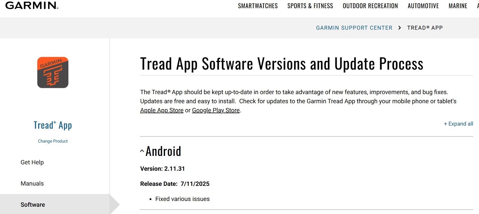

New Tread App version for Android:
2.11.31 (7/11/2025)
