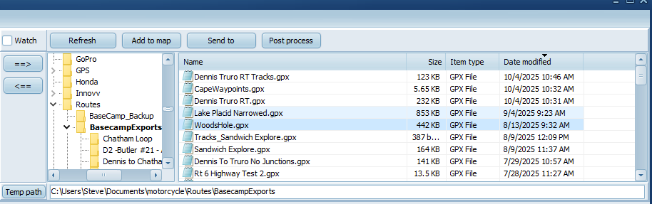

Yes once you finish planning your route in Basecamp, export to whatever folder you like - I have one called BasecampExports - then In TM, navigate to that folder and select the GPX file you just exported. Like this

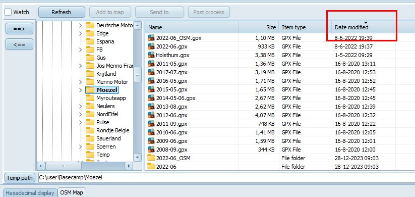

Both BaseCamp and TripManager remember the last used folder (or Directory) name. So it's a one-time job to get it right.
Tip: You can click on the column heading of 'Date Modified' to sort. Click again to sort ascending/descending. That way the oldest/newest files are on top. The small black triangle indicates what column is sorted on.
And that setting is also remembered.
Frank

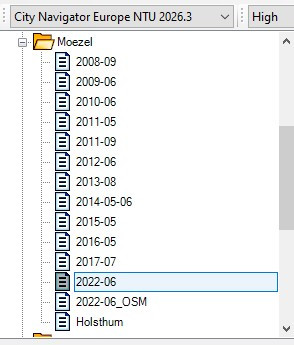

Re: Introducing TripManager
FrankB wrote: Wed Dec 03, 2025 10:29 pm Tip: You can click on the column heading of 'Date Modified' to sort. Click again to sort ascending/descending. That way the oldest/newest files are on top. The small black triangle indicates what column is sorted on.
This facsinates me because the screenshot shows .gpx filenames in what appears to be the form of YYYY-MM.gpx. When I export from BC my filenames default to the route name, list folder name, or waypoint name, depending on what I am exporting. @FrankB, do you intentionally name them this way?
@Peobody
I dont change the name when exporting from Basecamp. Those are the names of the 'lists' in BC.
You may wonder: How does that look on the XT? Aren't there a lot of duplicates?
Answer: I clean my XT before loading new trips.
