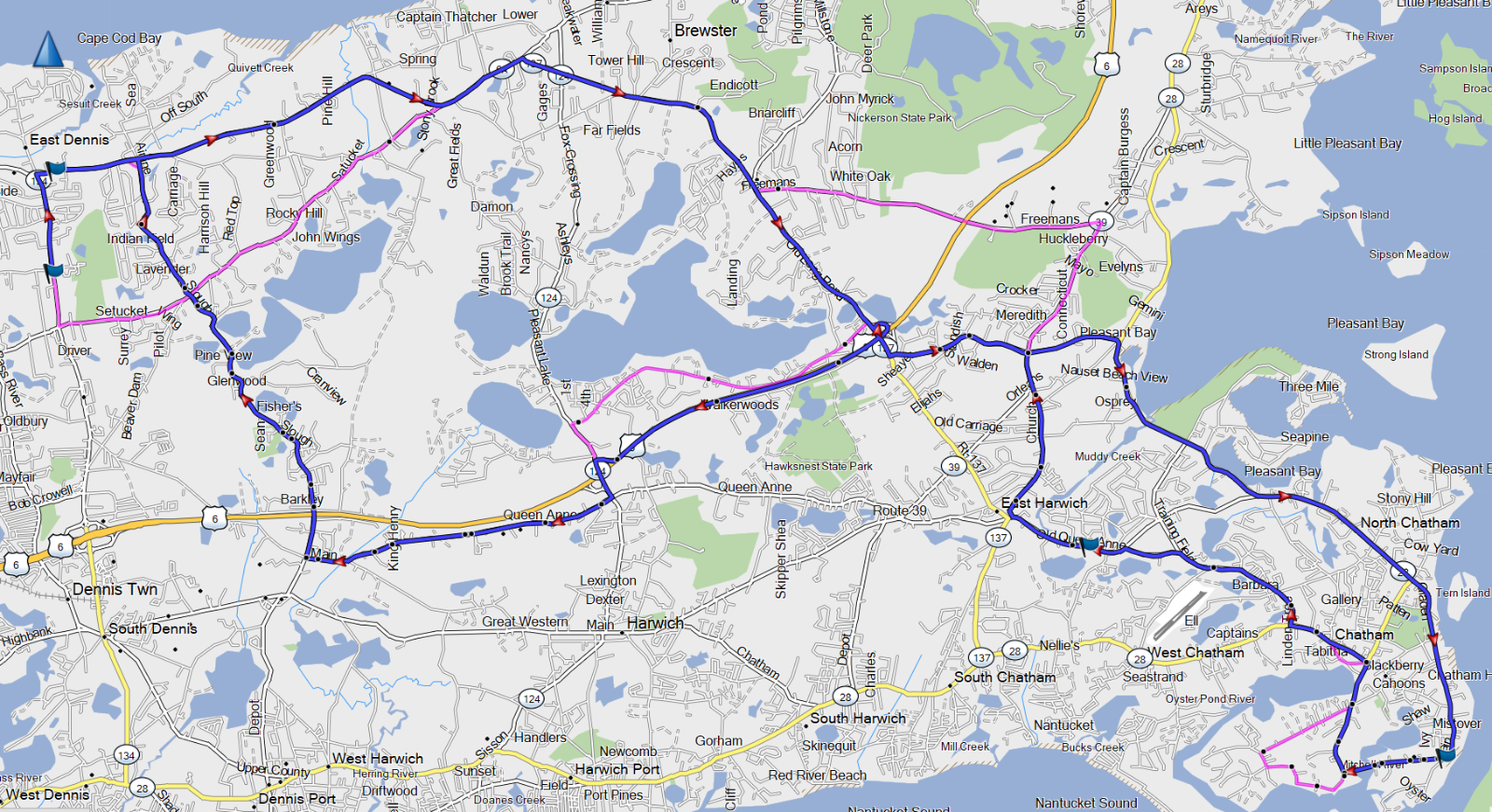

Given all the recent posts on this subject, I decided to retest the issue originally reported here with current updates.
Bottom line, over the last 18 months, Garmin has made zero progress in addressing the issue.
I updated my XT2 to current firmware (6.40), updated to the most current maps and reset the XT2 (Settings->Device->Reset->Delete Data and Reset Settings).
I also removed the XT2 Bluetooth connection from my phone, then installed the latest version of the Tread App (3.00.06).
When reconnecting everything, the option to "Enable [cloud] Storage" was presented. I initially did not chose that.
On my PC, I deleted everything from my sd card, then copied the route from my original post here to the sd card and imported it to the XT2. All was well as expected.
I was unable to perform any kind of sync until I "Enabled Storage".
Once I enabled storage, a sync occurred automatically and the route changed significantly. Below, the original route is magenta, the route after sync is blue.
ChathamLoopBeforeAfterSyncMarch 2026.png (1.48 MiB) Viewed 572 times
This is the exact same result as the one in August of 2024 - see the original post in this thread for details if interested.
I wonder if anyone with an XT3 can reproduce this. Maybe the XT3 includes different algorithms.

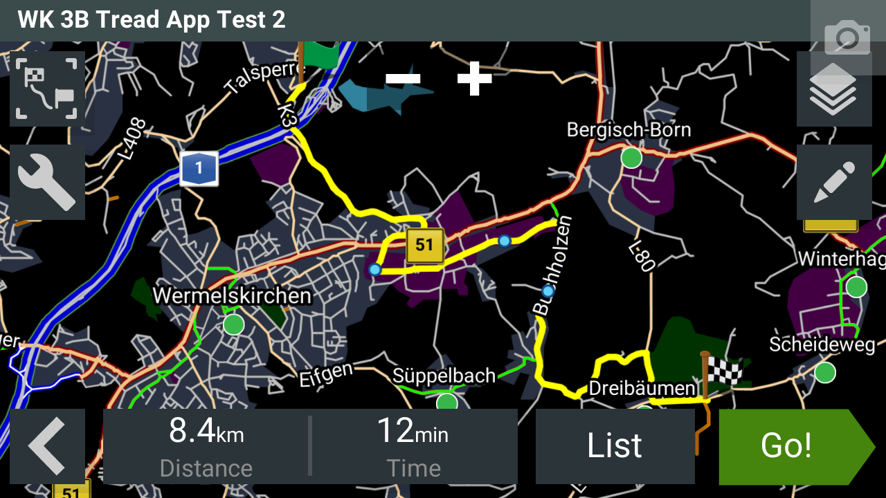

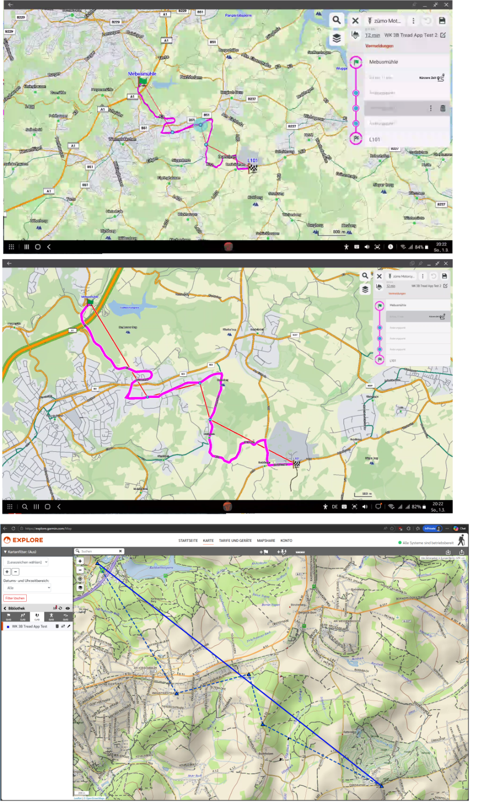

Here are also the screenshots ;-)
WK 3B Tread App Test TA-Explore.png (2.4 MiB) Viewed 548 times
WK 3B Tread App Test zumo XT2 device.png (651.58 KiB) Viewed 548 times
And here in zumo XT2 image with red dots where the shapings of the Tread app were set.
WK 3B Tread App Test zumo XT2 device cpmpare.png (650.19 KiB) Viewed 547 times
