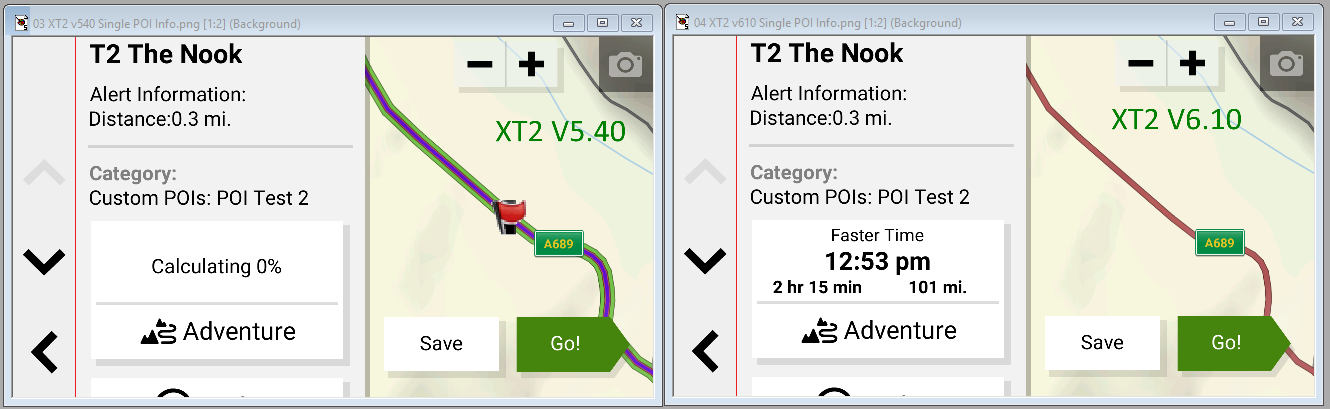

Custom POIs:
I sent in a complaint yesterday with some screen shots of how it used to behave with v5.40 and how it behaves now with v6.10 software.
I'ts not just on the map that icons don't appear. If you select Where To->Categories->Custom POIs and then choose one of your POIs it gives the details of the POI and it should show the icon. It does with v5.40 software. It doesn't with v6.10 software
Here showing the same Custom POI on the informtion screen. Software v5.40 on the left, v 6.10 on the right.
When navigating the XT2 pings twice and the banner shows the name. The icon shows on v5.40 but not on v6.10.

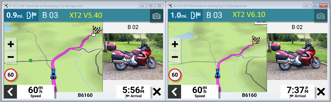

And here Showing a TourGuide POI information screen. v5.40 software on left, v6.10 software on right
This screen shot is taken when navigating (simulation). The mp3 sound clip is played and the picture is shown on the screen - for both versions of the software. But only v5.40 shows the icons on the map. Note that there is a green icon (B02), and another white icon (B03) - located at the end of my test route - is also showing another location in the tour guide.
