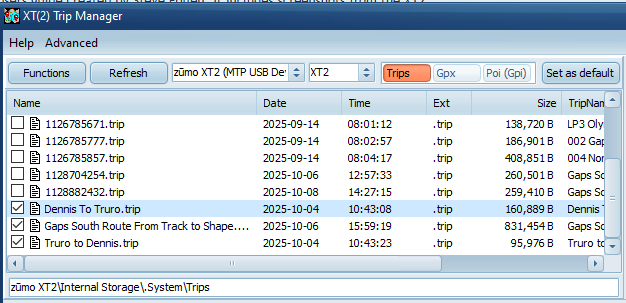

@giuseppe66 Look at the list of trips in the upper left of the Trip Manager Window.
If the box at left is checked, RUT is fixed.
If the box is not checked, you can check it right there, which will fix RUT. If you use Trip Manger's "Send to" button to send your gpx files to the zumo, as .trip files, RUT will be fixed automatically and the checkbox will be checked.

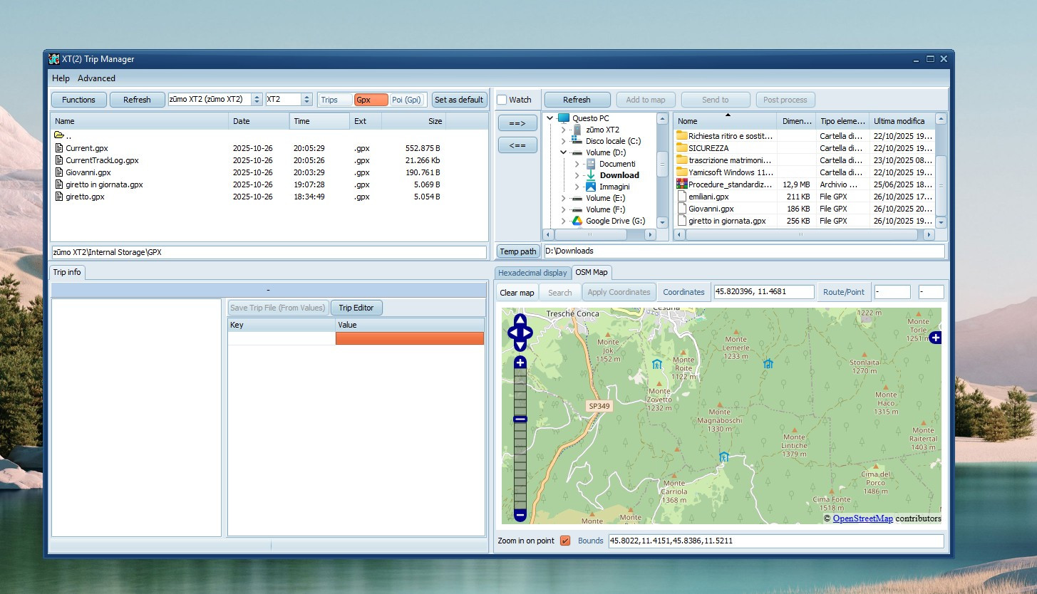

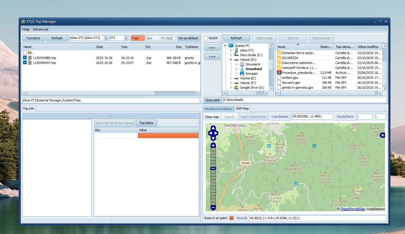

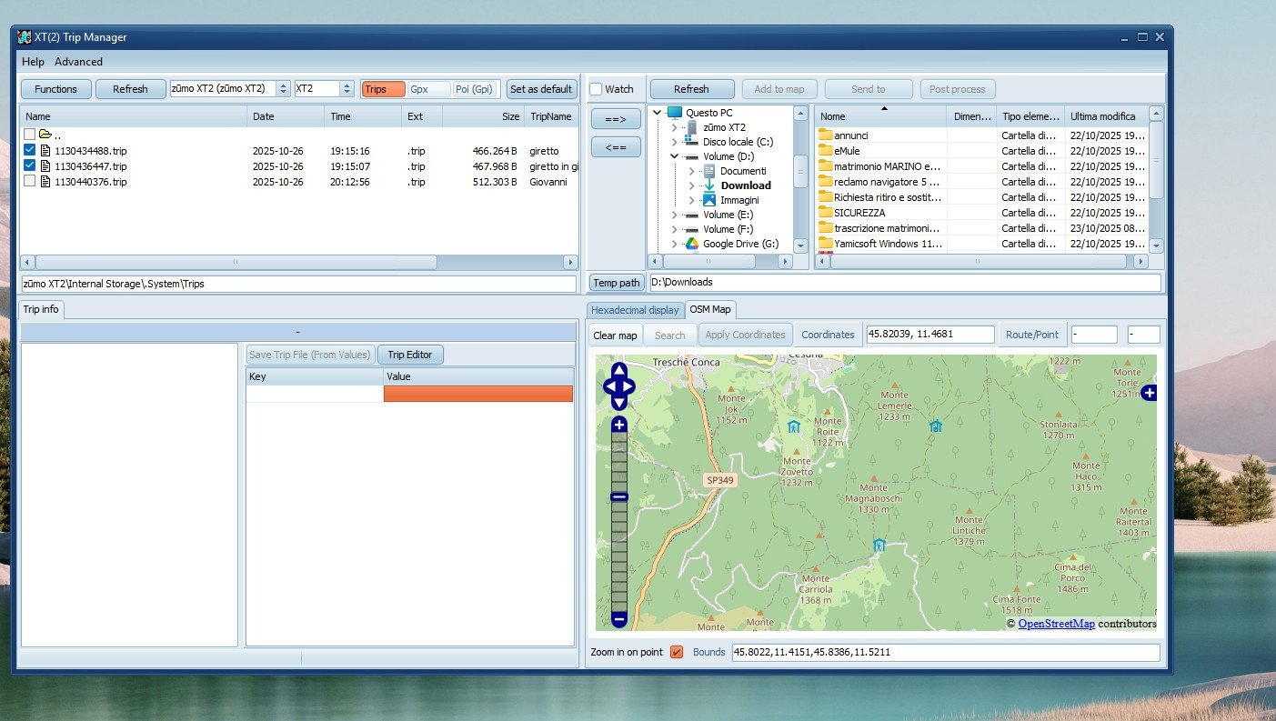

I have another question.
1) I generate the GPX file with My Route with export in 1.1.
2) I see it in the right window of TRIPMANAGER (for example, file name GIOVANNI.GPX).
3) I send it to the Zumo and it appears on the left in the GPX section, but I still don't see it in the TRIPS section.
4) I restart the Zumo and after importing the GIOVANNI.GPX file, I have to import it and then I see it in the TRIPS section.
5) The GIOVANNI.TRIP file is not checked.
Question: Is the RUT function active even if the GIOVANNI.TRIP file is not checked, or do I have to manually check the file?

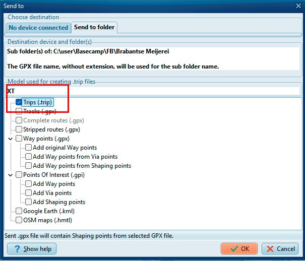

@giuseppe66
I think you have to click on 'Send To' and in the dialog that opens select the option 'Trips'.
In the PDF it is 'method 5'.

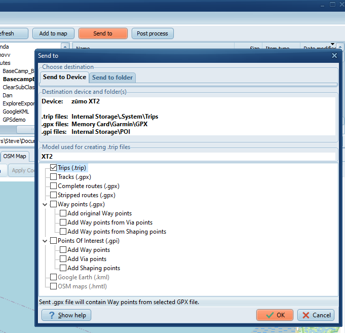

Re: Introducing TripManager
@giuseppe66 If you use the arrow button in Trip Manager
that simply copies the gpx file to the zumo, just like if you transferred the file using Windows explorer or an sd card. It is purely a file copy.
In that case, once copied to the zumo, you have to import the route. A .trip file is created by the zumo during import and the route is marked as imported in that .trip file. The check box can be used to change the flag in the .trip file from imported to saved, which fixes RUT.
The easier way is to use Trip Manager's "Sent to" button, select the "Sent to Device" tab and then check the box to create "Trips (.trip)" In that case, Trip Manager will create a .trip file and send it to the connected zumo. No further import is needed. The trip is automatically set to saved, which fixes RUT.
.trip files need to go into "zūmo XT2\Internal Storage\.System\Trips". Trip Manager should be configured that way by default.
