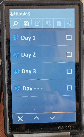

"When I do locate Collections it is found by selecting “Route Planner”, then clicking on the stacked squares in the top right hand corner, then I see Collections..
I can then see the various .gpx files - Day 1, Day 2 etc…with a box that I can put a tick mark in to select that file..but I cannot find a way to do anything with that route.."

I still can’t figure out how to load 1 .gpx file at a time into the GPS so that I can follow the created route. I can find the route in Collections, and I can select one, but I cannot load it.

Well….That’s odd. I created a route…Winnipeg - Thunder Bay and saved it in “Saved”..but now I cannot locate the “Saved” folder/location…The File is in “Collections” though..
