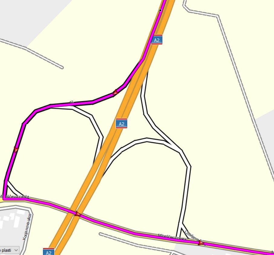

Planned route created in BC and saved in GPX on local disk.
Premmik BC.JPG (68.58 KiB) Viewed 458 times
Using TripManager GPX transferred to SD in XT3. After import and calculation in XT3, shape points on AC are moved to the oncoming lane...
I haven't noticed these shifts on local roads.

One thought @raza Do you have route points at intersections? For example, a point at the intersection of the highway on-ramp and the road crossing the A2? Basecamp may take the point as on the road and the zumo may take it as on the ramp which leads to the A2. It is best to avoid placing points at intersections.
Also the zumo takes the "faster time" routing preference to mean faster roads so it tends to route onto the nearby A2, even if it takes longer.

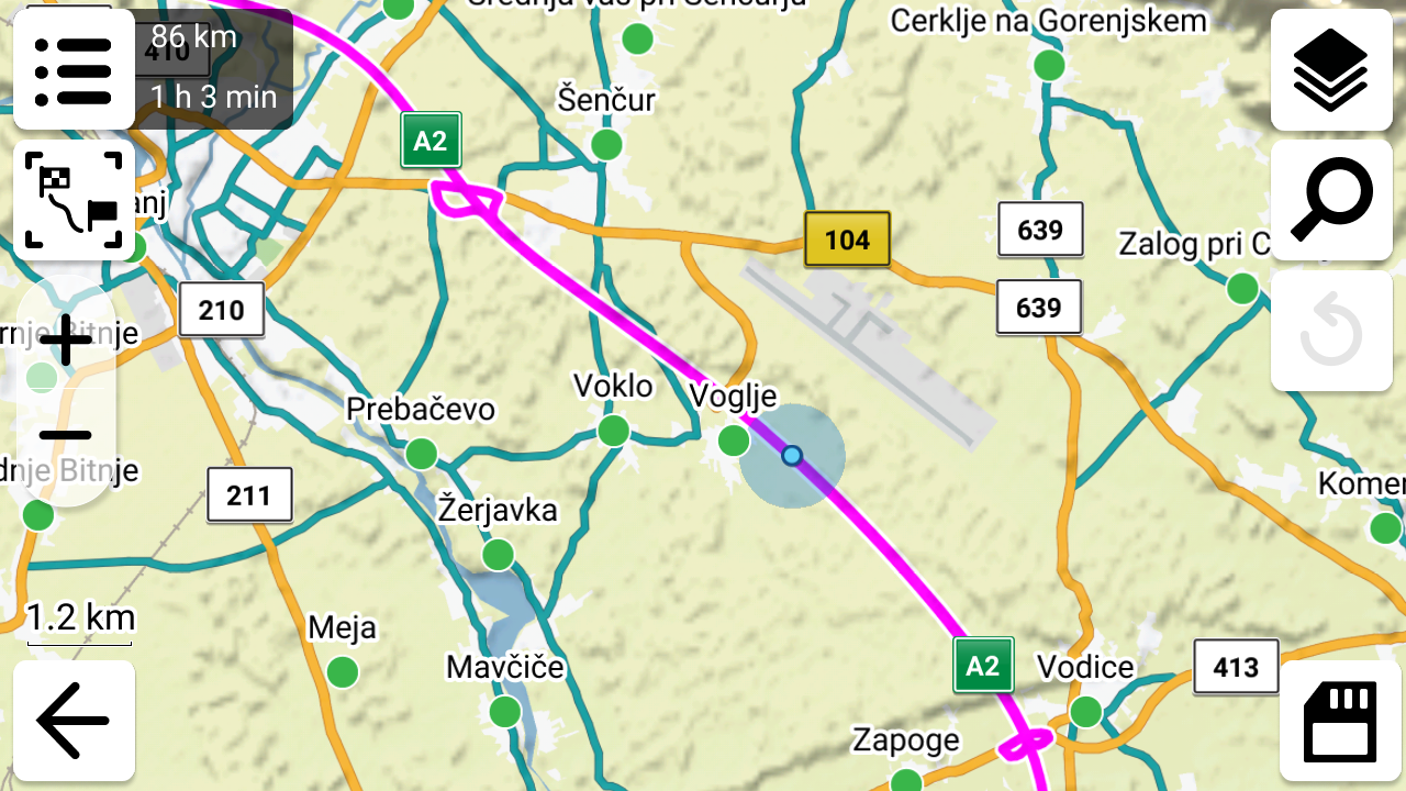

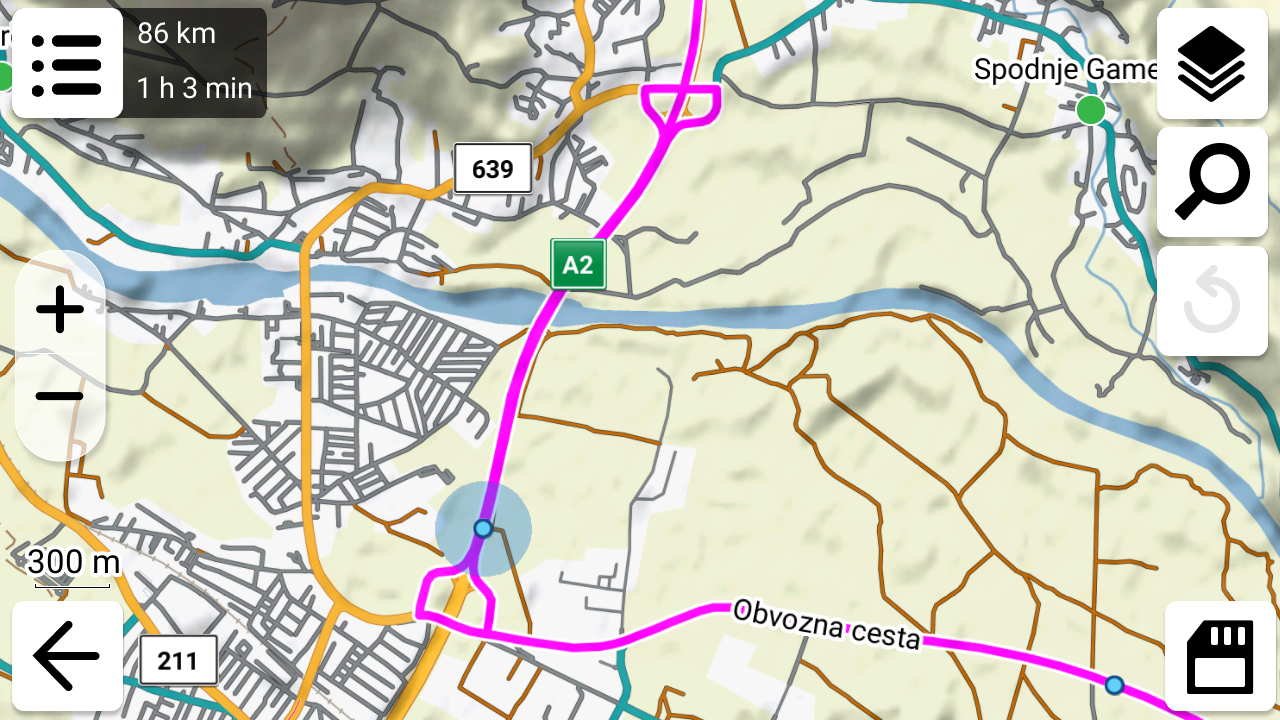

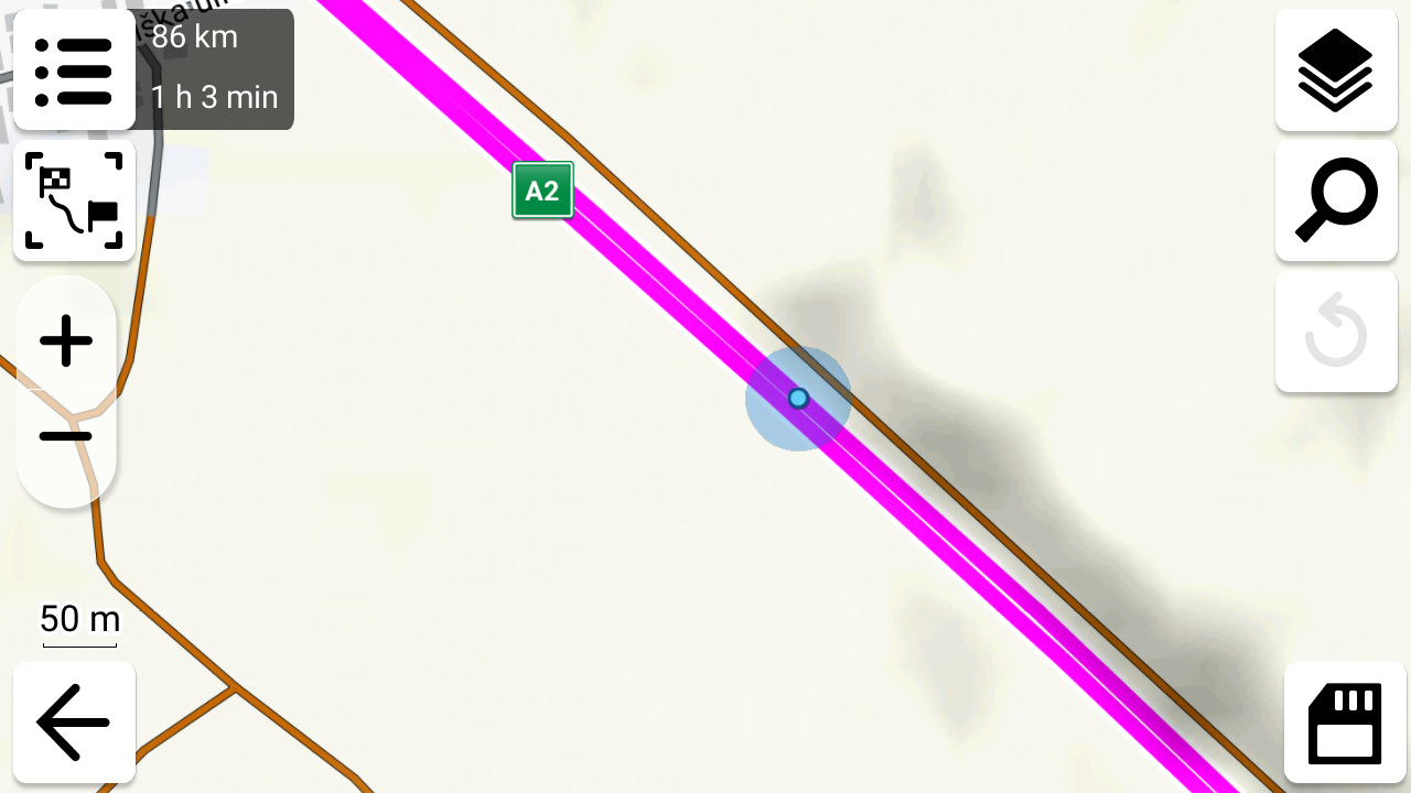

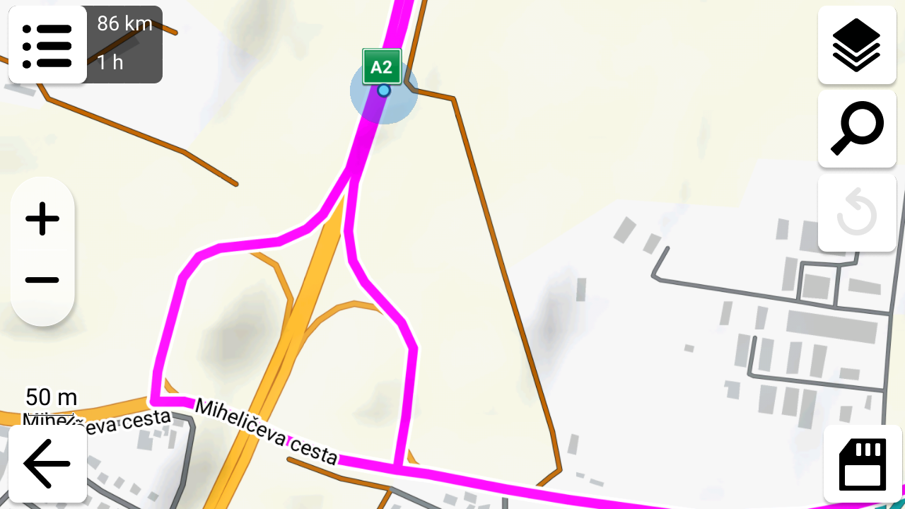

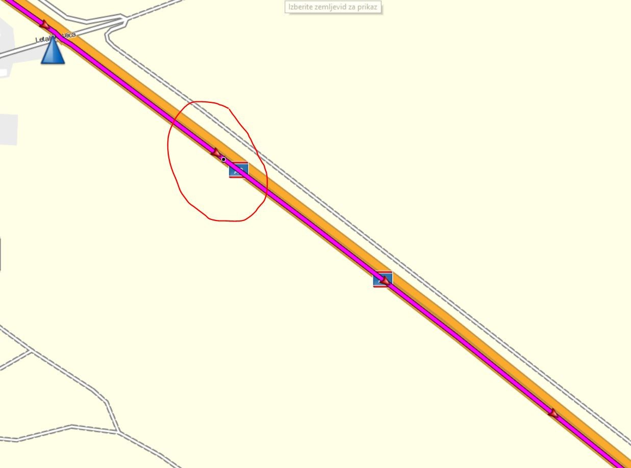

The intersection has no connection for moving points. Another design point has been placed on this AC, which has branches quite far away. The point is moved parallel to the opposite lane of the AC.
BC:
XT:
