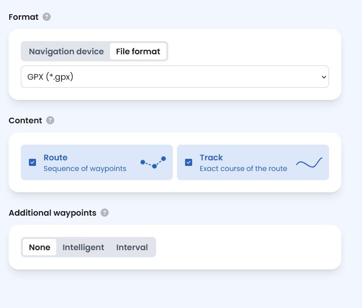

FrankB wrote: Tue Jan 13, 2026 3:57 pm I would recommend to tick the checkbox to include the track, so you can show that on the map.
To have additional shaping points, set Additional waypoints to Interval.
I did not include the track but my first export included additional waypoints set to Interval. BC errored on import attempt.

Peobody wrote: Tue Jan 13, 2026 4:32 pm I did not include the track but my first export included additional waypoints set to Interval. BC errored on import attempt.
Choose "File Format", not "Navigation Device"
Set the type to *.GPX

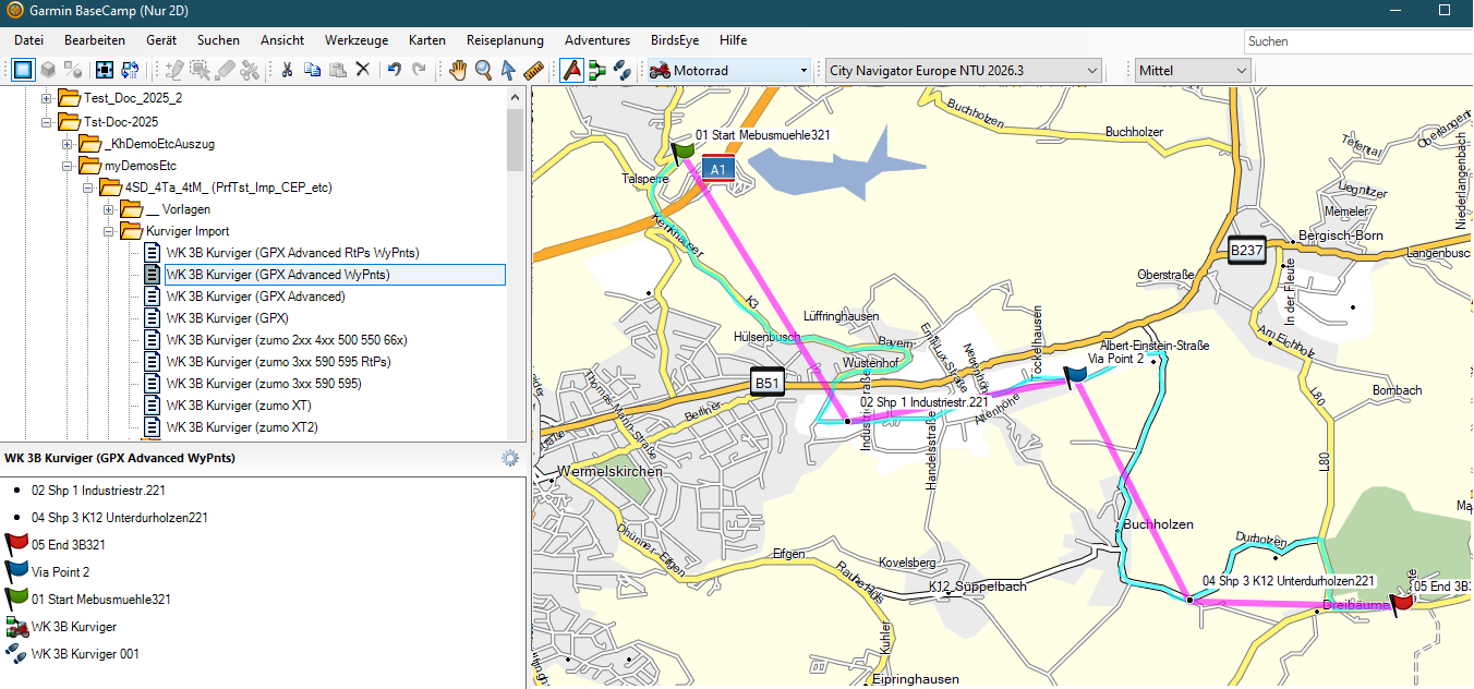

I choosed "File Format" but i set type to GPX Advanced, with Waypoints
Route will imports in BC also, looks like:
GPX Advanced Way points.png (411.03 KiB) Viewed 291 times
Then was AventurousLevel not included also.

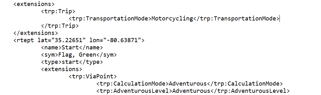

FWIW, the two of mine (exported as device=XT) that would not import into BC contained this:
