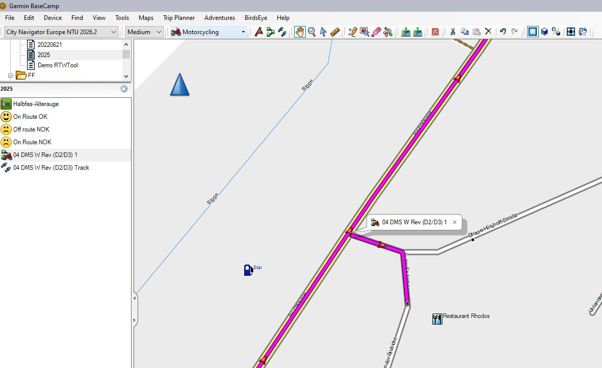

Before you spend a lot of time, please check all your via/shaping points for something like this.
This misplaced Shaping point was the cause for a CEP going terribly wrong.

@smfollen
This was the post back then. viewtopic.php?p=5794&hilit=glitch#p5794

What exactly is wrong with this shaping point?FrankB wrote: Thu Jul 24, 2025 8:56 pm This was the post back then. viewtopic.php?p=5794&hilit=glitch#p5794
From my point of view, a well-functioning CEP should be able to handle this.
You know there is a pizzeria on the way, you just want to drive past it, but if you are hungry and it is open, you stop there for a break.
The route tracker knows this too, and everything is OK during the check before the trip.
Then you need the CEP function and that's exactly when you get a problem?
Sorry, but this kind of software behavior is not acceptable, and it's certainly not a route planning error on the part of the user.
Re: Looking for the best start option to begin a planned route.
Well. In the 1st place I did not meant it to be there, it should have been place at the main road. Bruchstrasse. My fault I did not pay attention.
2nd When driving you need to turn right, make u-turn, turn right again, just to be on the same road.
3rd When starting the route from my current position with CEP it skipped nearly all shaping points and wanted me to take the Autobahn.
4th If the Shaping point is moved to the Bruchstrasse all is well.
Besides I dont like Pizza!
Agree 100%. But that's how it works. Just wanted to warn you about this behaviour.proofresistant wrote: Fri Jul 25, 2025 12:07 am Sorry, but this kind of software behavior is not acceptable, and it's certainly not a route planning error on the part of the user.
In the original post there is a zip file with a GPX, and a few Waypoint from where the CEP was started (in simulator mode) I recently was able to reproduce the same problem, but now on the latest Firmware of the XT and the latest maps.

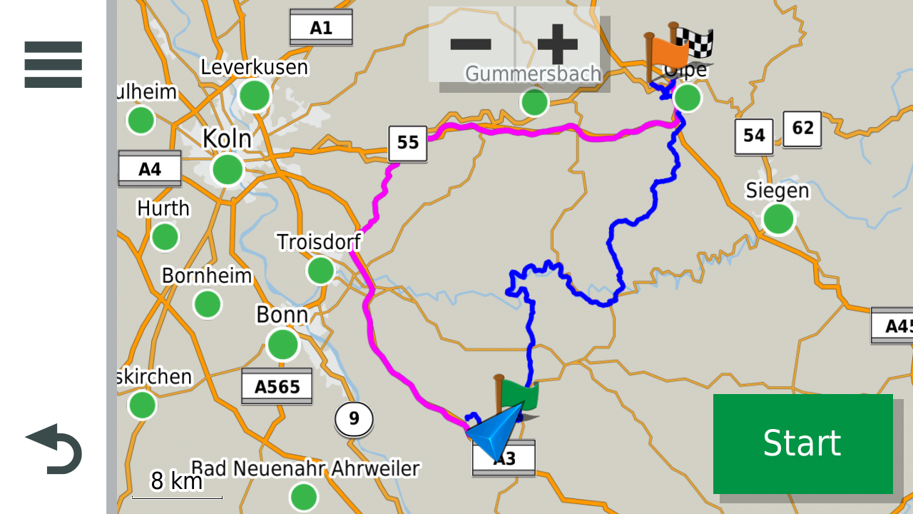

OK, as @jfheath and @FrankB have written, the cause of (my) CEP problem is the handling of shaping points and resulting U-turns.
If you have U-turns in your planned route as a result of shaping points, whether planned or unexpected, CEP may not work properly and may discard some or all of the shaping points up to the next VIA point.
It gets confusing because my CEP Issue doesn't always happen in the same way.
I observed the following three behaviours when observing the CEP issue:
What I have found out with relative certainty:
Best workaround from my current experience:
- CEP works perfectly with some uncalculated imported routes at first, until you recalculate them.
And then after recalculation, CEP only causes problems.
- CEP does not work at all with some uncalculated imported routes at first.
And after you recalculate them, CEP no longer causes any problems.
- CEP does not work at all with some uncalculated imported routes.
How ever you recalculate them or not, CEP problem stay.
- CEP can find the best entry point between via or shaping points or the track in between.
(This refers to the whole drawn route line, no matter if you call the individual points of the route track ghost points or not
- The import flag has no significance.
- The source of the route has no significance.
(Perhaps those created in the XT2 or Tread app work better, i have not test thoseyet)
- The position and, above all, the viewing direction have no significance.
- CEP always works very well for the next VIA point.
- CEP some times does not work for the next shaping points.
- I currently expect issues when shaping points result in U-turns.
- With my new experience, I also think that shaping points placed at ‘critical’ road intersections can be a problem.
- Recalculation can improve it, but unfortunately not always.
- The route planning preference ‘shorter distance’ brings you slightly closer to the next entry point.
- Copy the route so as not to damage the original.
- Just try recalculating the route first.
Sometimes that alone is enough to solve the problem.
(For example, that was enough for my XT2, so that CEP then also worked with the problematic route shared by @FrankB )
- If recalculating alone did not help, then I have three possible solutions.
- Solution 1
Switch/change a shaping point into a via point (or adjust the position of the shaping point)- Solution 1.1 You still have the critical shaping point ahead of your journey.:
- 1.1.1: It is best to find the critical shaping point for the U-turn (or even be critical at road intersections also) and change it to a via point.
- 1.1.2: Find the first shaping point that will appear on your route and change this Shaping Point to a Via Point.
(It doesn't really matter which shaping point becomes the via point, as long as it is not located after the U-turn (or even be critical at road intersections also) problem point.)
(Note: I have also like @jfheath observed here that shaping points are extremely manipulated, sometimes even disappearing, when you convert via points (bak) to shaping points in a route using the zumo XT2 device.)
- 1.1.3: (adjust the position of the critical shaping point for U-turns (perhaps on your PC), but this is probably rather difficult during the tour
- Solution 1.2 You have already passed the critical shaping point during your journey.:
I recently recognised this case and unfortunately have not yet found a good solution.- 1.2.1: It is best to find the critical shaping point for the U-turn and change it to a via point.
Now I think you will be forced to find the critical shaping point and it is probably necessary to change this shaping into a via point (if its position is not to be optimized).- 1.2.1.2: Find the first shaping point that will appear on your route and change this Shaping Point to a Via Point also.
- 1.2.2: (adjust the position of the critical shaping point for U-turns (perhaps on your PC), but this is probably rather difficult during the tour
Edit: The shaping points on the route before my current position do not appear to be of significant importance.
- Solution 2:
Change the routing profile for U-turns and recalculate the route.
(Note: As I have observed, the XT2 may behave differently from the XT (1).. Currently i cannot see any noticeable effect when I try out @jfheath's tip.
- Solution 2 for a zumo XT2, avoid U-turns [X] mark this checkbox as marked in the Routing Avoidance menu.
(Please note that with this solution, which I do not consider optimal, you will never reach the shaping point that may have been specifically planned.)
I probably need to revise my assumption for ‘solution 2 for a zumo XT2’ because I can no longer reproduce it with positive results. So now I think that allowing or avoiding U-turns has no effect.
- Solution 2 for a zumo XT (1) (Suggested like quote @jfheath), allow U-turns [_] unmark this checkbox as unmarked in the Routing Avoidance menu.
- Solution 3:
Try to create a new route from the origin track, which you hopefully have as a backup.
But then don't navigate to CEP, navigate to the end of the route.
