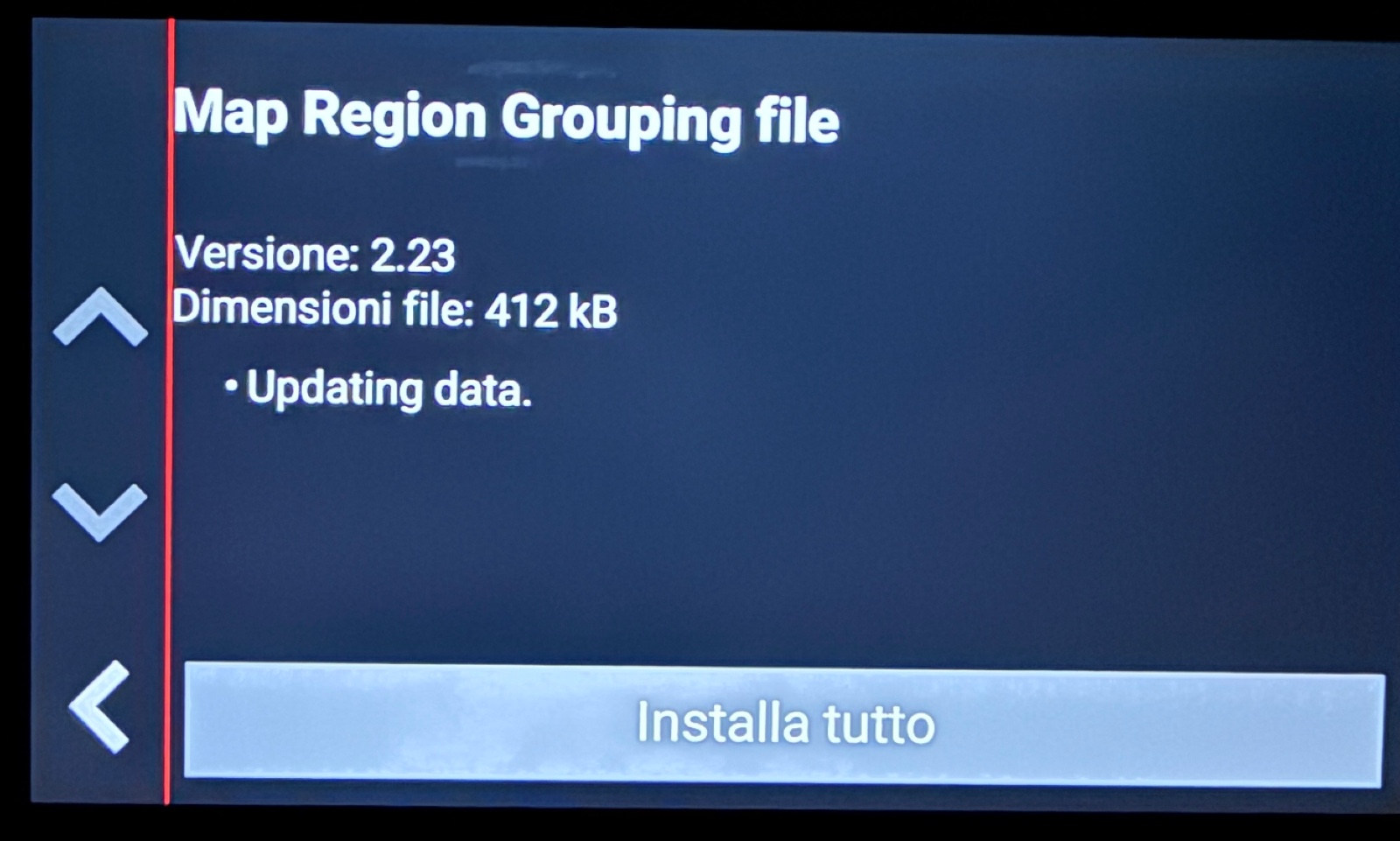

I just got this update
Update
Update
Re: Software 6.10
Gelo wrote: Fri Sep 26, 2025 8:44 pm Hello,
Today, 26/09, I received a software update, but the XT2 is still running version 6.10.
Does anyone know what this is about and if it includes any new features? :roll: :roll:
They alert that there is software update when it is something like data files - eg Cyclops. The system software remains the same.
