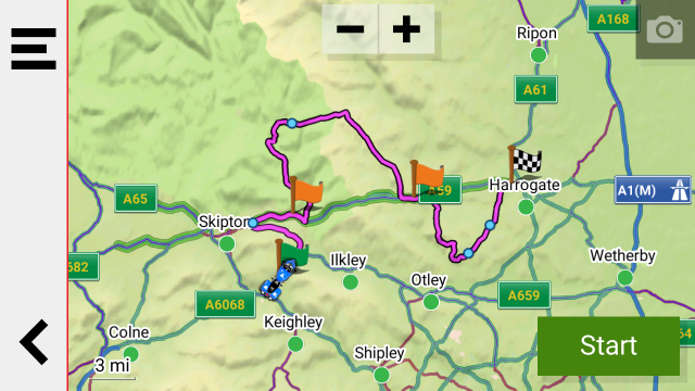

So with a freshly reset Zumo XT2, I thought that I had better verify this before I typed it up.
So here is a route that I created in Basecamp. It has no Waypoints, but has 7 route points :-
4 Via Points including the start and the end point
4 Shaping points all positioned deliberately to make the route longer.
I made a track of the route and sent this the the XT2, and set it to black. You can see the black track peeping out from the edge of the magenta route. There has been no change to the route.
What I did and what the Zumo did to get the route started was as follows.
Apps -> Routes -> 3-dot menu -> Import -and I chose to Import the route and the Track from the gpx file.
I was offered the opportunity to put these into a collection - so I created a collection called 'Original' and selected that. I set the clolour of the track to be black and made that collection visible and no other collections were visible (no other collection existed at this point).
The Zumo did not calculate anything on import. It usually says 'Calculating' - but don't be fooled by that - It doesn't meant that it is caclualting the route. Not necessarily anyway. It usually means that it is doing other stuff - like creating the trip file or stripping out waypoints and tracks from the gpx file. But my routes were placed ont eh SD card, and it doesn't automatically import. Nither does it strip out information from the GPX file if the gpx file is placed on the SD card.
I selected the route, and after a very short delay, the map showing the route was displayed on the screen. That is the picture above.

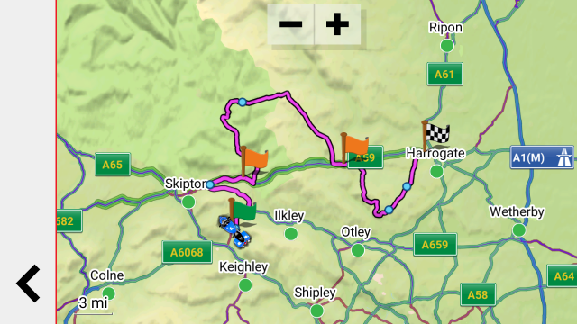

Then I slected 'Go!' and chose my first route point in response to the prompt to 'Select Next Destination'.
A messgae came up saying 'Calculating'. 0% stayed ont he screen for about 5 seconds and the map reappeared - this time with a start button. No changes were made to the route.
Now - just based on that test, I cannot definitley say that the route has not been recalculated. If it had been recacluated, then the route points are in such a position that ti would be difficult to plot any other route.

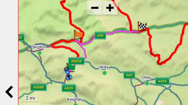

No that is not proof at all. I certainly would not be convinced by it. This is an intitial test to see what happens.

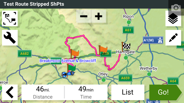

You see Basecamp prepares a GPX file with Waypoints (although I didn't use any), shping points and via points. Shaping points appear ont he Zumo screen and blue discs. Via Points are shown as orange flags. But Basecamp also sends what I call 'ghost points' - they appear in the gpx file with the tag <gpxx:rtept . In this particular 45 mile route there were Just under 1000 of these additional invisible route points. If the ZUmo has these, and other conditions are met, the XT2 does not recalculate the route at all - it just uses what Basecamp has sent it.
BAsecamp has a feature that allows you to delete all of the shaping points fromt he route - leaving just the via points in place. It also leaves the ghost points in place - so in theory, if the route is not recalculated, the route will remain exactly as it is - because the ghost points are there still plotting the planned route. So my second test was to do exactly the same thing - but this time I have selected the option to strip out shaping points.
This time, I made the track red so that I did not confuse the screen shots. You can still see the read outline to the route. Even without the shaping points, the route is plotted where I intended it to go. Therefor it has not been recalculated. If it had - it would certainly not have taken that loop north between the west and east via points on the A59.
So in an attempt to prove that, after setting the route going, I pressed skip, and agreed to select the next route point. That removes the route point from the list and recalculates the entire route. It still uses the remaining route points to do this, but it will probably come up with different roads. Certianly in this case as there are no shaping points.
The result demonstrated that the previous screen shot had not had the route recalculated. The magenta route takes a different route the the first Via (orange flag). It then continues along the A59 to the East. What is a surprise to me is that it has discared the original end point and moved it to where the next via point was. That looks like a programming error to me. It has removed the end via point not the next one.
