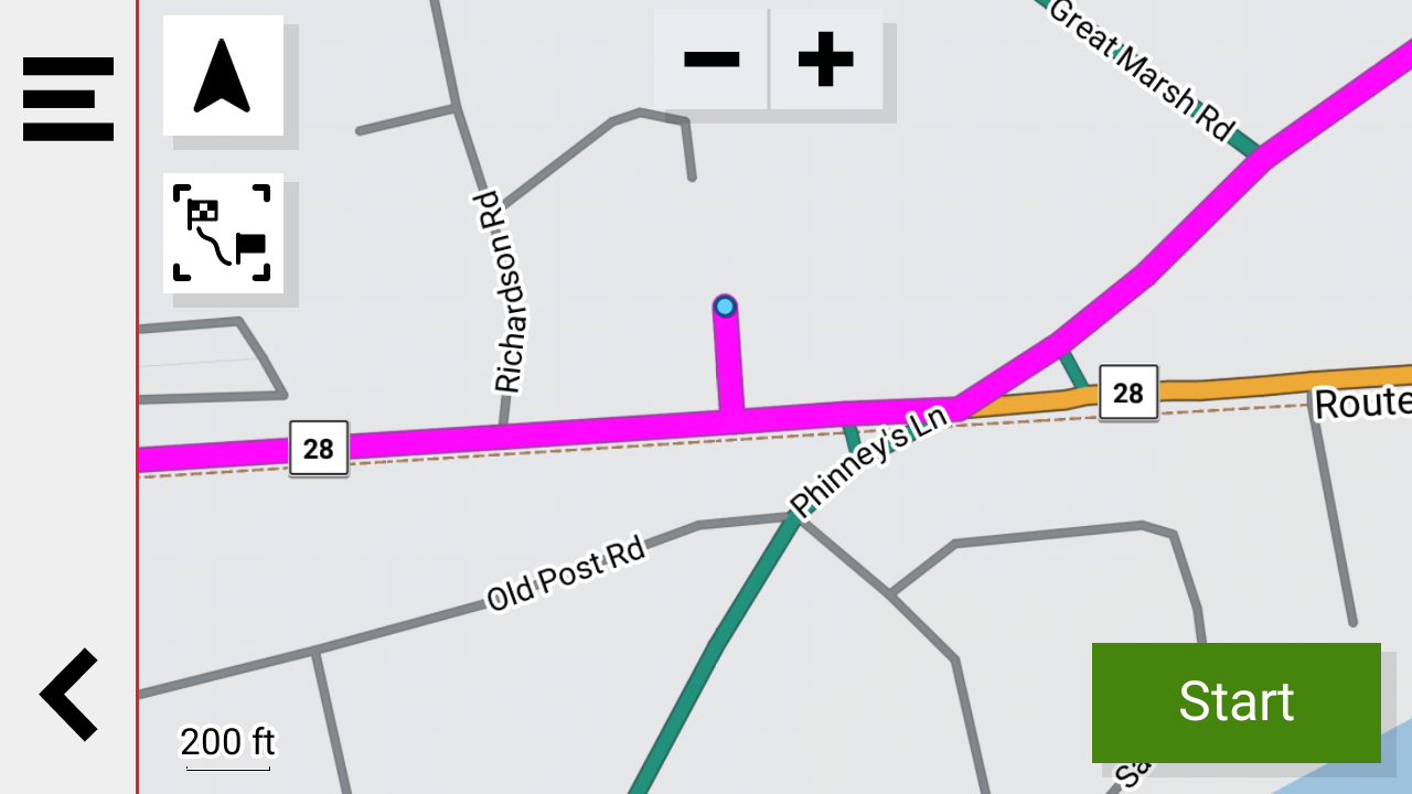

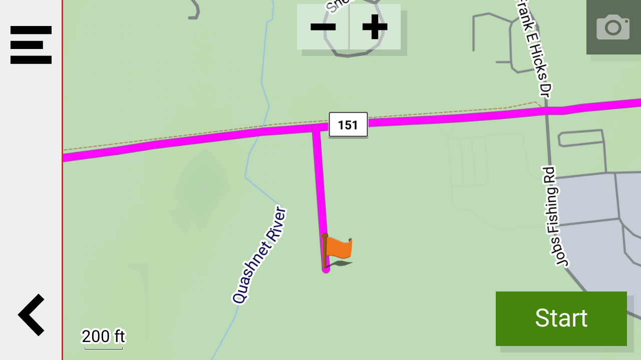

I have no problems with route calculation even when route points are not perfectly on the road.
Here are a couple screen shots showing that. The route was created in Basecamp. It was transferred to my connected XT2 directly from Basecamp by right clicking the route, selecting "send to", then zumo XT2, Memory Card, User Data. After disconnecting and restarting the XT2, I imported the route and selected it.
I also did some route tweaking on the XT2 to force recalculation on the XT (e.g. change from fastest to shortest distance). Still no issue.
In general, I would suggest that it is good practice to zoom in on your route points to make sure they are on the intended road. I have, on occasion, accidently placed points on the wrong nearby road or the wrong side of a highway
