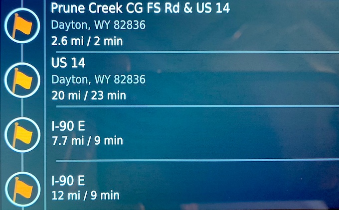

Sometimes - not every time, but more often than not - route point names from imported routes get renamed when they are imported into the XT. It also happens with the 595.
It isn't a big issue as the names are rarely displayed - Buy are displayed when starting a route (Select Next Destination), and if you want to edit a route using the XT screen.
But points that have been created as Waypoints first - ie using the Waypoint 'flag' tool in Basecamp - will never get altered.

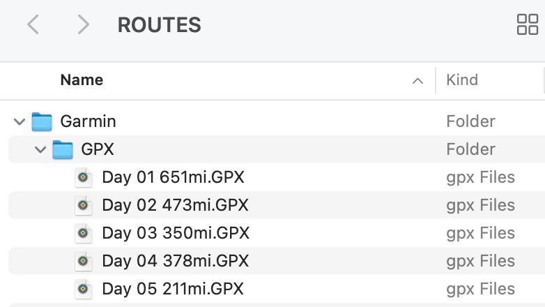

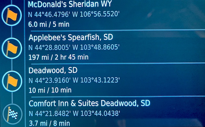

I've also added some screen shots showing how I Export to my Sd card. I always do so on my MacBook Pro. I'd like to add, I alwys reformat my card after taking trips. Thanks again, I sincerely appreciate you and Peobody in taking the time in helping me get this resolved. Ray

I understand what you are saying @PaulaRay, and I appreciate the evidence that you have sent.
But I cannot see anything that confirms that a point has been created as a Waypoint.

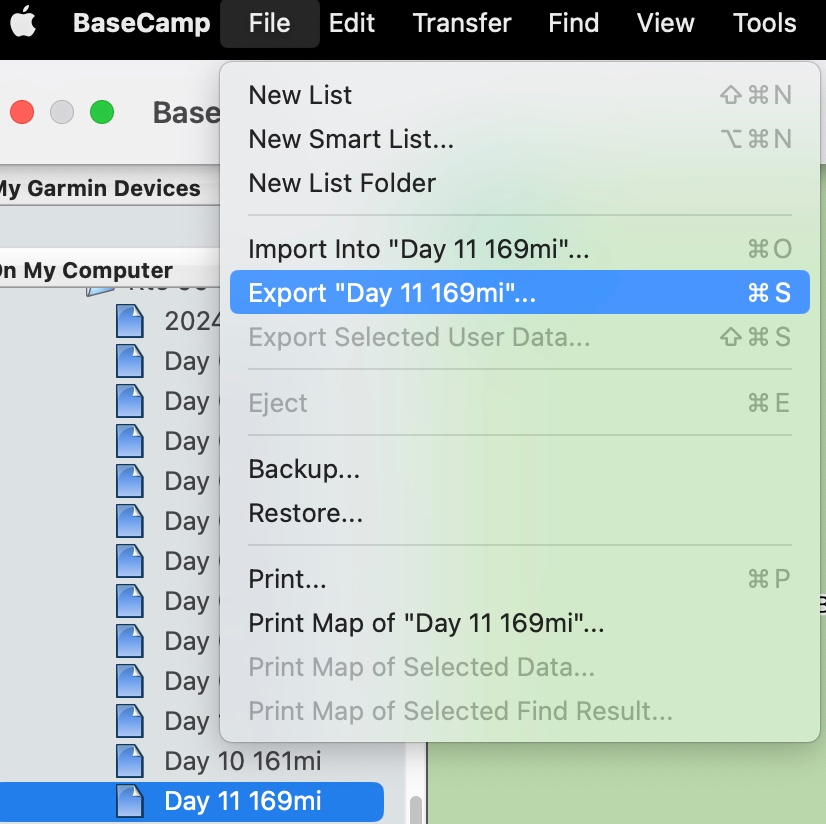

You are exporting the entire "list" known as "Day11 169mi." Try this instead: select that list and in the bottom portion of the BC window, scroll down to just the route itself. Select it and use "Export Selected User Data." This has always worked for me, whereas exporting multiple items in a list has often caused problems. The route should include any waypoints in it and they should not change.

Followed your suggestion which ended up working out.... I deleted the Day 15 route off my SD card and re-exported using your recommendation. To my surprise, all was good upon cross checking it. I then dumped/replaced a couple more routes which was better with the exception of two waypoints. I redone those two routes but, exported them using my old method "Export Day 01" for example but, I kept highlighting the routes from the lower left window. Both routes were perfect! Filled with excitement.....LOL. I dumped all the others off the SD card and started fresh in the XT. Out of 20 routes I had 7 waypoints that were re-named in three different routes. I went into those routes and replaced those waypoints with new ones. Re-tested, now all 20 are great!! Interesting..... All I can think of is it relates to the way they're exporting. One thing for sure, highlighting the route in the lower window made a huge difference. Only other thing I didn't try was drag and drop onto the SD card with the XT plugged into my MacBook. Thank you for taking the time in helping me out! I sincerely appreciate it. RayPaulaRay wrote: Tue May 07, 2024 5:57 pmdanham wrote: Tue May 07, 2024 5:30 pm @PaulaRay,
Thanks for the help.... I will definitely give that a try. I never thought of transferring that way before. I have always highlighted just one route from my list folder at a time. Thanks again, appreciate it. Ray
