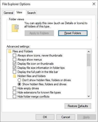

To make hidden files visible on your PC, type 'File Explorer Options' in the search box. (Its in Control Panel if you want to access it in that way).
Click on the 'View' Tab.
Look down the list and mark the Show Hidden Files, folders and drives.
See below.
You may also want to untick the option further down to hide the file extensions for known file types. I like to see the MyFileName.gpx rather than just 'MyFileName' - but that isn't essential, and up to you.
Click Apply, and then OK
Go back to your File Explorer, and a number of hidden files (preceeded with a dot) will now be visible. One of them is .System

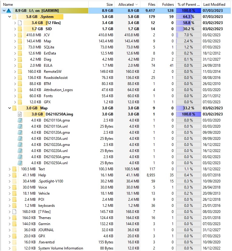

Below is a scan of my Internal Storage folder showing sizes of each folder including the contents of subfolders.
I have expanded two main folders (.System and Map) so that you get a bit more information.
This from a Zumo 595, after a recent system reset, current system software and the latest full European maps
CN Europe 2023.20 North, south, Foursquare and DEM. Click on the image to see it full size.
Internal Memory is just 16Gb. 8.93Gb used, 5.35 Gb free.

Well let's see what you find in your .system folder. For the most part, and I've used various Garmin devices in a period spanning 15 years or so, things work well. Occasionally, like most electronics, something goes wrong as it seems to have in your case. As you can see in the above post there should be plenty of free space on your device so something has been put there that is taking up space. Once we know what's in the .system folder we can see what that is and I'm sure we can resolve the issue for you.PaulaRay wrote: Tue Mar 07, 2023 12:14 pm Yes it is Garmin, without a doubt. Yes, other 595 owners do have this problem. A great example can be foud here; https://www.advrider.com/f/threads/garm ... s.1461984/

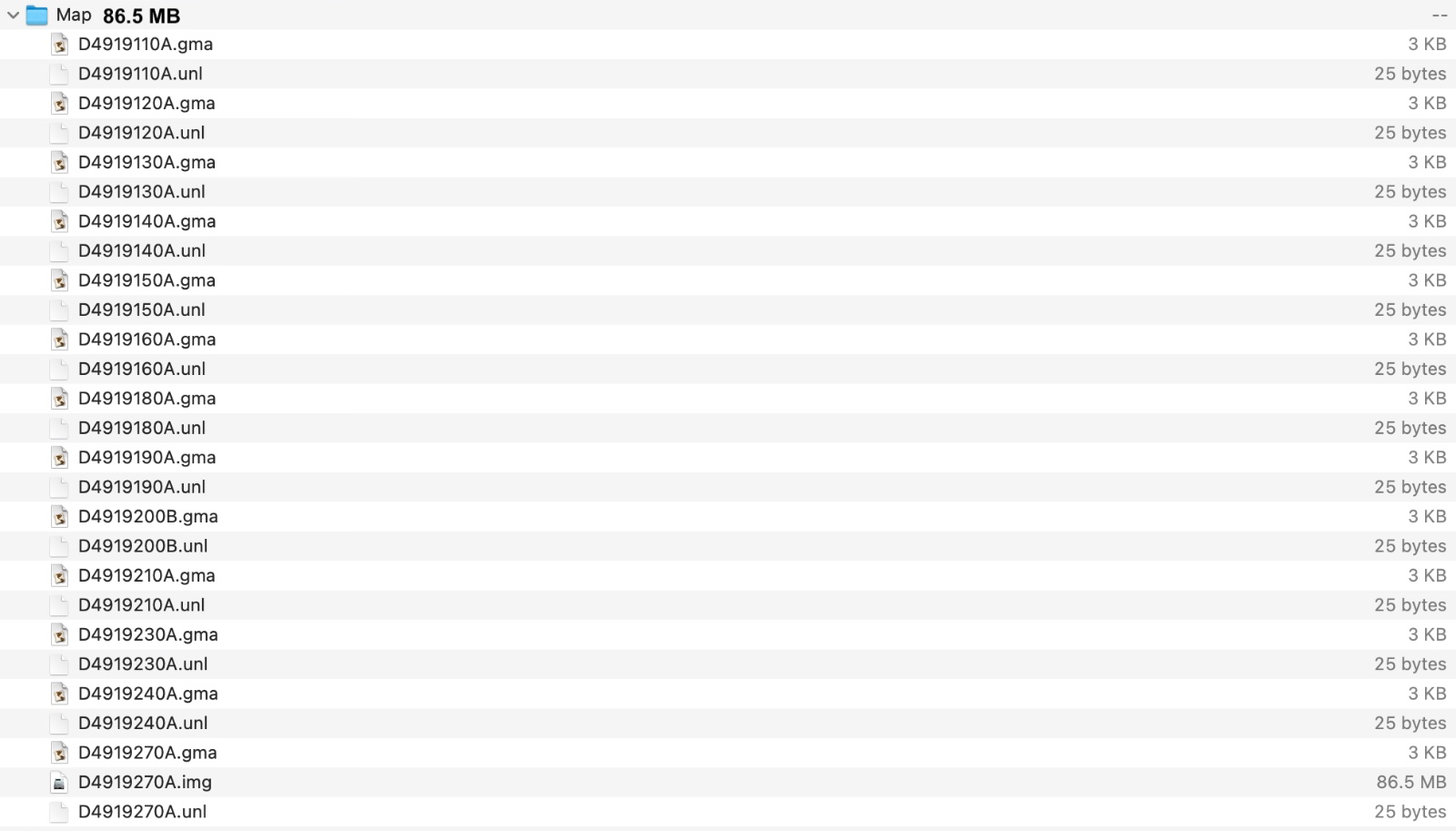

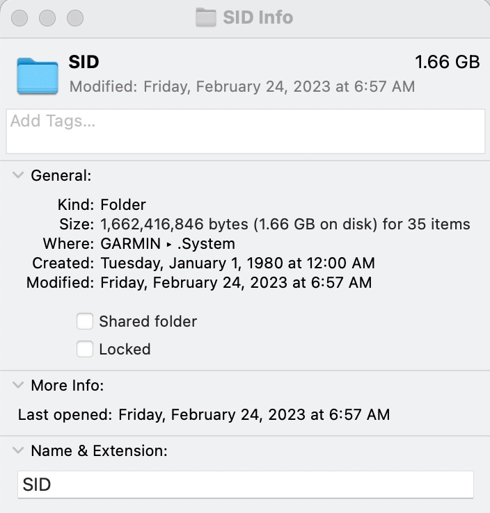

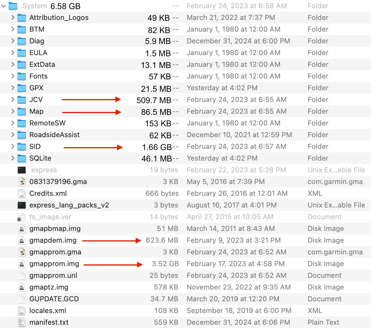

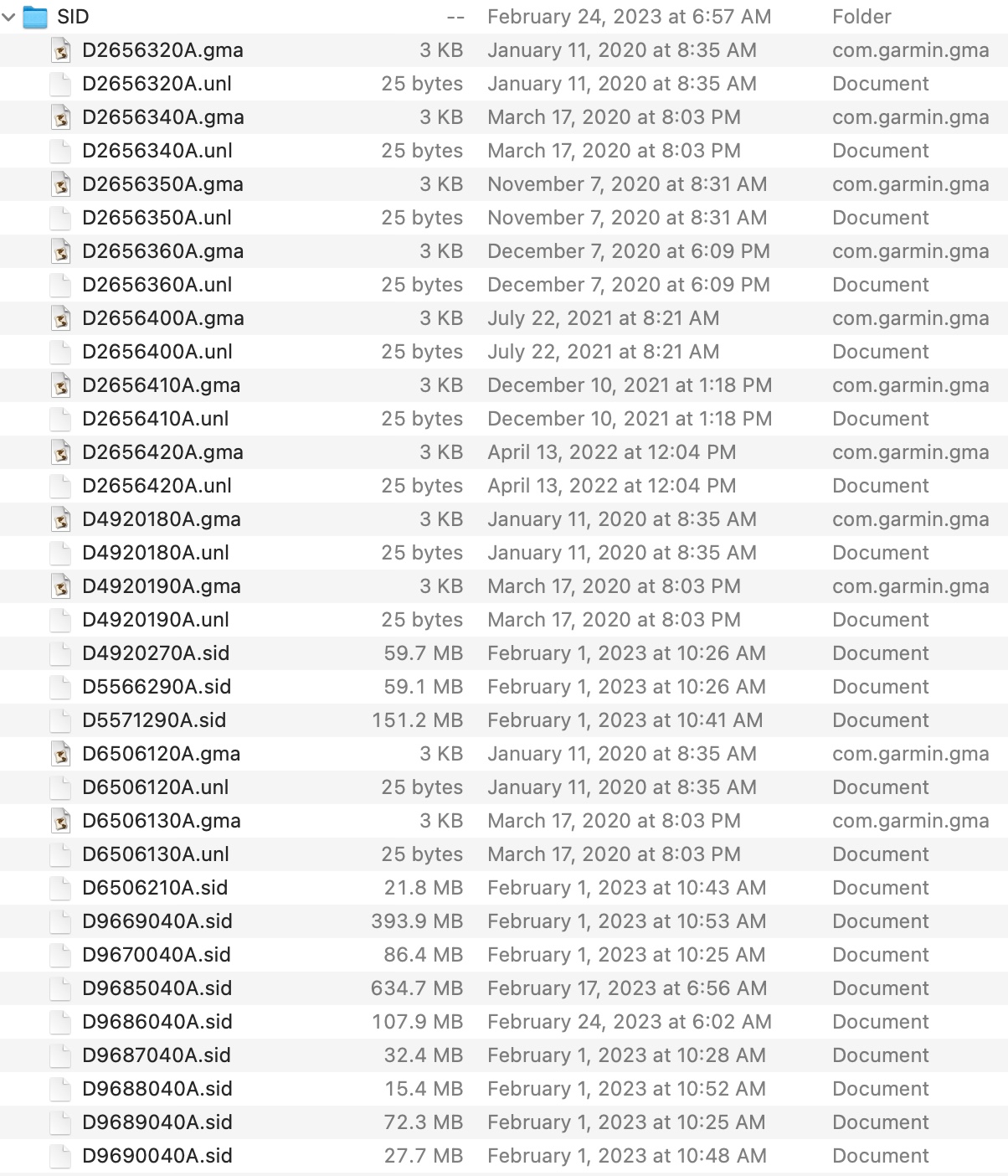

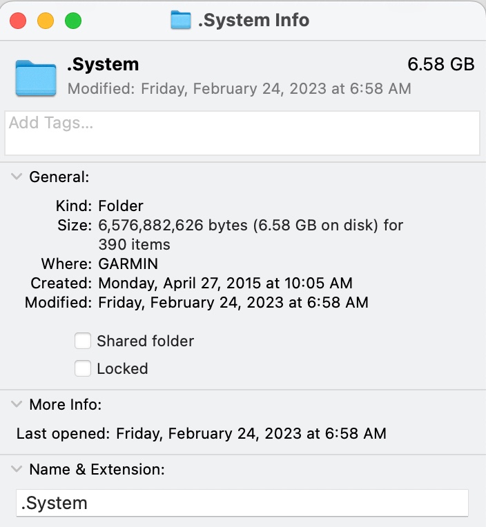

THANK YOU JFHeath for all your help and taking the time in explaining all those steps to get me to Garmins System folders and files!!! I'm on a MacBook Pro M1 Max but, with a few other deviations, you got me there! I also created a backup as you suggested. There is a total of 6.58GB within the System folder. Map folder is only 86.5 MB. On the flip side, gmapprom.img is the largest at 3.52GB. This and other larger folders/files are highlighted by red arrows below. I also included folder file sizes that wasn't directly shown. I read elsewhere that SID files can be deleted which shows older maps but, my larger ones in this folder is from the latest update. Now, I need some great advice on what to delete without making my 595LM a total brick... Thank You again for all your time in helping me out, I sincerely appreciate it. Ray

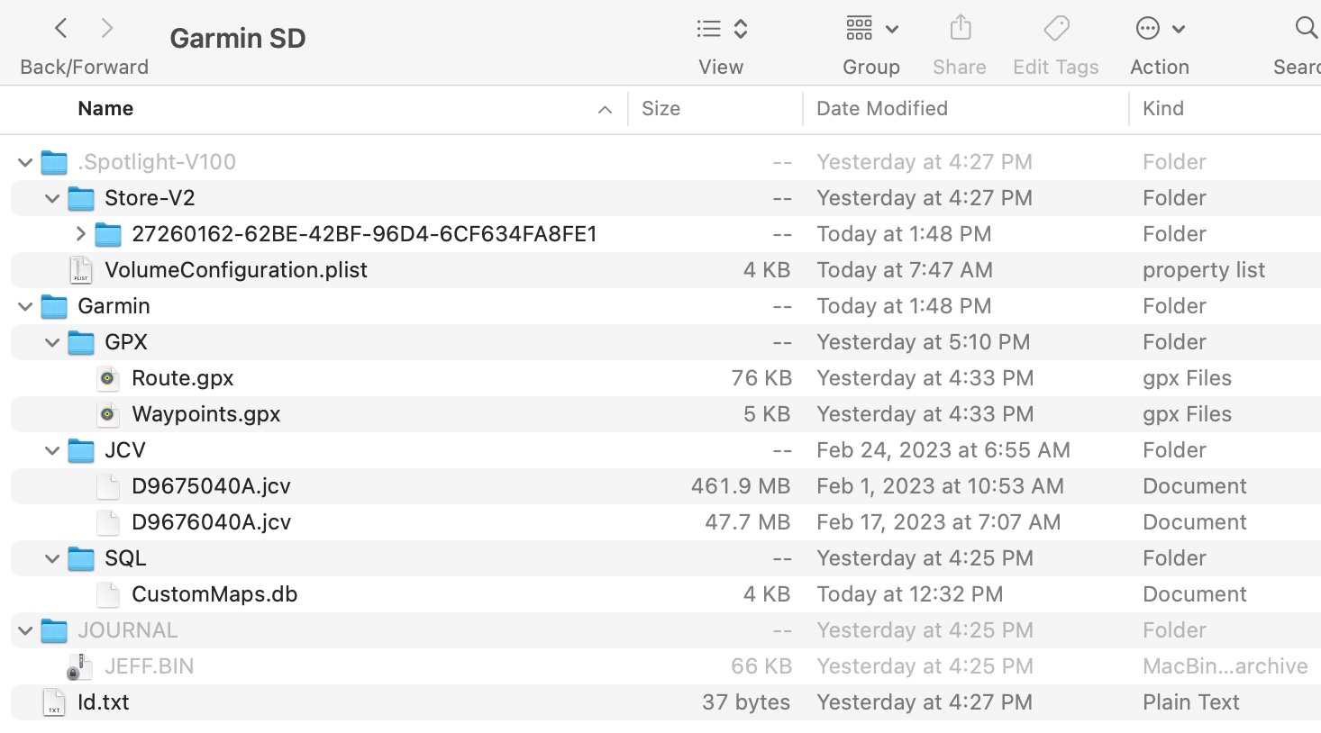

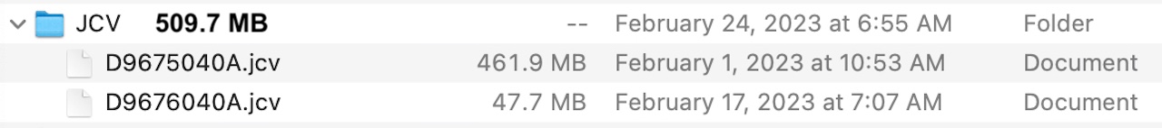

Ok, the easy way forward is to move the JCV folder to the Garmin folder on your SD card. See what effect that has.
There is a lot of tidying up that can be done later if you want, but moving the JCV folder should give you a device that works.

I copied it to my Garmin SD card... Should I delete the JCV folder from the Garmin drive or lave it? Also, for me to give this a try I'll have to revert back to Mass Storage on the 595LM. Should i do some more cleaning first? Thanks for the help!sussamb wrote: Tue Mar 07, 2023 6:22 pm Ok, the easy way forward is to move the JCV folder to the Garmin folder on your SD card. See what effect that has.

You need to move the folder, not just the .jcv file, or at least place it in a folder on the card named JCV. Let's get it working first before we start any other tidying up.
Edit: although from your screenshot you've already done that?

I moved the whole .JCV folder to the SD card as shown. It's a copy therefore, should I delete the original one that's in the Garmin drive? Thanks.sussamb wrote: Tue Mar 07, 2023 9:33 pm You need to move the folder, not just the .jcv file, or at least place it in a folder on the card named JCV. Let's get it working first before we start any other tidying up.
