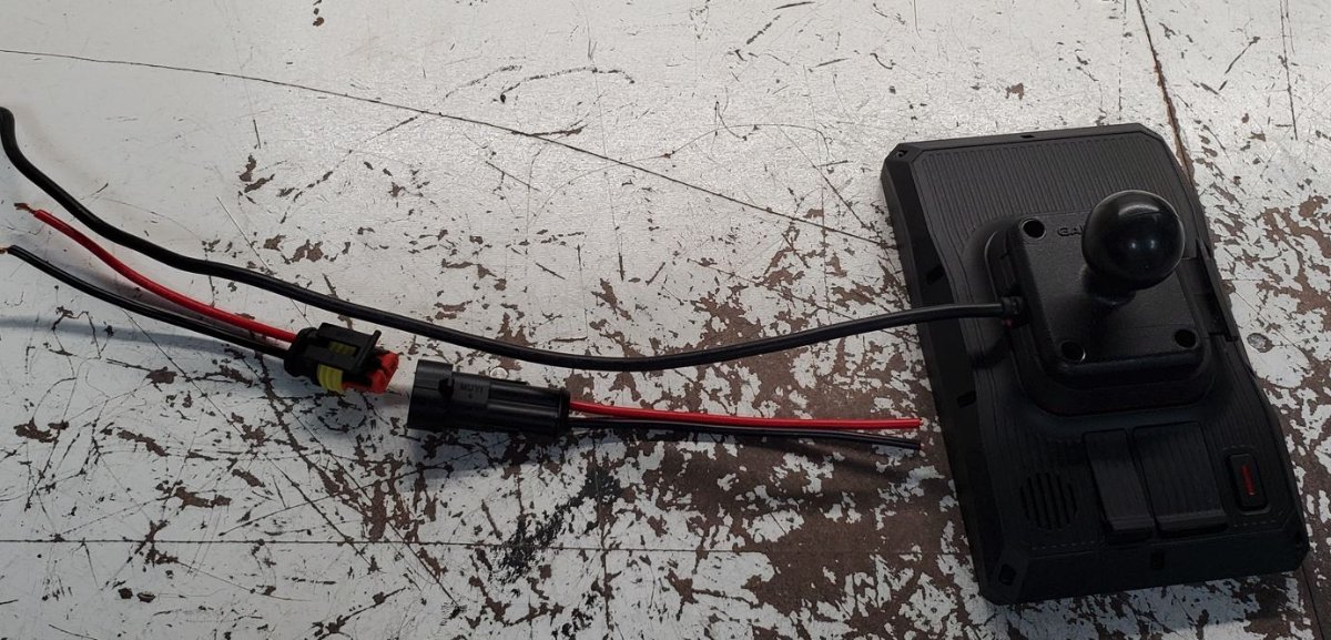

So I decided to register after seeing the post on the connector design failure. Why was I looking? Yup, mine failed too. Pin broke in the mount / connector after 4 trips on my motorcycle - BMW GL1600.... So the unit isn't seeing the abuse it could if it were mounted to my trail bike... I've worked in connector design with plastic injection molded parts and this design....well you you just have to ask why when there were so many PROVEN methods that WORK. Just look at all the other connectors on your bike and car and do you see any of them designed like this mount??? There's a reason for that.
Anyway, I contacted Garmin and they are sending me a free replacement cable to install. Great....it has a 1 year warrantee so if it fails again - oh gee, I get another free Piece of crap to replace it... again. So rather than that inevitable outcome, I'm thinking of adding an automotive - weather proof style connector in line behind the contacts so that the problem pin interface doesn't come into play. I'm using a ram mount and will remove the ram part and disconnect the connector when removing it from the bike. A little more hassle, but at least it shouldn't fail on me in the middle of nowhere...I'm hoping that a single install against the pins will last a lot longer and let a true - proven connector do the work. I'll let you know how it works out.

7andMoto wrote: Mon Aug 16, 2021 6:10 pm So I decided to register after seeing the post on the connector design failure. Why was I looking? Yup, mine failed too. Pin broke in the mount / connector after 4 trips on my motorcycle - BMW GL1600.... So the unit isn't seeing the abuse it could if it were mounted to my trail bike... I've worked in connector design with plastic injection molded parts and this design....well you you just have to ask why when there were so many PROVEN methods that WORK. Just look at all the other connectors on your bike and car and do you see any of them designed like this mount??? There's a reason for that.
