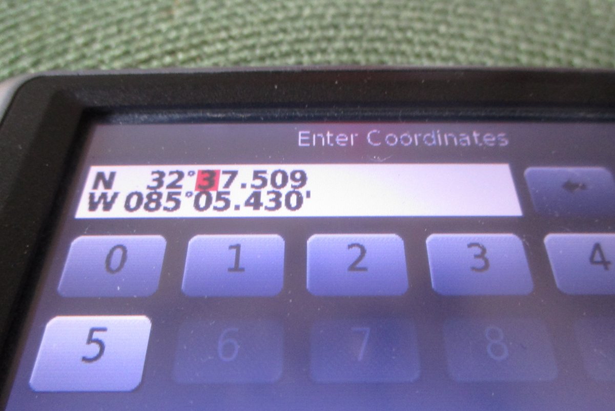

The suggestion seemed logical but after reformatting I still can not enter the coordinates I wish. I wish to enter 32.838212 but I am not allowed to enter a digit greater than 5 in the third position. Perhaps this photo will help explain:
As you can see, the numerals greater than 5 are not available in the 3rd position
Re: Entering coordinates
That's because you're trying to enter a decimal format into a degrees and minutes format. You need to select the lat/long decimal format.

Sussamb is absolutely correct. Reset puts you back to h ddd mm.mmm with a Datum WGS 84. As Sussamb stated you have a decimal format. You need to change your format to h ddd.ddddd.
Where To>arrow down>Coordinates>Format>Format box>arrow up>pick h ddd.ddddd>OK>back. You should be able to enter 34.872. Sorry, I should have told you that to begin with. However; reset will make sure you are using the correct datum WGS 84.

Sussamb is absolutely correct and Wingstyle your directions were spot on. Y'all rock. Now back to rallying.
