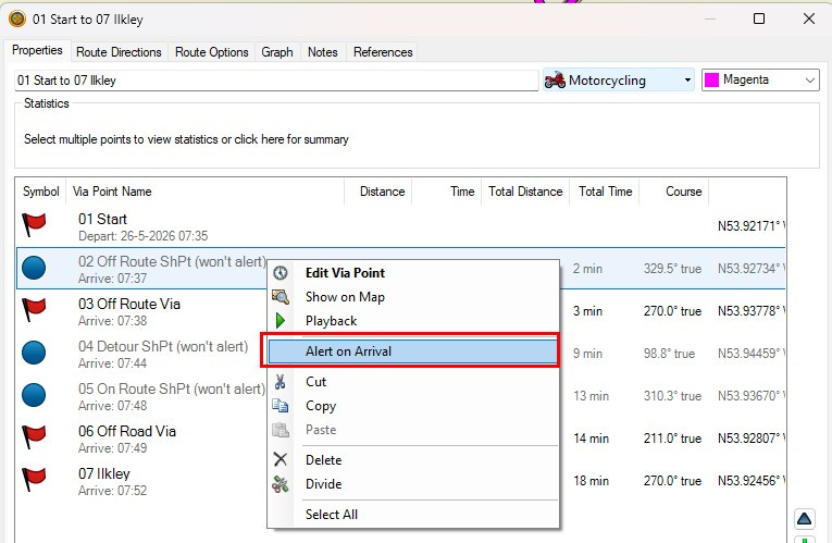

A Basecamp Waypoint can eventually be found on the XT in at least 3 ways.
1) It can be converted to a POI and then you will see it under 'Categories' / 'Custom Pois'. ONLY then the proximity is used!
2) It can be stored under 'Saved' or 'Favourites'. Then it is NOT related to a route/trip, and you will NOT be alerted.
3) It can be part of a route/trip. It will alert only when it is marked as a Via point/Alert on Arrival in BC.
Are you talking about 3? Set it to 'Alert on arrival' on the route in BC, or change it to a 'Via point' in the 'Trip Planner' on the XT.
Notes :
- The proximity is not used.
- When changing a Via Point back to a Shaping point on the XT, it can get relocated.

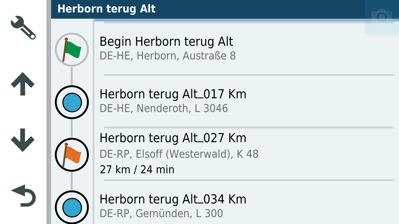

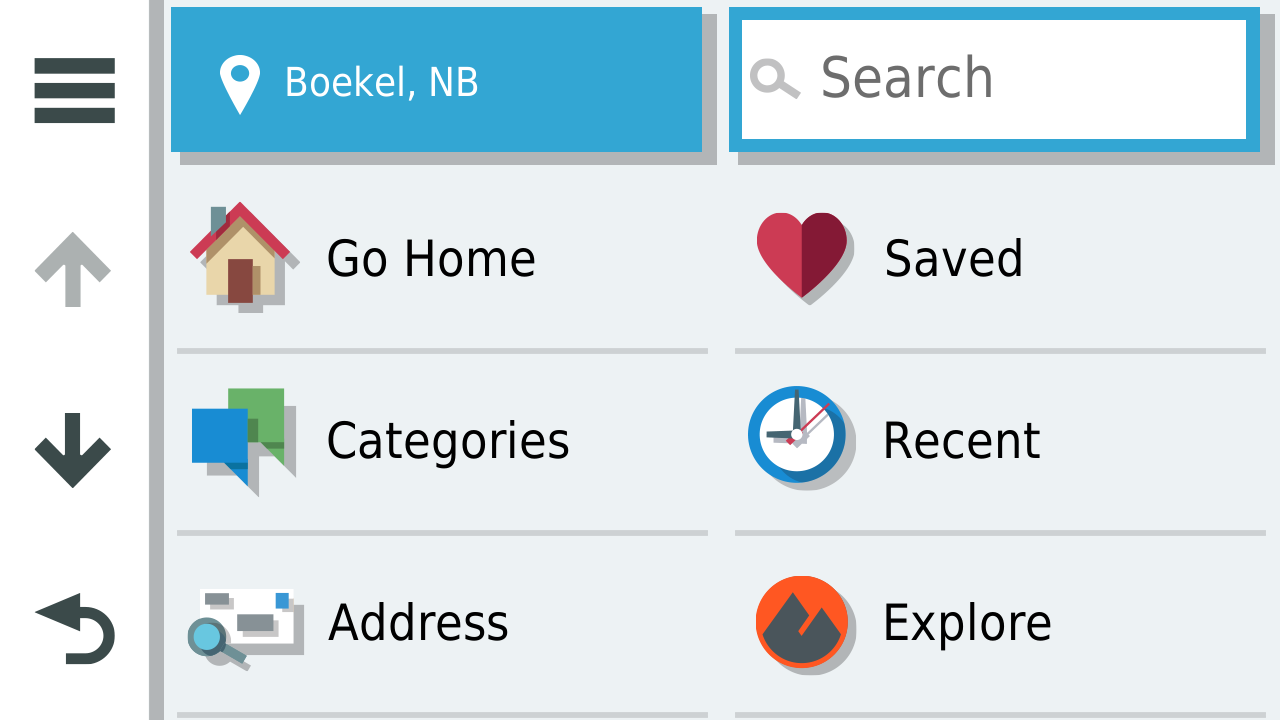

Screenshots of the XT:
When you click on 'Where to' choose either 'Categories' for option 1, or 'Saved' for option 2.
When you open a trip on the XT, in the Trip Planner. You can see shaping points as blue dots, or via points as red flags. The blue dots will not alert you, the red flags will.
