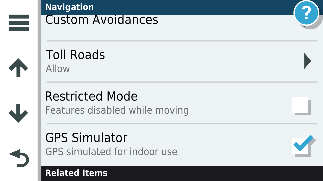

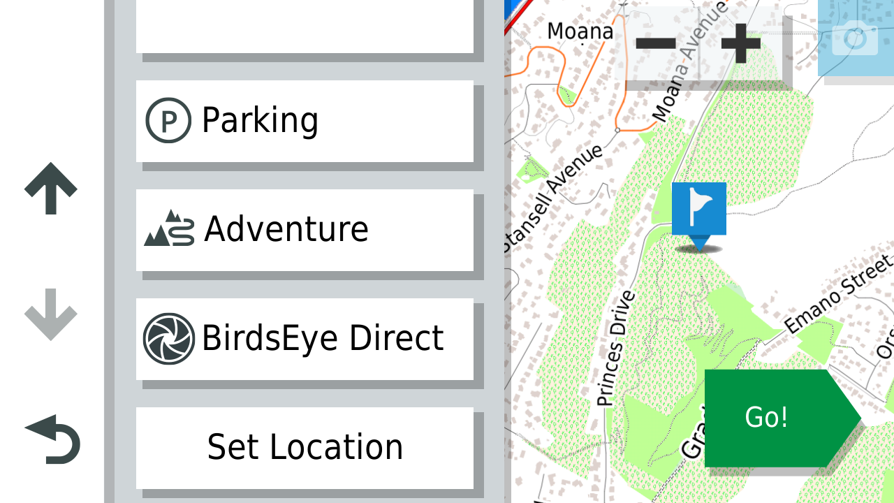

If you want to simulate these routes you have to switch the GPS signal off to your device and tell it where the start of your route is.
From the Zumo XT manual the procedure is as follows.
1.Select Settings > Navigation > GPS Simulator.
2.From the main menu, select View Map.
3.Tap the map twice to select an area.
4.The address of the location appears at the bottom of the screen.
5.Select the location description.
6.Select Set Location.
*Note make sure that the GPS off for indoor use is Ticked or the "Set Location" option does not appear.
You can the apply the RUT fix from where you are going to be rather than where you are.
