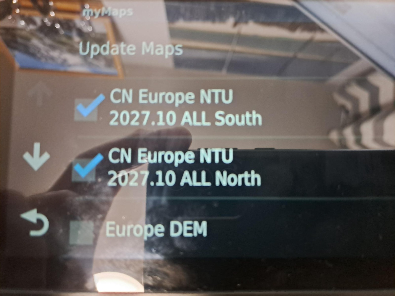

My maps on the xt shows cn europe NTU 2027 south + cn europe NTU 2027 north

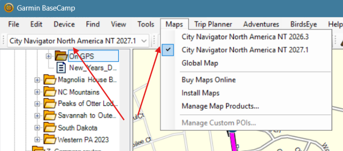

Verify the map being used by Basecamp is the NTU map because it sounds like its active map is the Global Map which lack street detail.

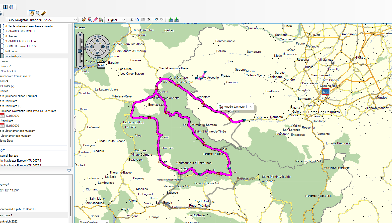

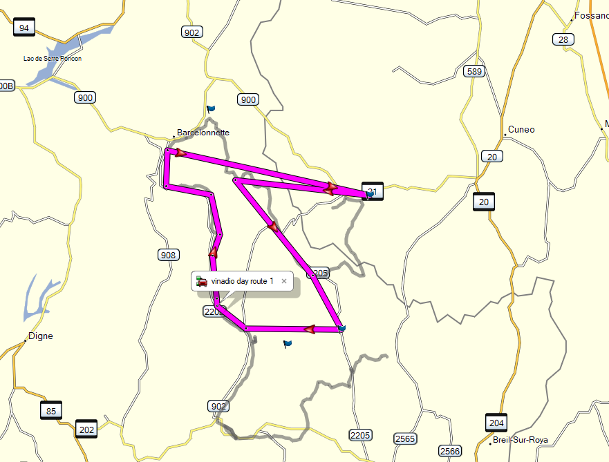

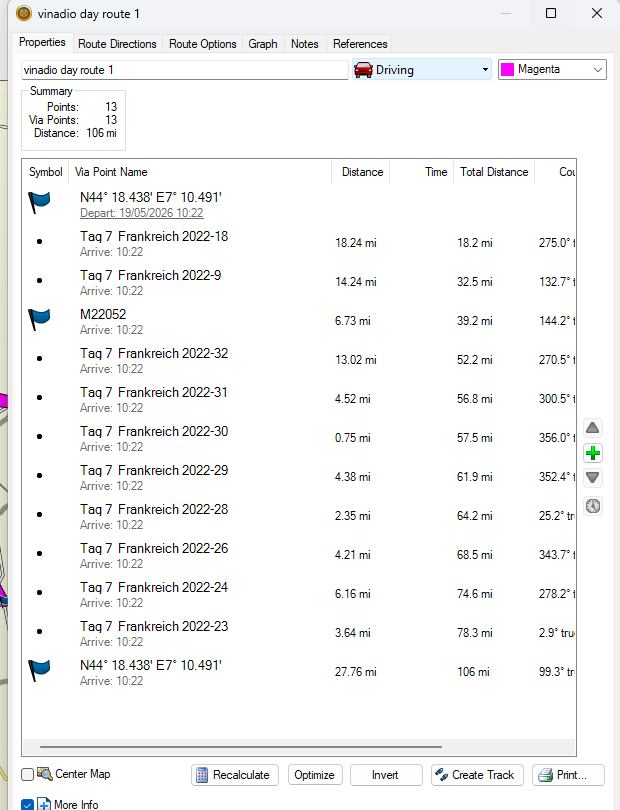

Definately says CN Europe NTU 2027.1 when I used the version installed on the Zumo XT photo 1 - but route is straight line with no detail
But when I use version installed on PC photo 2 - it all looks ok?

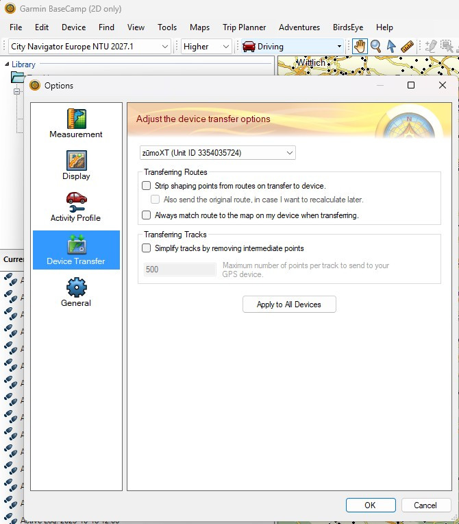

Not sure if this your problem, but please check the 'Transfer settings' in Basecamp. All checkboxes should be unticked.

one thing I have noticed, when I use the map installed on the zumo on basecamp
I can get detailed maps in north Europe but not south Europe?? In the drop down, there are 2 maps installed on the Zumo, I presume one for north one for south? When I select one of the - it comes up with an error - error occured while attempt to use this map?
