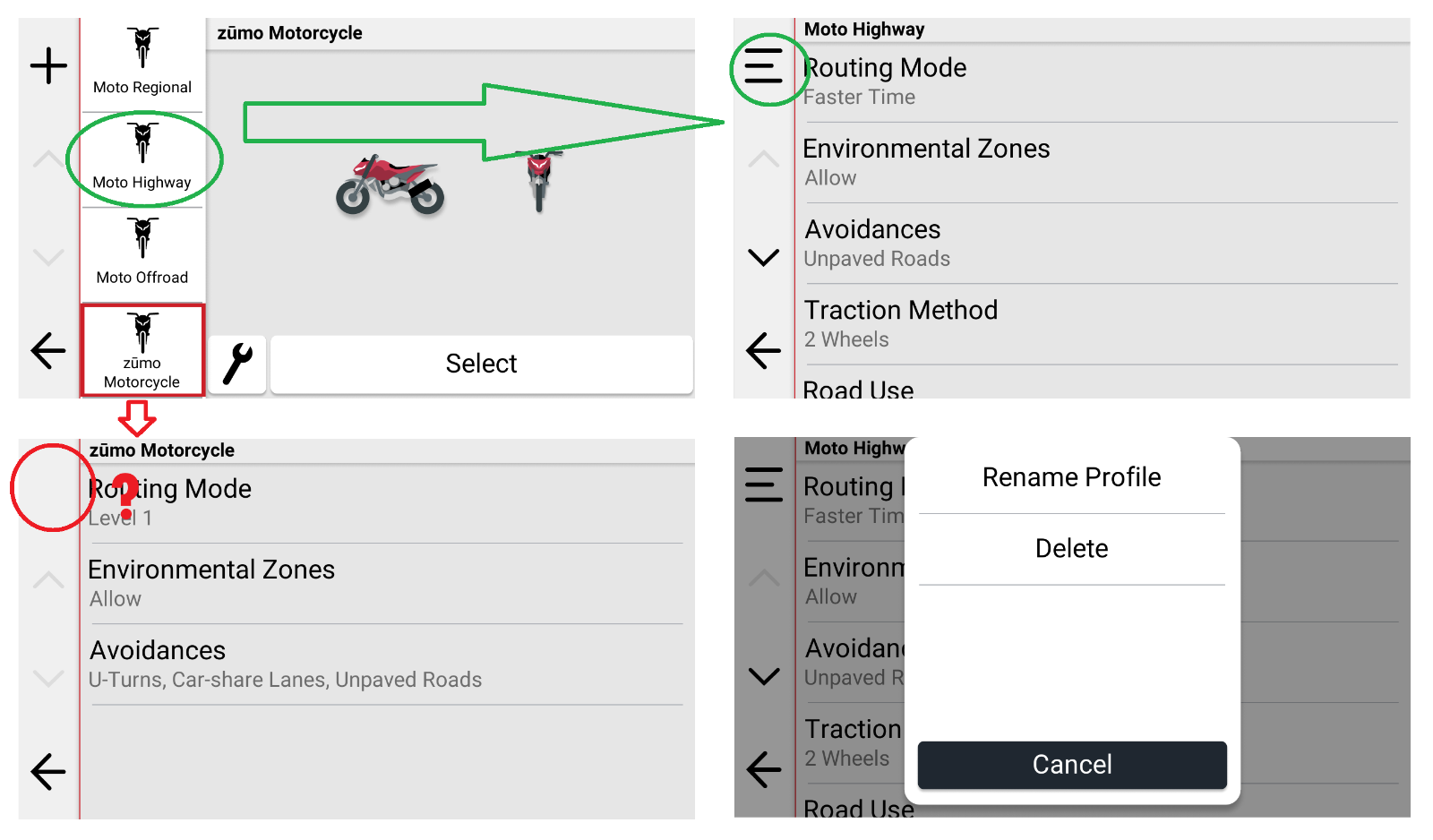

The pre-set "zumo Motorcycle" profile can't be deleted, can't be renamed, and is missing some options
XT3: delete default profile zumo Motorcycle
The thought processes of Garmin's developers are sometimes a mystery to me...

Re: XT3: delete default profile zumo Motorcycle
As far as I can tell, the default “zumo Motorcycle” profile is currently only available for the zumo XT2.
It's the standard setting for the Zumo XT2; unfortunately, there are no other options on the zumo XT2.
It's fixed and therefore “isn't supposed” to be changeable.
Did you once pair a zumo XT2 with the Tread app, not delete that zumo XT2 from the app, and then pair the zumo XT3 with the Tread app as well?
If so, you’ll get the zumo XT2 profile, unchangeable as it’s designed, on your zumo XT3 as well.
You can also uninstall “Zumo Motorcycle” if you only want to use the XT3.
Either reset the Zumo XT3 and the Tread app, or use a workaround in the internal database—but that’s a different topic.
@proofresistant Bingo! Thank you for the guidance.
Problem solved. The profile was inherited from XT2 in Tread app in my phone.
Clarification: The profile was inherited from Explore app/web, no from Tread, and it is a heritage from XT2.
After resetting only the Tread app and the XT3, the "zümo Motorcycle" profile returned. On my second attempt, I reset the Tread app without enabling synchronization, reset the XT3 without enabling synchronization, deleted everything from explore.garmin.com (and from the Explore app), and only then enabled synchronization and imported the waypoints via GPX file to Tread app.

I have done quite some testing with the XT3, since I got it.Francis wrote: Tue Mar 17, 2026 9:22 pm The thought processes of Garmin's developers are sometimes a mystery to me...
The pre-set "zumo Motorcycle" profile can't be deleted, can't be renamed, and is missing some options![]()
I cant confirm your statements. Meaning I CAN delete, edit ALL profiles, also the default.
What does happen, when the profile is 'out of date' that the XT3 creates profiles. Often resulting in duplicates
