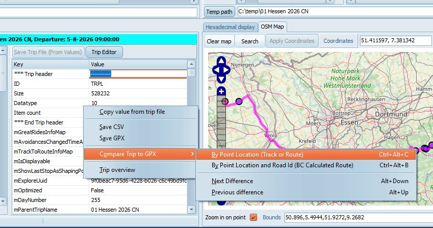

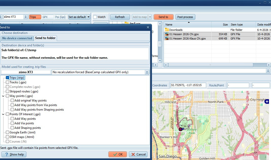

You can do that like this. I assume you have 2 GPX files with 1 route each.
- Dont connect your XT
- Create trip files from the GPX's. Select both Gpx files, Click on 'Send To'. Use these settings. - Select one of the 2 trip files, created in a sub directory.

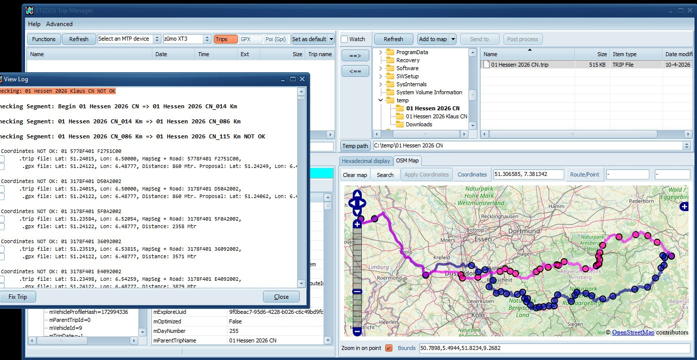

- Right click on the grid, and start the compare - Open the 'Original GPX' belonging to the 'other trip file', confirm the trip name.
The Compare window: The RTFM's: https://frankbijnen.github.io/TripManag ... hagpx.html
