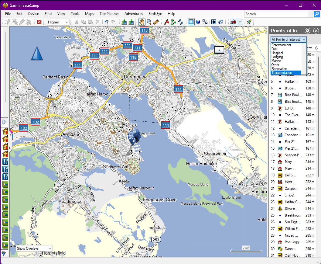

I was updating my 2026 summer plans to the East Coast of Canada this summer and low and behold Garmin has gone and done it again!!
When North America NT 2026.3 is the map selected in BaseCamp, I can choose "Food and Drink" as a category under POI. When using the 2027.1 version the choice is gone, further still it is not found in any other place other than ALL POINTS of INTEREST. What PITA!!! Seems others are also gone like Auto Services, Community, Bank/ATM, maybe others. Thanks Garmin, really client focused as always.
Anyone else or anyone have an explanation?
Screenshot 2026-03-20 214320.png (824.29 KiB) Viewed 678 times

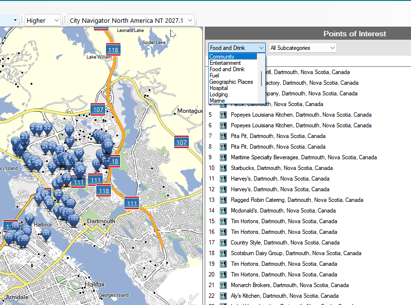

Screenshot 2026-03-20 214415.png (821.05 KiB) Viewed 678 times

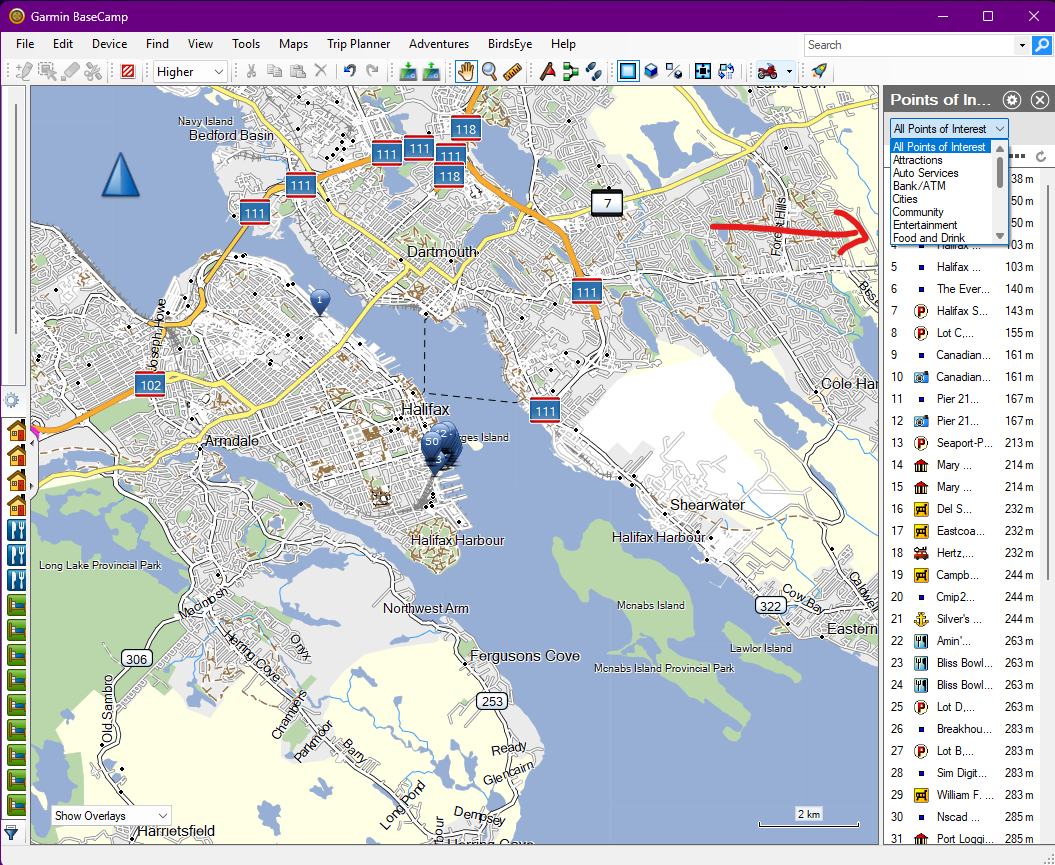

Re: "Food and Drink" gone from POI Menu in 2027.1
I have those categories in CNNA NT 2027.1, so try @Peobody's fix
2026-03-20 22_20_08-Garmin BaseCamp.png (391.27 KiB) Viewed 671 times
