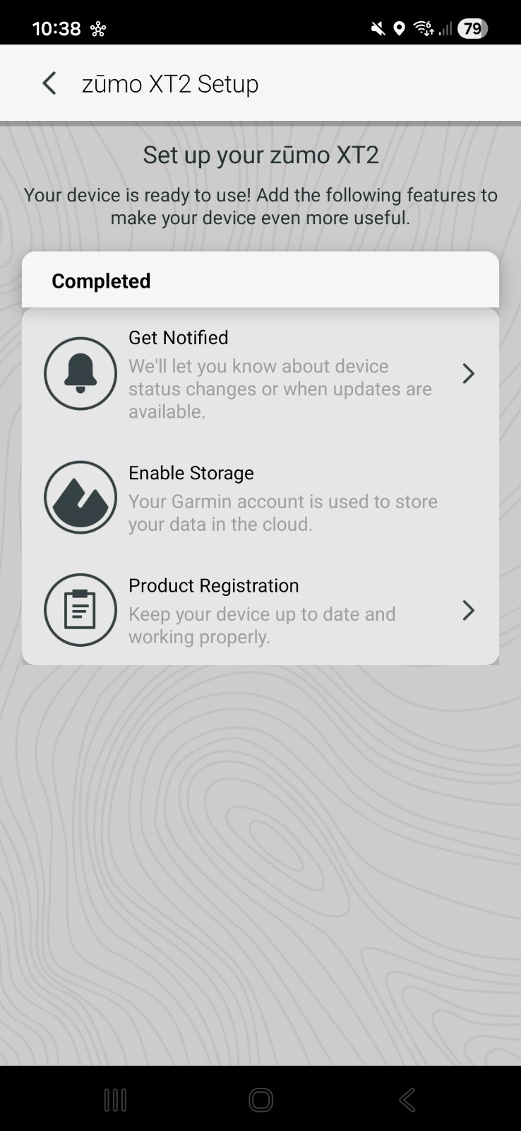

Has anyone reset their XT2, or got a new one, and added the Tread app with the ability to chose whether the external storage wasn't automatically enabled.
This is what I see in Tread for my XT2
- Screenshot_20260228_103849_Tread.jpg (122.65 KiB) Viewed 917 times

Yes, they got rid of the mandatory "auto" sync some time ago. You can now choose to sync to your units routes with the Tread App or just leave it alone. I highly recommend the latter. The one thing I don't believe it does well is TELL YOU it's changed something. It just updates to what the Tread App thinks is right then overwrites your XT2 route without telling you. If it were strictly speaking, just a sync between the two it would be fine but the fact that is "massages" the route unexplicably without telling you is very troubling. IMDO.

I tried this just now. I was able to go into the Tread App, make a route, hit Sync (upper left corner in the Explore feature) and it is reading my test.gpx file. Just looked deeper into my Tread App, it seems I do have the "Enable Storage" feature turned on and I cannot undo that. Sorry I really thought I was helping but it seems I am unable to do so.

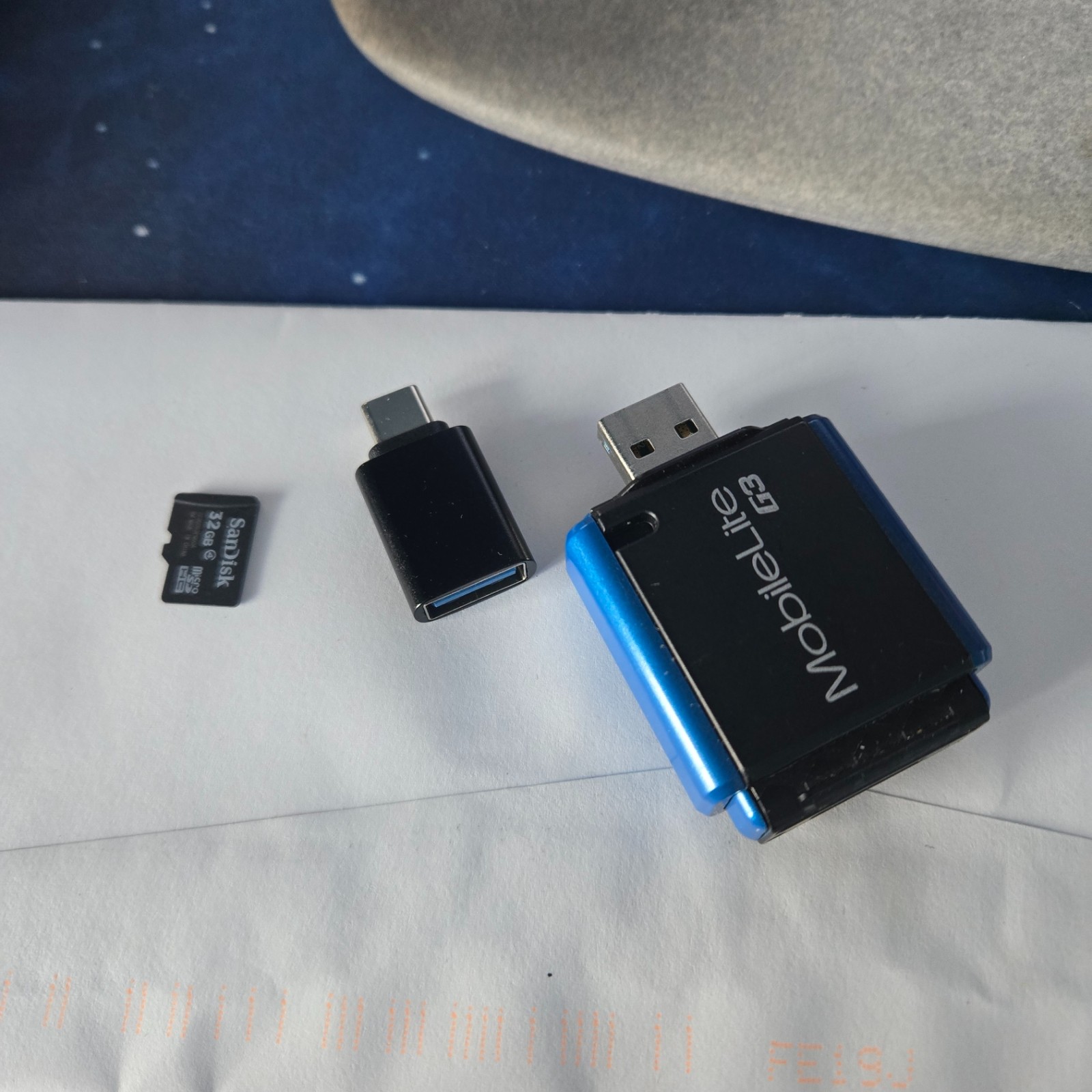

This is very small and might do it for you.

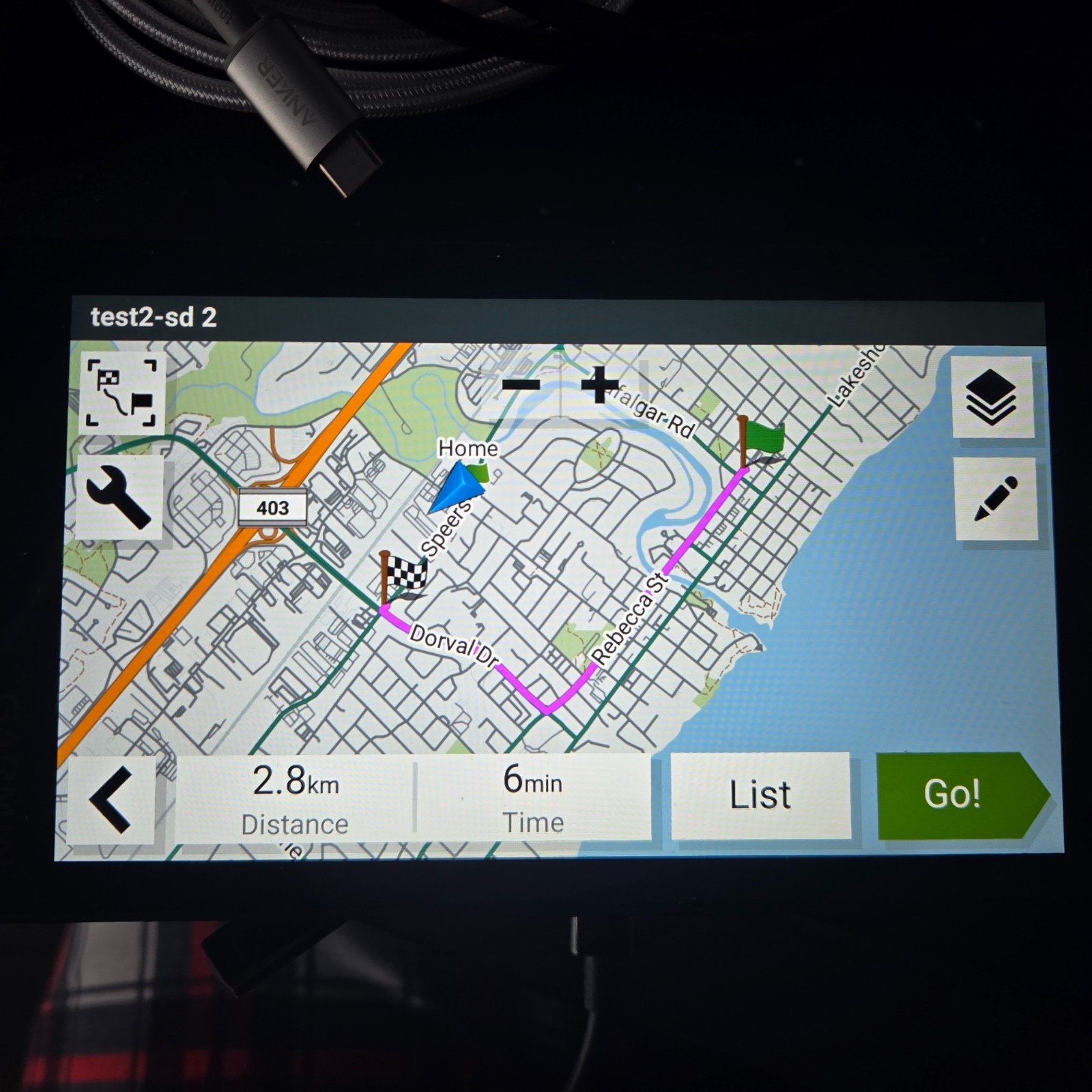

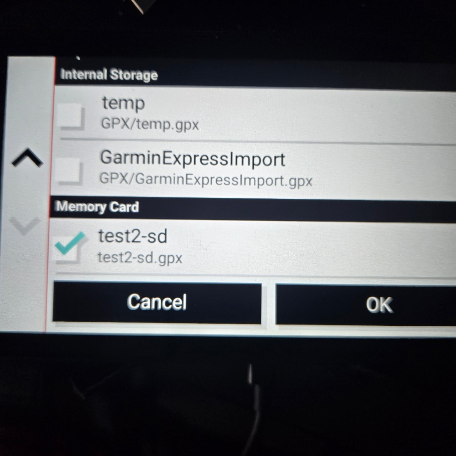

Re: Tread app "Enabling Storage" automatically
I did it! I made a route on Tread App, sent it to myself on Signal, saved the file to the SD Card through the adapter I had on hand. Then I inserted the SD Card into the XT2 and it found it, and asked if I wanted to IMPORT it. I did. It worked. Hope that gives you an option.
