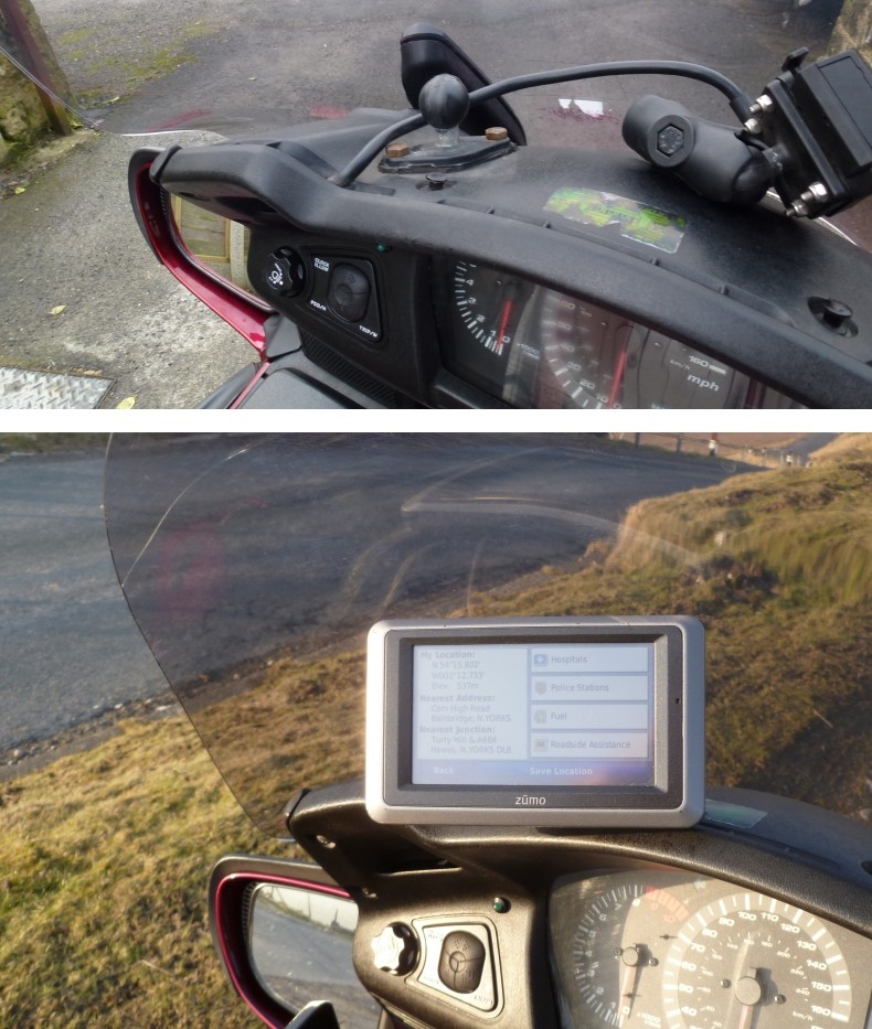

Here is my 3rd Pan European with the RAM ball mounted and again with my old Zumo 660 mounted on the Ram Ball.
Zumo 660 Fitting.jpg (177.87 KiB) Viewed 5975 times
The top half shows the ram ball mount - which is mounted on a rubber cushion cut from an old inner tube and bolted through to a circular metal plate on the underside of the dash - also sandwiching a piece of Inner tube. It works really well.
My new bike - well, at present I am not so sure about how to get under that bit of the fairing at the moment - but even if I was, the dash plastic seem to be much more brittle than that on the ST1300.

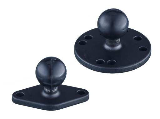

So I am wondering about these RAM Ball Mounts. My 1300 has the lozenge shaped base. I'm wondering about using the circular one (which is what I had on my last 1300)
Ram Ball Mounts.png (135.14 KiB) Viewed 5975 times
Rather than using my previous method, I am wondering about trying a different method

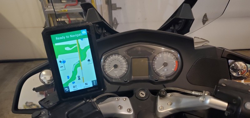

I could never bring myself to drill holes in the plastics. I doubted their strength and stability and did not wanted to be left with unused holes if I changed or removed the GPS. There were various other metal mounting brackets and bars available to fit my bike, but I balked at the price.
I tried a couple different RAM mounts before settling on the RAM-B-346U, which mounts on top of my clutch reservoir. I cannot quite capture my actual view with a camera, but in vertical mode the XT nicely fills the visual space between speedometer and mirror. (It does not look so tall in person.)
XT mount.jpg (63.87 KiB) Viewed 5963 times
A quick sweeping scan updates my awareness of speed, position, and surrounding traffic. Having the GPS closer to me makes the screen appear bigger. I don't need to reach to touch the screen, and my hand is always near the grip.

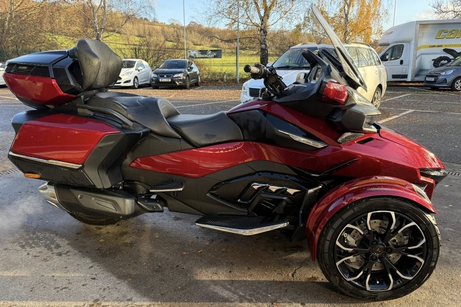

The new bike is a trike. A Can-Am Spyder - Touring verison. Two wheels at the front. The picture is my bike taken by the dealer before I bought it.
Spyder RTL.jpg (228.68 KiB) Viewed 5951 times
The bars may be a possibility - but I really don't like the satnav in that position - although I may have to get used to it. The standard Ram ball mount with the U-bolt supplied with Zumos may work, although the bars are a larger diameter. The mirrors are an integral part of the fairing. There are no brake reservoirs - in fact there are no levers on the handlebars at all - that really does take some getting used to.
I can probably get a Ram ball mount on there if there is nothing else available, or when I can find out how to get to the inside of the dash part of the fairing. I'll make sure that I can put back what I have already taken off before I start taking more off.
On the side view of the photo - click on the image to see a better zoomable version - you can see the dash hood sheltering the instrument panel. I want to mount the satnav on top of that behind the screen. It is much further away and much higher up - so the amount of refocusing and head movement required is very much reduced.

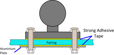

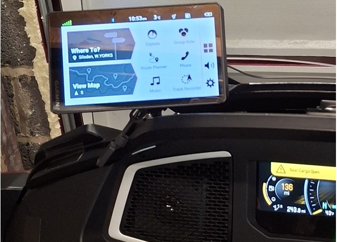

I managed to get the screen off - very easily. The fitting is much sturdier than the ST1300 - A chunky cast alloy carrier onto which the screen is bolted. Can-Am don’t do shoulder bolts to protect fairing and screen from cracking, which is poor, I think. But the bracket is raised by three pivoting arms, the central one is motorised. The screen has to come off to get to the pivot bushes - which were brass bushes seized inside a corroded alloy hole - so they took a bit of imagineering to extract. After that I could get the top grey plastic dash fairing off to see what was underneath it.
I was delighted to find that this plastic nose fairing was quite thick and resilient to movement - slightly flexible and very sturdy - slightly thicker than the screen itself. Lots of checking to make sure that the raising and lowering of the screen doesn’t catch on the top of the Zumo. Underneath the fairing/cowl there is plenty of space , so I was able to mount a ram ball base on the top left of the dash, just tucked behind the screen, in the position I wanted. I used strong double sided adhesive tape under the ram ball base and a metal plate under the fairing - also stuck with thick adhesive tape. Drilled through and gently bolted together with nyloc nuts that prevent the bolts from working loose. The tape provide the cushioning as well as the adhesion. The bolts make sure that it is never going to come off. The adhesive makes sure that it cannot vibrate against the plastic. Previous installations on my ST1300 I had used rubber strip cut from an old car tyre inner tube. This gel adhesive tape is better.
