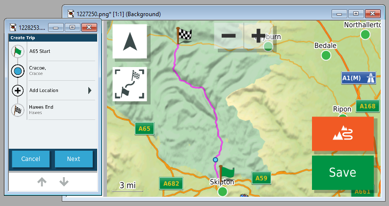

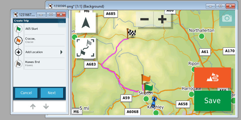

Re: Recalculation - what gets used from the gpx file?
Regarding the first comment - I couldn't find the images on here that I'm sure I posted - so it seemed quicker to reproduce a similar test.
3 points created on the XT1 screen and saved as Waypoints.
First route was created and the middle point was set to a shaping point.
I then changed the middle point to a Via Point ** and the route changed.
Change it back to a Shaping point it changes back to the same as the first image.
Change it back to a Via the route changes to the same as the second image.
** Using the XT1/ XT2 /595 screen to change a via to a shaping point often moves the shaping point slightly. But it never changes position if you change it from a Sahping to a Via. To minimise the effect of this I made sure that the point was A) A waypoint B) Placed on the location of a known placename - ie Cracoe.
But it illustrates the fact that the choice of a shaping or a via does affect how the route behaves on the XT1.
Although I expected the change in route to be the opposite way round !
