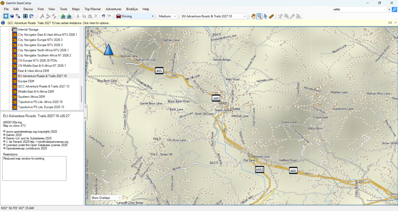

The EU adventure roads and trails certainly gobbles up the storage area on my XT2, especially as I already had the Africa maps on, and got them as well. Doesn't seem to be an option, so far of downloading it onto my PC.
A screen snip of my XT2 in Basecamp showing what the new mapping shows, and how CN EU NTU 2026.30 is still there.

The bottom left hand pain in the screen shot shows the file d8526120a.img as being the one that corresponds to the highlighted map in the list above
- CN EU NTU 2026.30
So should you want to remove that map from your Zumo, then delete that file from the map folder. - .System/map/d8526120a.img
(and normally, any other file with the same prefix)
