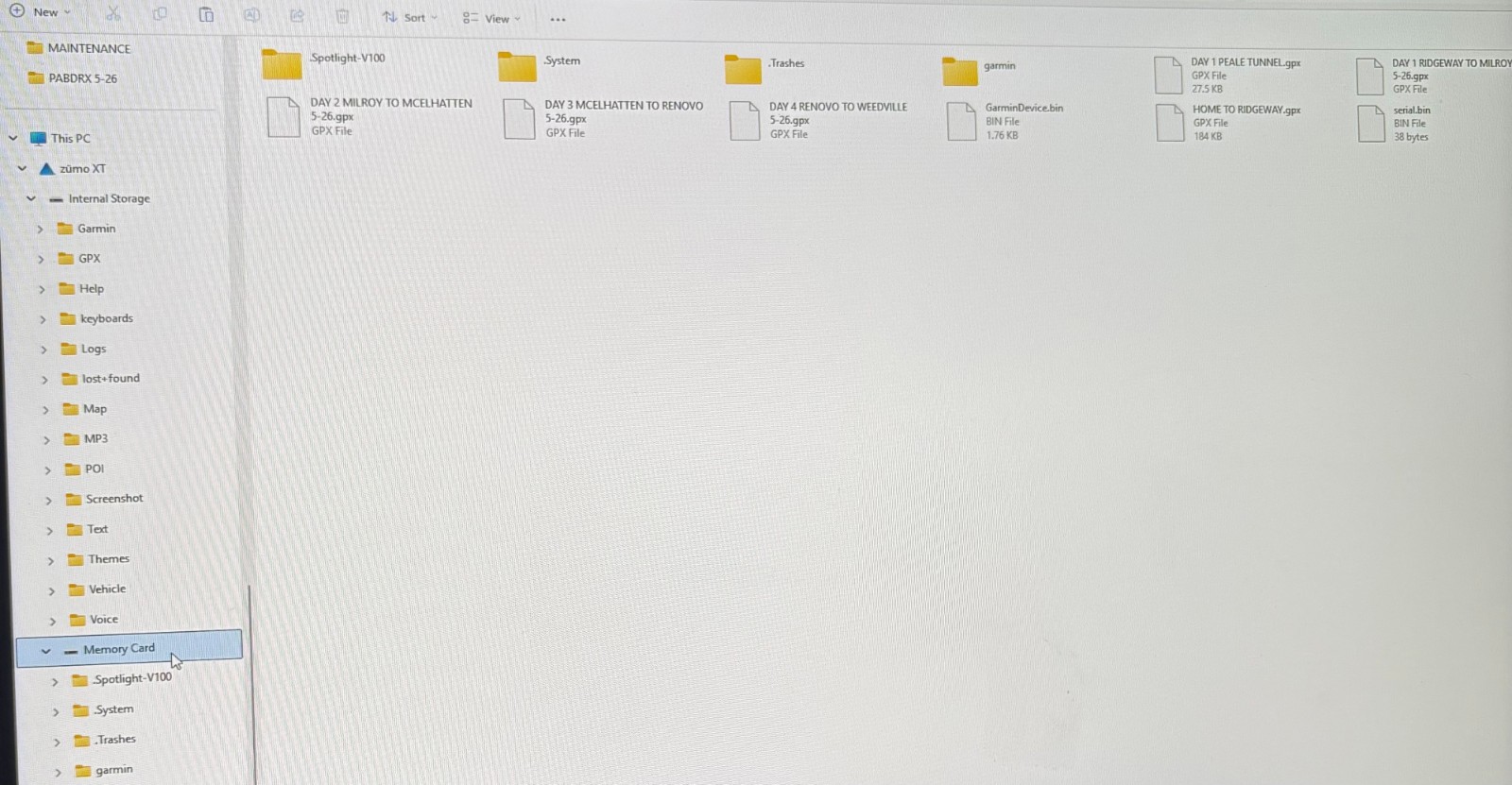

Well, I posted a question regarding transferring tracks to a Mac and found out what I have to do with that. But, now I'm having trouble with my PC...I can drag and drop or copy and paste tracks created on my computer directly into the GPX folder on the internal storage. I can do the same directly to the memory card. (and then open them on the computer and it shows those files are ther) When I go to apps, then tracks, then hit the wrench icon, says 'track options', hit import, but they aren't there to select. I did notice I have alot of old files that are available to import, is it possible there's too many there? I can't figure out how to delete them if thats the case. I'm old and this is driving me nuts!
I obviously need help in a bad way....
Thanks!

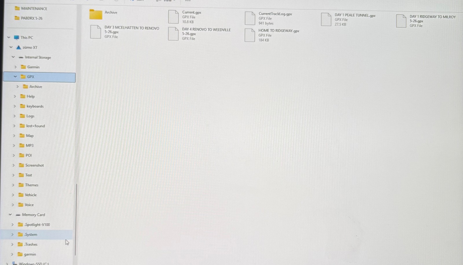

I'm about ready to pitch this thing. I went into the Zumo and on my computer and deleted every GPX file that was anywhere. Completely cleaned out. Internal storage and memory card, every subfolder I checked. When I was done there were no tracks in the Garmin tracks file, and no files to import.
So i transfer files into the GPX folder in internal storage, nothing shows up in imports. Then I transfer the files directly into the memory card, still nothing shows up.
What??

Thanks for your help so far! I tried internal storage, that didn't work. I deleted them, then tried the card, and didn't work either.
I transferred several files at the same time, and verified these files work. ( I used GPX studio )

Sorry for the confusion. In the beginning, SOME files did show up on the Zumo, but were totally random. That's what led me to clean it all out. After I did that, My Zumo showed no tracks available, and when I went to import there were no files to import.
So, then I tried transferring to GPX in internal storage. They will show up as being there on my computer, but the Zumo shows nothing to import.
I deleted these, and transferred them to my card. They will show up as being there on my computer, but the Zumo shows nothing to import.

Zumo 1.jpg (207.77 KiB) Viewed 486 times
Seems like something internal is screwed up. Is there anyone that "refurbishes" these?
