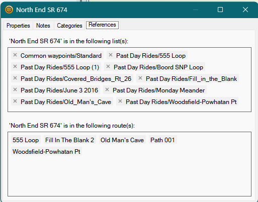

I'm not sure why this old topic showed up this morning as "Active", but my mind jumped to a simpler response than it did in August.
To see if a waypoint is in a route, just open it in Basecamp and click the References tab. It will show all lists and routes containing that waypoint.
A "stray" waypoint may appear in a list, but will not be included in the route.

You can also just hold the mouse cursor directly over the waypoint on the map and after a second or two a list of routes will appear. I like the references tab better, but this works too.lkraus wrote: Thu Jan 15, 2026 12:55 pm I'm not sure why this old topic showed up this morning as "Active", but my mind jumped to a simpler response than it did in August.
