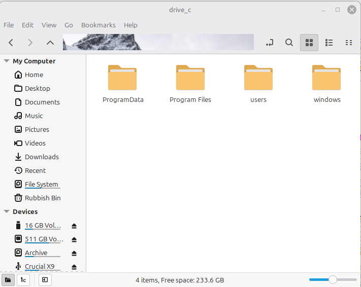

Then copy a whole C:\Program Files (x86)\Garmin directory from a Windows x64 machine into ~/.garmin/drive_c/Program\ Files/Garmin. You obviously need a functioning windows version of basecamp to do this. I run Windows and Linux on two separate hard drives on the machine I did this on so it was easy for me.

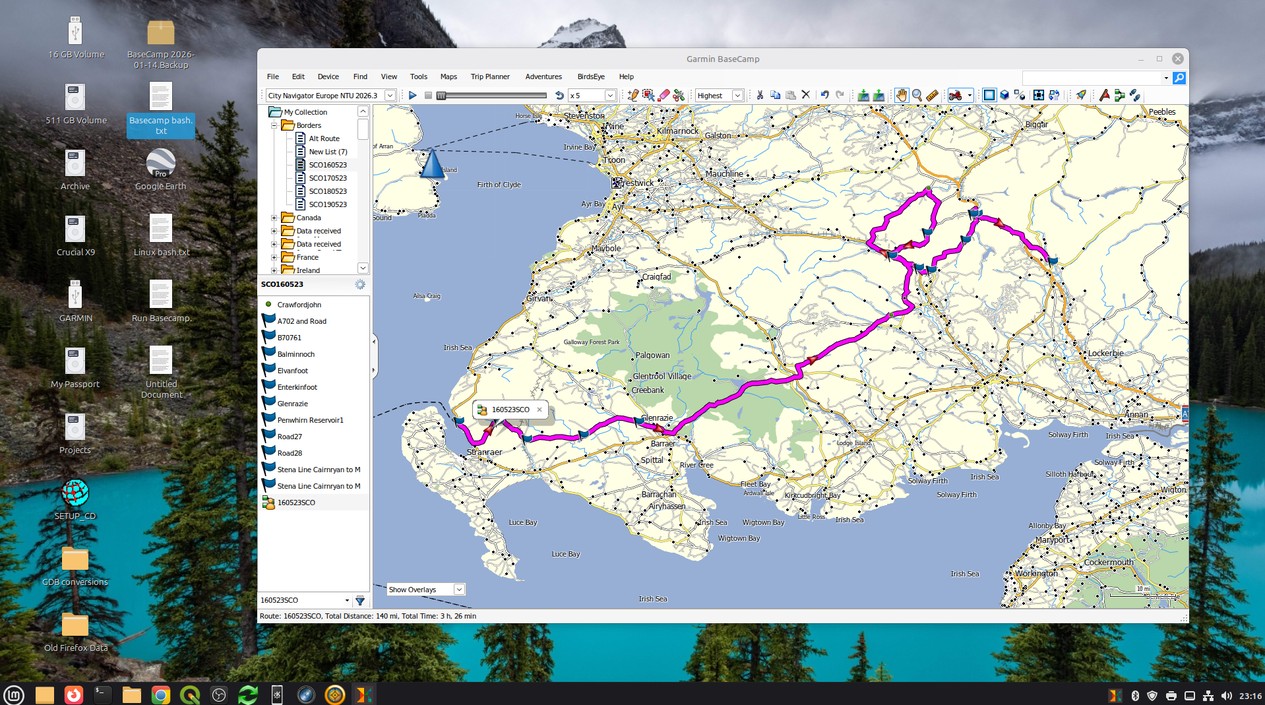

$ WINEPREFIX=~/.garmin WINEARCH=win32 wine BaseCamp.exe
When the last instruction loads Garmin BaseCamp should boot.
I've also installed the City Navigator Europe NTU 2026.30 on Linux

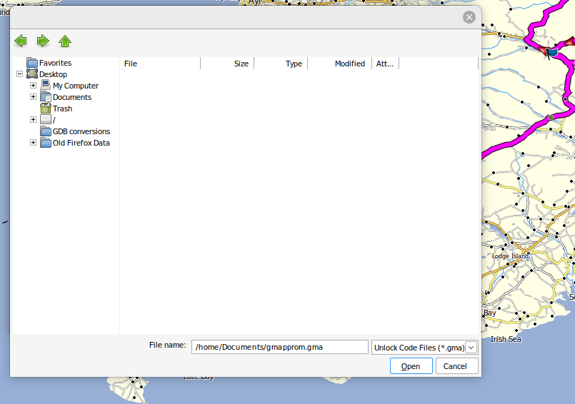

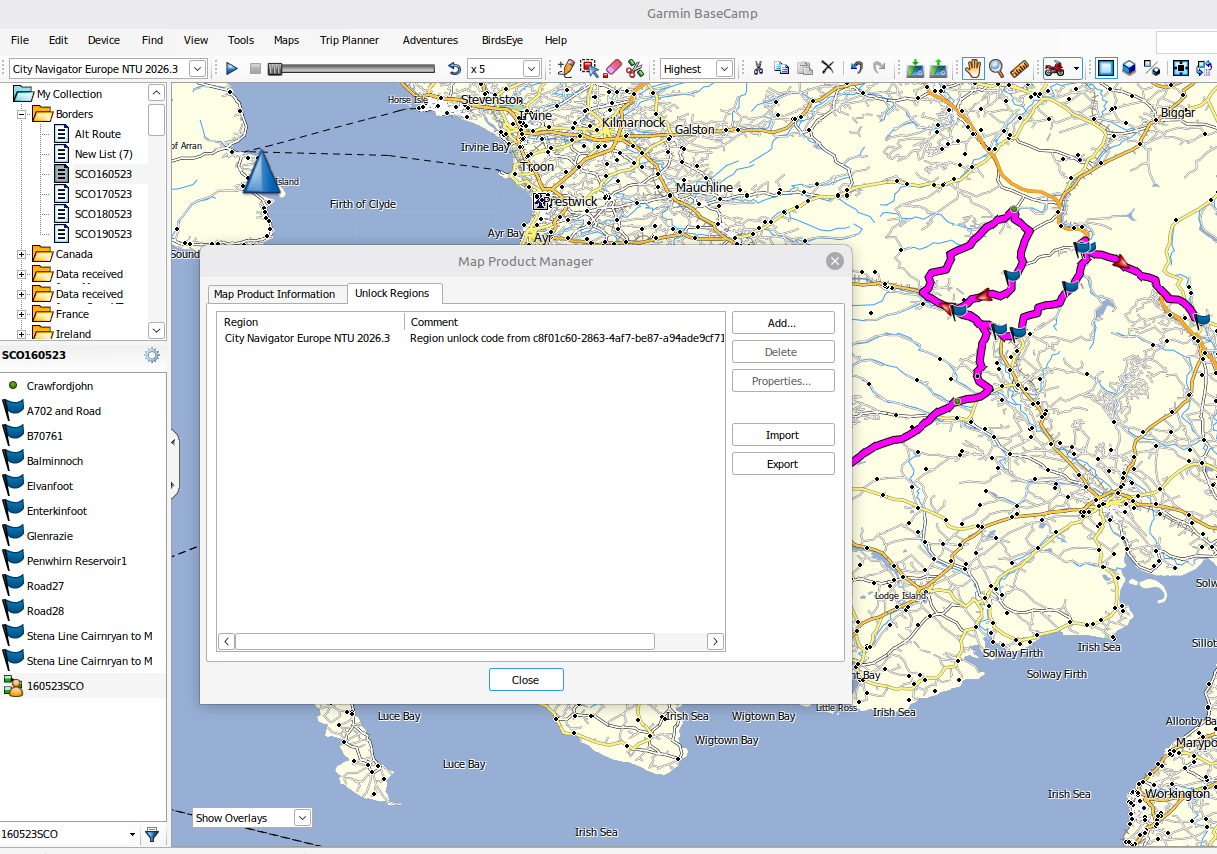

you won't be able to see your garmin maps as they will be locked. I fixed this by going to maps > manage map products> unlock regions tab and importing the gmapprom.gma file from the Zumo .system folder. (careful in there don't delete anything or you could brick your unit.)

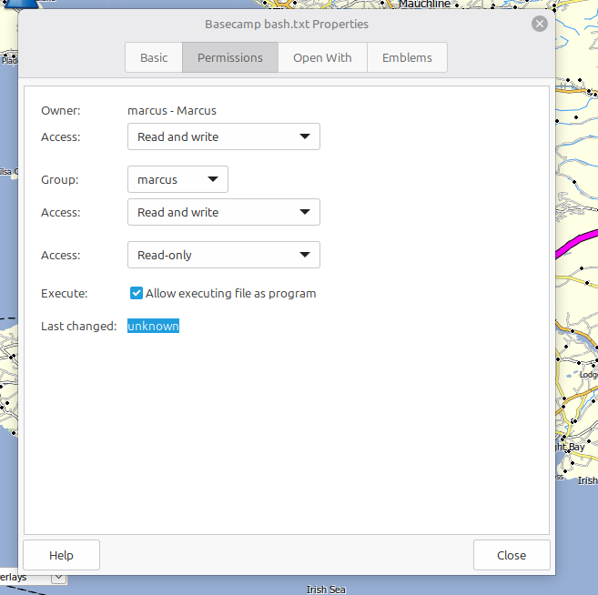

So that you don't have to launch Basecamp using Terminal every time you want to use it. Make a script to run the commands to open it
Open a text file on the desktop and insert this text
Open the Terminal and Run the following command:
cd ~/.garmin/drive_c/Program\ Files/Garmin/BaseCamp
close the text file go to properties and tick allow executing file as a program
When you click on that BaseCamp will launch.
