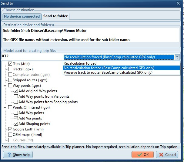

As for sending your GPX as trips to the XT2 use method 5 described here:
https://frankbijnen.github.io/TripManag ... evice.html
Let me know how it goes
