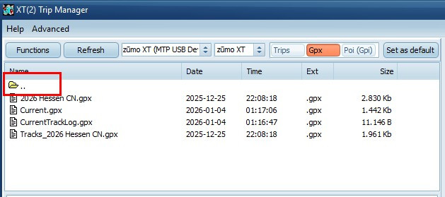

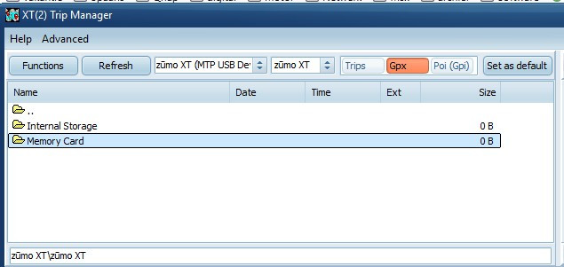

Provided your SD Card shows up in Windows Explorer, this is the method to access it in Trip Manager.
Keep double clicking the 2 dots to get one level up, until you reach the point where you see the SD Card.
If you want to set the default for GPX files to your SD Card.
- Click on the GPX button
- Navigate to the folder on your SD card you want to use. (Using the .. dots)
- Click on the 'Set as Default' button
