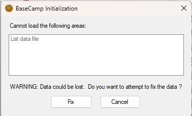

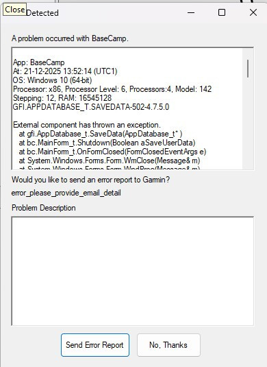

Upon closing BaseCamp you may get this dialog.
BC Error.jpg (55.1 KiB) Viewed 933 times

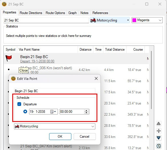

For example setting a departure date after January 19, 2038. January 19 is still OK, January 20 will make BC crash.
Other scenario's may also cause it. In general watch out with dates after January 19, 2038.

- What may be confusing is that you can import a GPX with such a date, change the departure date of a via point to such a date, recalculate the route and even export to GPX. That all works well. The error only shows when closing BC, and the data needs to be saved in the DB.

It appears to be an error when saving data to the DB. The DB is thus in an unpredictable state. When restarting BC you will get an option to FIX. That does NOT always work.
