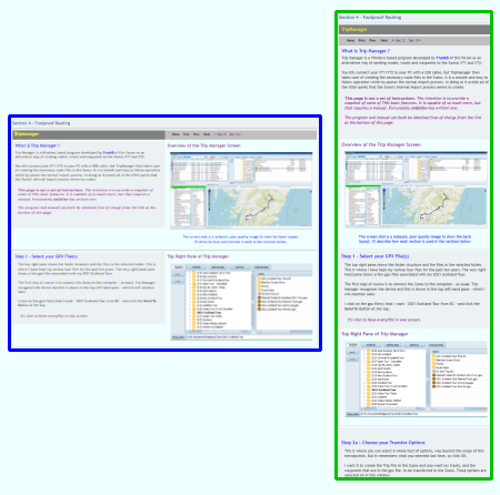

I have developed a new 'responsive' layout for these pages about the XT2.
In landscape view, the page is made up of pairs of blocks placed side by side, with additional pairs of blocks underneath. Each block can contain text, pictures or both. Usually, text is on the left, image on the right, as shown in the blue outlined image below.
300 Layout.png (142.48 KiB) Viewed 3353 times
When the page is displayed in portrait view, or on a narrow screen like a mobile phone (or if you shrink the size of your browser on a computer), then the right hand block drops underneath the left hand block - so text is shown above the associated image. See the green outlined image.
The images with the blue and green outline show the same page displayed on different width screens.
