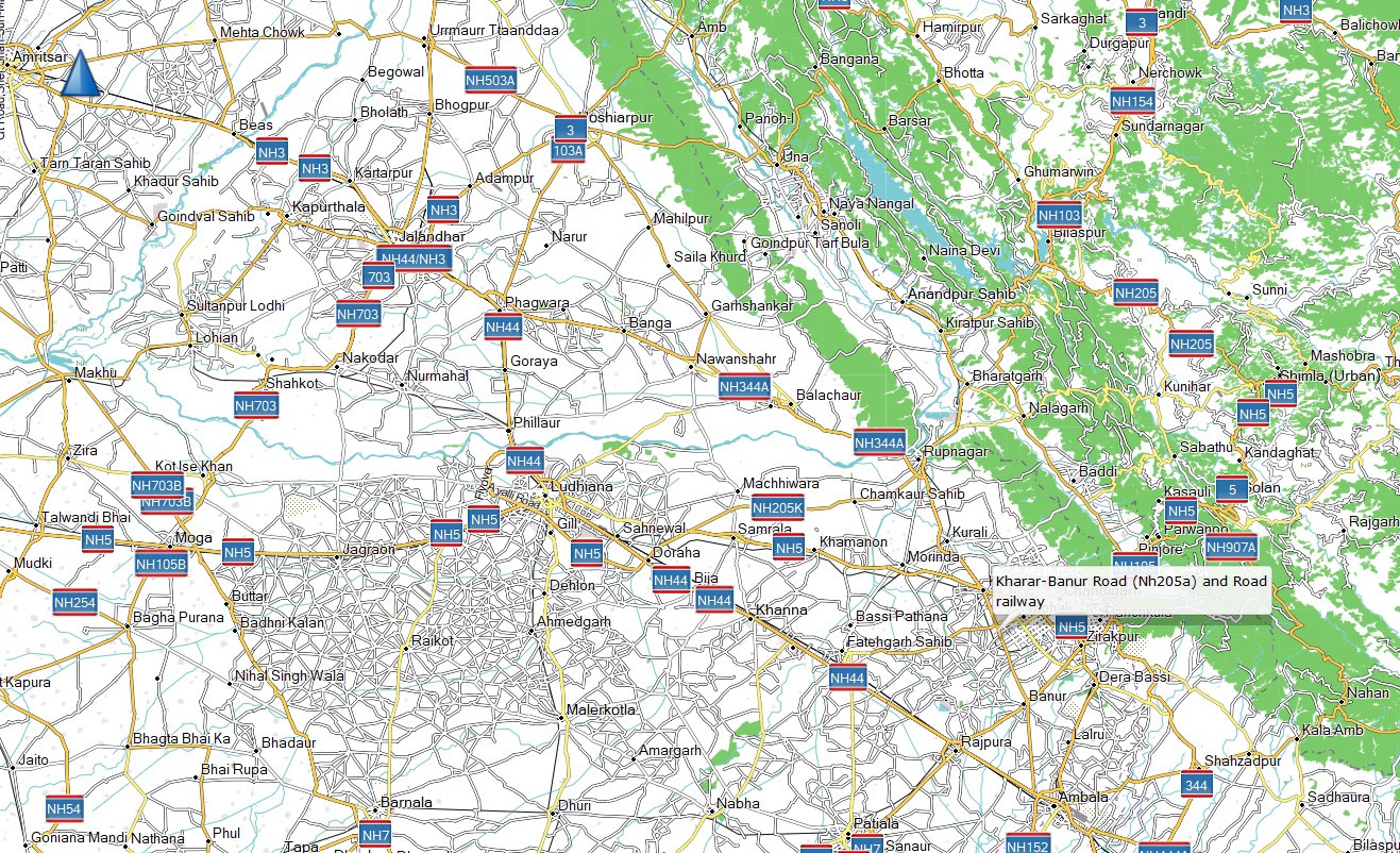

Re: Map for india???
Ran a quick test. Works!
This is how it looks in BC. An image for the device is also available.
