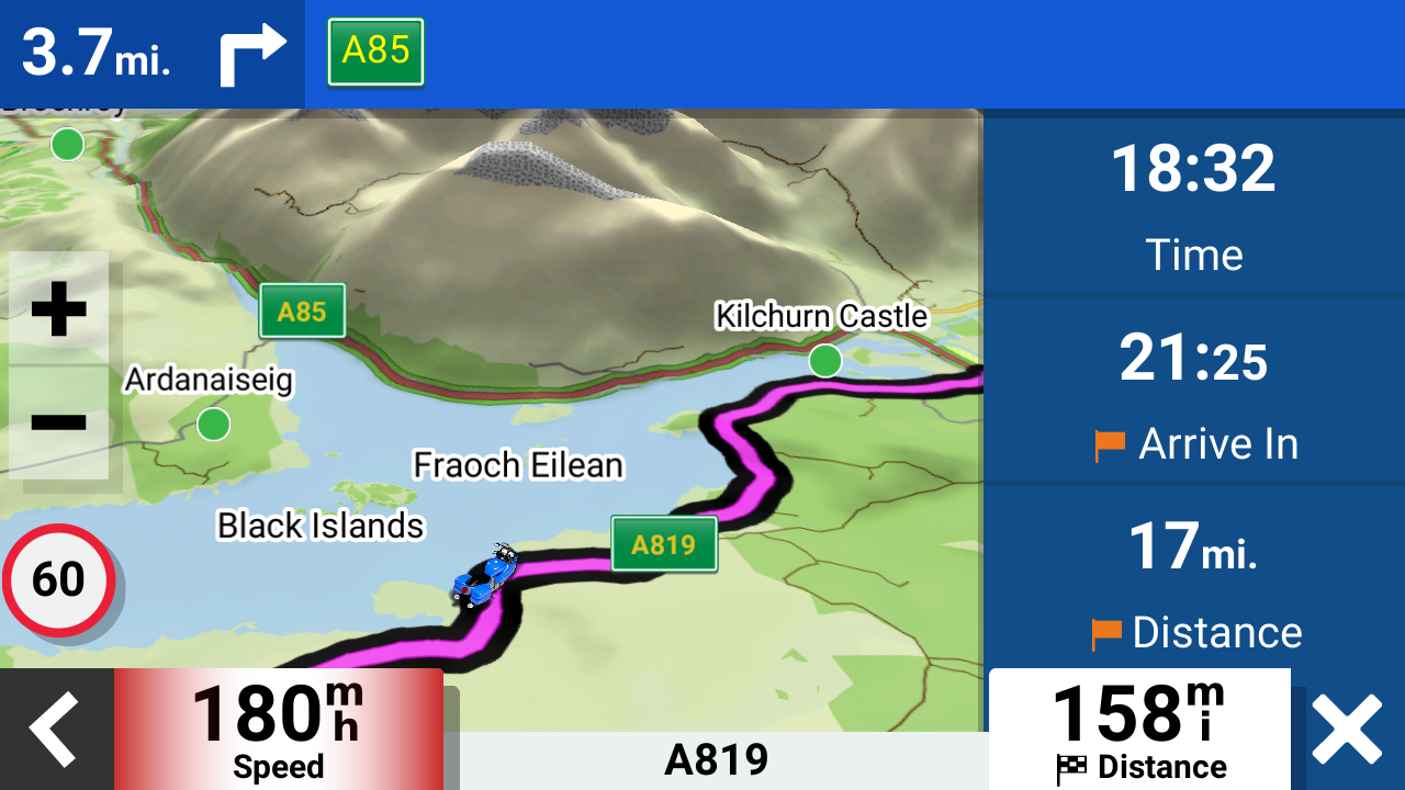

This is a post that I created for a specific response to a question. It has been buried in the middle of a thread, so I said that I'd make it into a thread of its own to make it easy to find. Here it is. (I've left the previous copy intact for now).
312a Map - TripData.png (893.53 KiB) Viewed 1130 times

Note that the width that you set for the track using the tracks screen is then multiplied by the new scale factor. I find that keeping that to Medium is the best way.
When zooming in and zooming out, the scale factor seems to be a little slow in responding - but it rapidly settles down. Some times it is hard to see - but mostly the black outline shows up clearly around the edge of the magenta route.

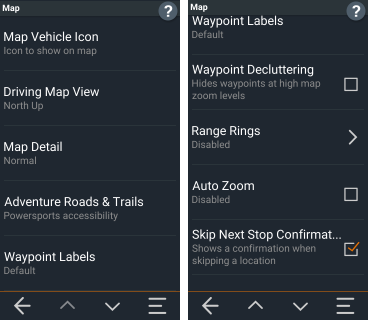

@turbo19, may i probably should have expressed myself more clearly, but I can't find no significant better words than the ones I wrote: "... Tread 2 no longer seems to support changeable/replaceable designs ..."
On my Tread 2 Device I couldn't find a menu for Map Theme setting and no *.kmtf files on the device also.
