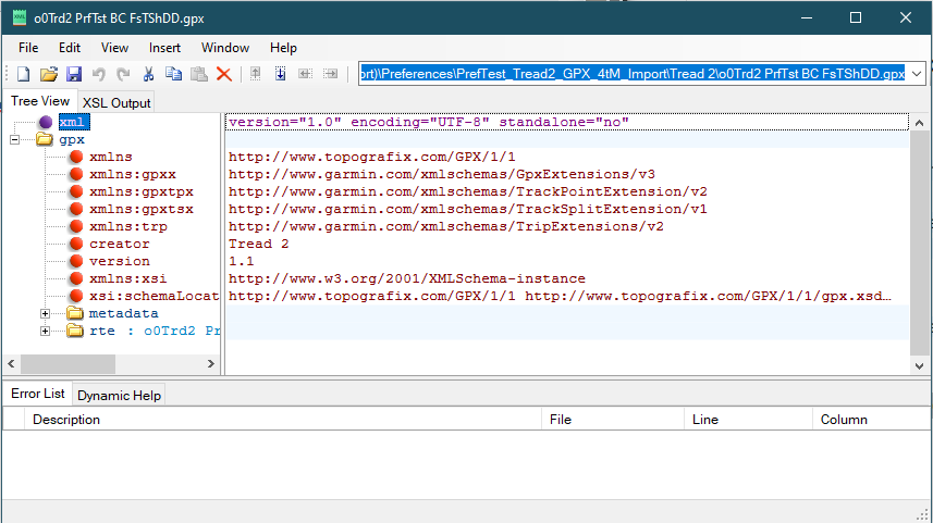

@proofresistant
Microsoft XML Notepad is quite unique in that, in addition to the GPX core, it also checks the Garmin extensions based on their schema.
https://microsoft.github.io/XmlNotepad/
Validation using this tool is therefore recommended by Topografix.
https://www.topografix.com/gpx_validation.asp
So apparently the Tread GPX export is incorrect after all?
viewtopic.php?t=3447
Basecamp so rightly rejects this GPX export because the file is not compliant.
The Garmin GPX extension has not been respected.
Kurviger web apparently has copied the Tread app export mode?
https://forum.kurviger.com/t/new-export ... 269?u=0709

0709 wrote: Sun Oct 05, 2025 7:19 am Microsoft XML Notepad is quite unique in that, in addition to the GPX core, it also checks the Garmin extensions based on their Schema.
I'll take a look at it, but as a non-professional, Notepad++ with plugins should suffice for my needs.
Sometimes I simply rename gpx to xml and view the file in Edge.
OK, i don't recognize schemas, but at least I can see the formatting and read the file better.
And honestly, which schemas are in the background is too deep into development for me anyway.
0709 wrote: Sun Oct 05, 2025 7:19 am So apparently the Tread GPX export is incorrect after all?
Whether the schema doesn't fit the GPX or the GPX doesn't fit the schema, I'll leave that aside for now.
The fact is, the GPX contains Adventurous attributes that BaseCamp doesn't like, but other tools or Navi devices do, Even if they ignore some of the content.
0709 wrote: Sun Oct 05, 2025 7:19 am Basecamp so rightly rejects this GPX export because the file is not compliant.
Yes and no ;-)
May BaseCamp GPX extension has not been respected or may Schema is out of date ;-)

Well, the situation is this.
I don't have a motorcycle and haven't had a Garmin (cycle) GPS for over +10 years.
I sometimes still use Basecamp as a tool to quickly check whether a GPX file is valid.
This is also very effective for the many Garmin extensions with schematics.
Basecamp imports the compliant GPX files but rejects invalid GPX files without mercy.
However, Basecamp does not report the cause.
I also follow the Kurviger website to some extent.
According to forum members, Basecamp rejects the new Zumo XT2 export.
This is a good reason to investigate.
I use Notepad++ with the xml plug-in and the compare plug-in.
Notepad++ makes it easy to check and validate the gpx core.
Microsoft XML Notepad also checks the Garmin extensions.
This tool can be installed in no time.
@proofresistant.It is definitely recommended.
Although sometimes annoying, it is commendable that Basecamp is strict.
It seemed very strange to me that Garmin Tread gpx would violate the rules.
@jfheath
Thanks for the additional information and especially for the demo gpx file.
Very surprising.
- The result is file 1.
It lacks just about everything required for a compliant gpx1.1 file.
The file does not even import into some fairly tolerant GPS apps.
The file also does not import into Microsoft XML Notepad.
- Action.
Added encoding utf 8.
Added creator (mandatory).
Applied the topografix and Garmin extension schema references. (desired)
Change Ansi to utf8 and remove Trade Mark symbol in the Garmin Tread app text.
- Result is file 2_
The tolerant gps apps do import the gpx.
The strict Basecamp does not.
- Validation using Microsoft XML Notepad.
The error list shows you the (4) errors.
trp:AdvanturousLevel is therefore not allowed.
The Garmin extension has not been respected.
Garmin is violating its own schema here.
Strange, as Garmin was always exemplary in terms of gpx conformity.
The files in the zip.
Translated with DeepL.com (free version)
Tread.zip
(4.09 KiB) Downloaded 37 times

Then please take a look at my "o0Trd2 PrfTst BC FsTShDD.gpx" example, exported from the device.
Even with XmlNotepad, I don't see any fundamental structural problems.
o0Trd2 PrfTst BC FsTShDD.zip
(5.7 KiB) Downloaded 50 times
o0Trd2 PrfTst BC FsTShDD (XML Notepad).png (69.64 KiB) Viewed 631 times
I would be happy to receive your feedback.
