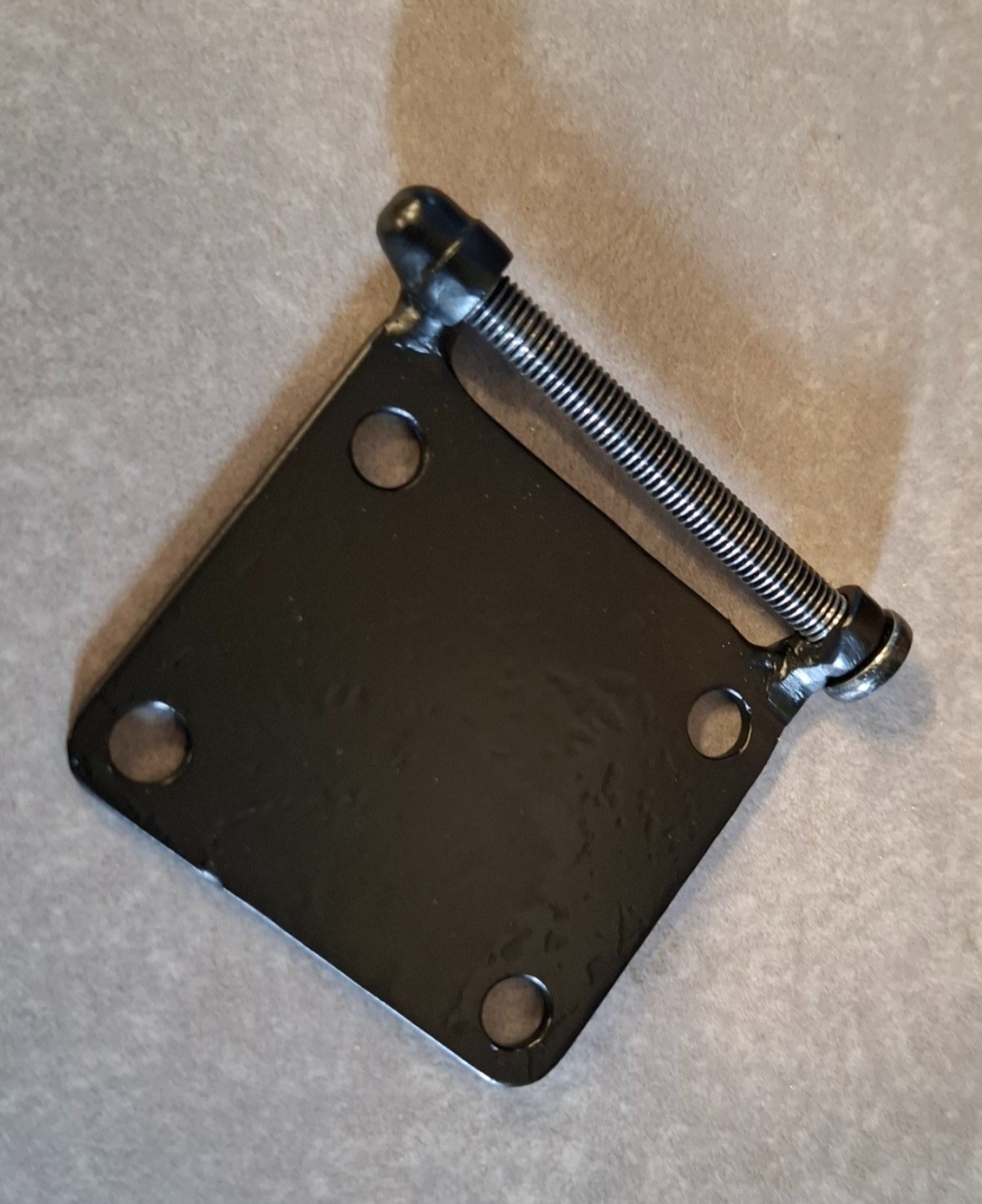

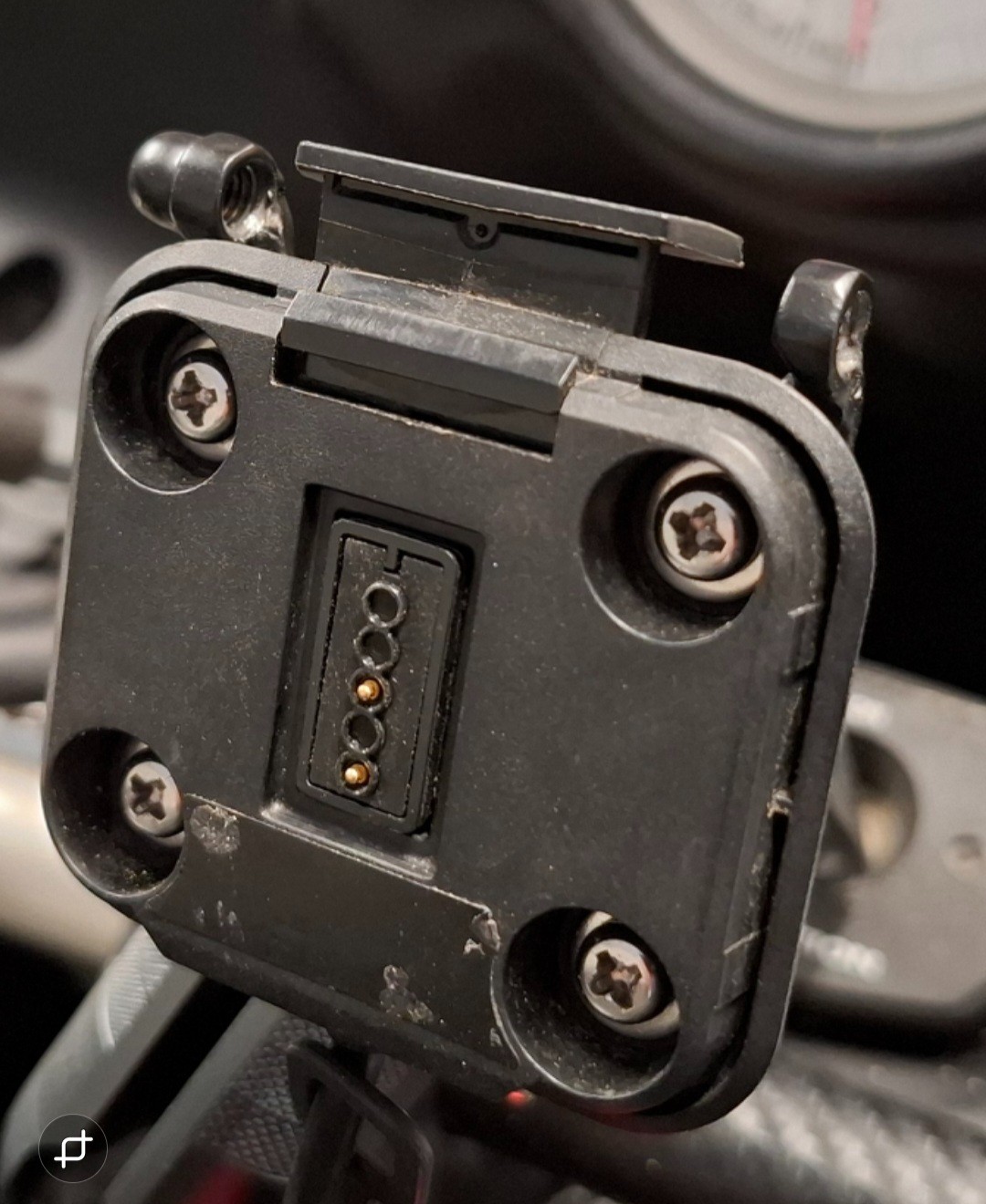

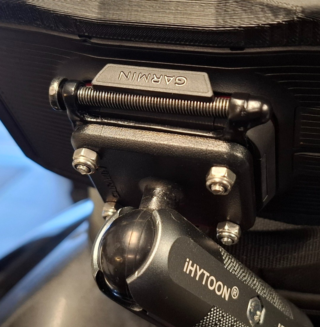

This week I was trying to be creative and test my welding skills as a total beginner 8-)
I designed this based on some other popular designs out there. It cost me nothing - all of the material I already had at home. In general there is just a plate and two nuts welded in a right place. It is all made of inox, so it won't rust.
I still need to change the "main" screw. I plan to use allen head screw as it is much harder to unscrew with hand and then I will probably buy the allen key as a keychain to carry on my motorcycle keys.
I am not going to leave my Zumo anywhere for a longer period of time, never over night, but I am sure it will give me some peace of mind when I go grab a coffee or pay for my petrol... Anyway, ride safe everybody :)
