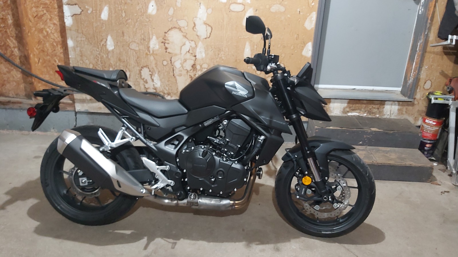

The Bike:

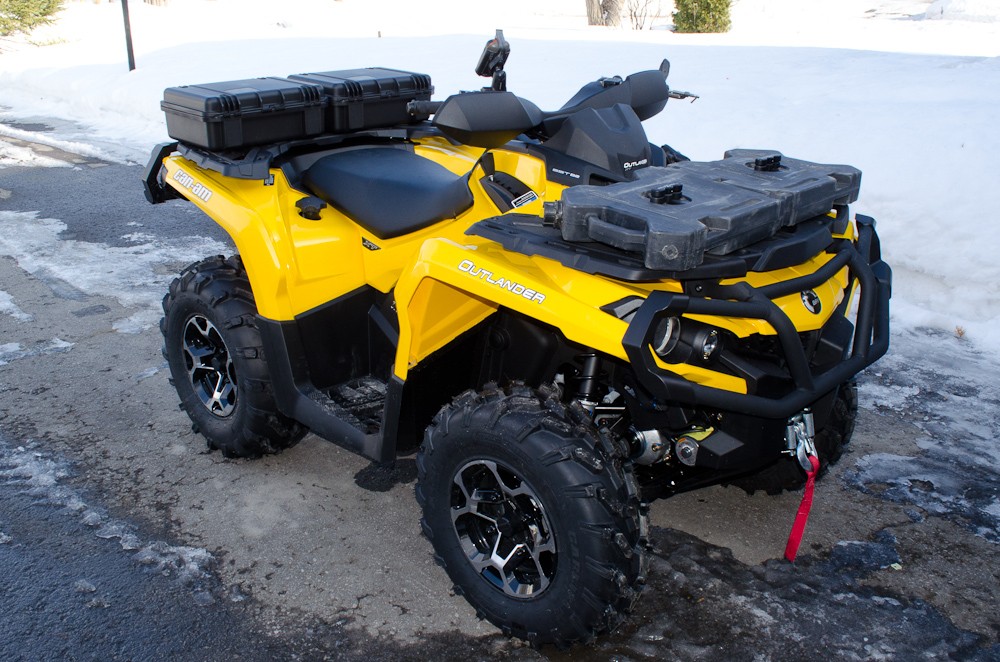

The ATV:

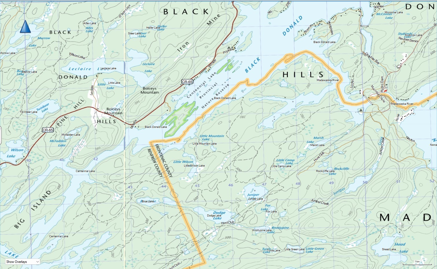

Custom topo on BC:
BC Map.jpg (392.82 KiB) Viewed 742 times

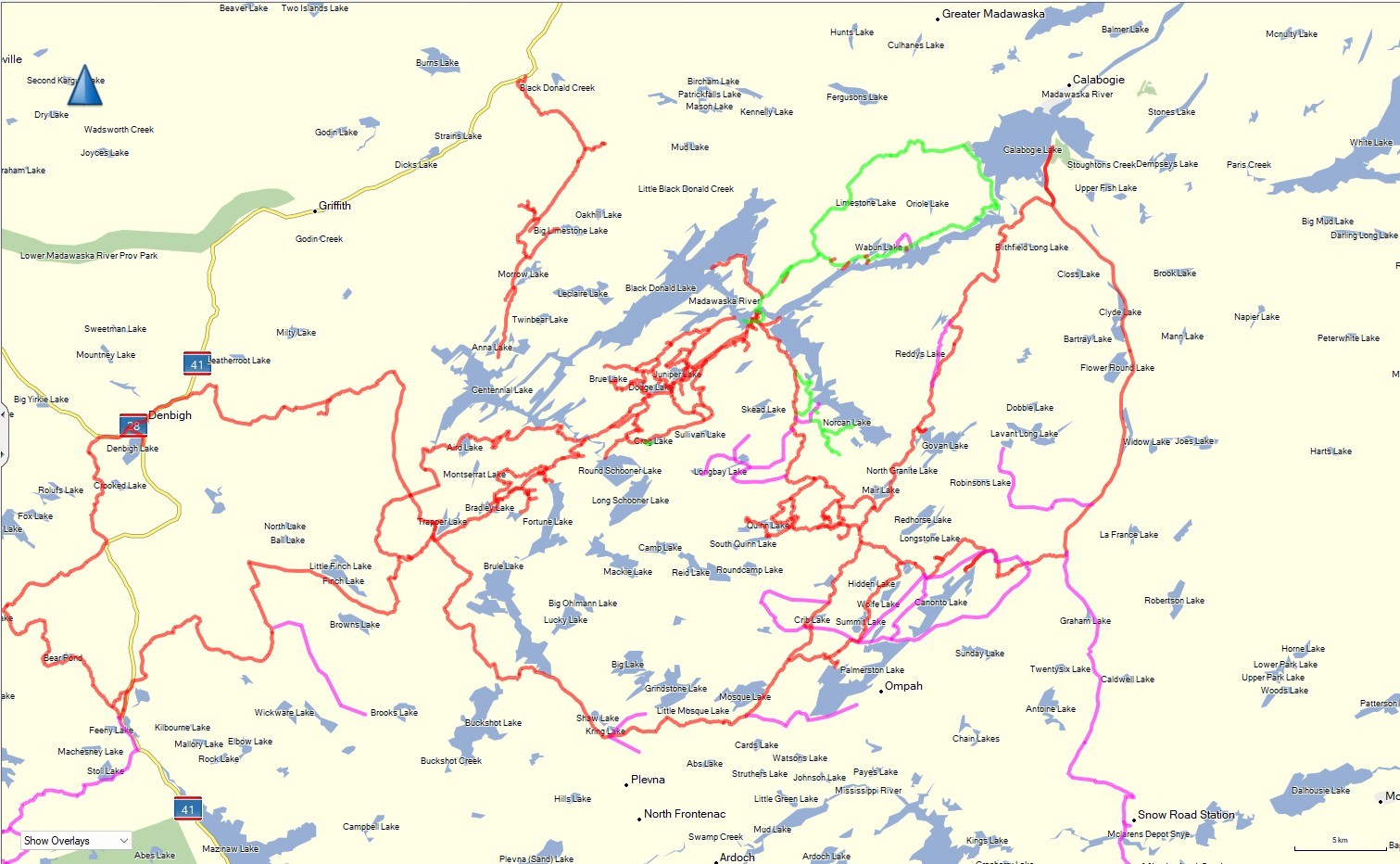

ATV trails in BC as tracks:
BC trails.jpg (276.03 KiB) Viewed 742 times

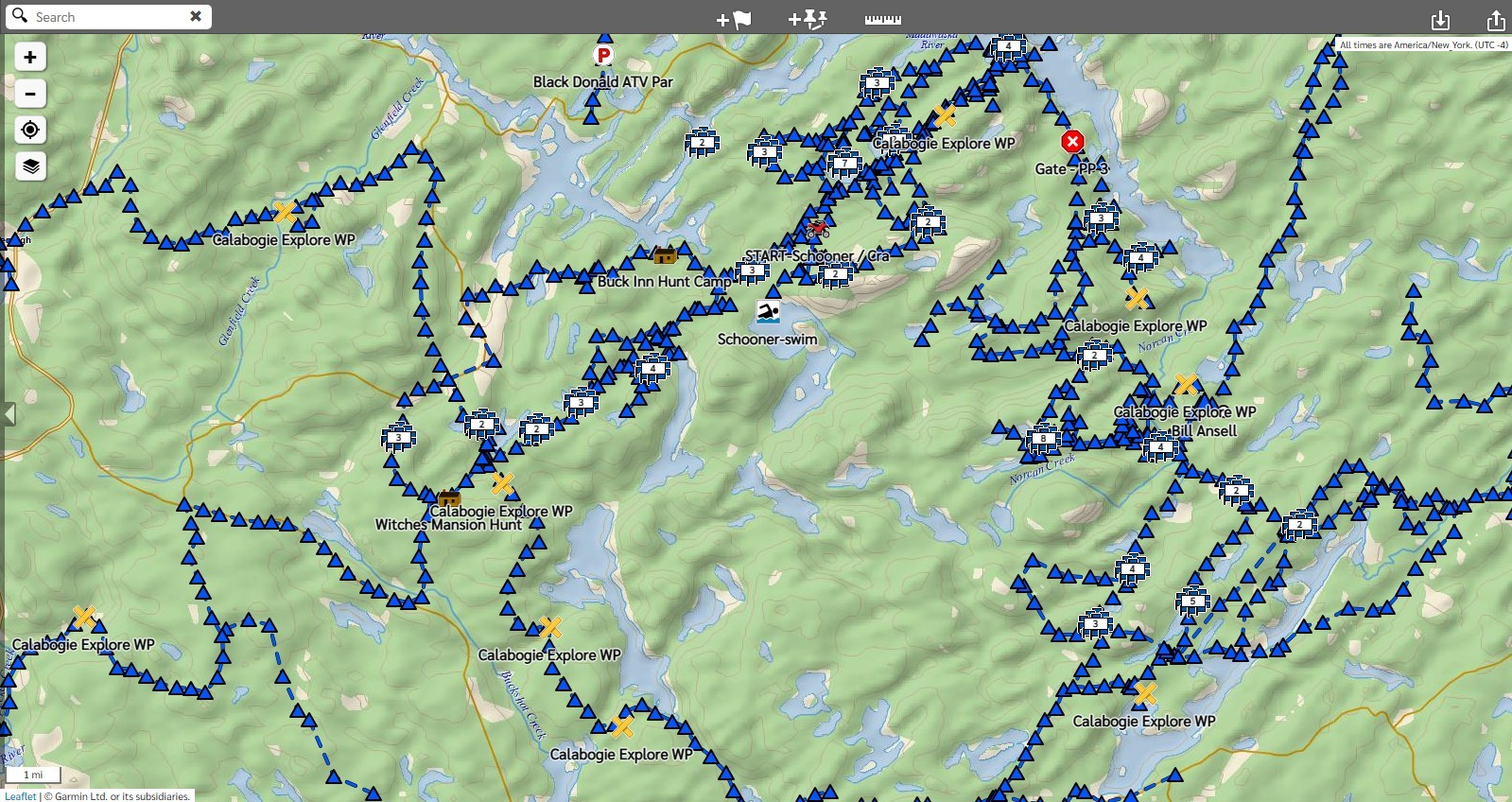

Tracks in Explore on PC:

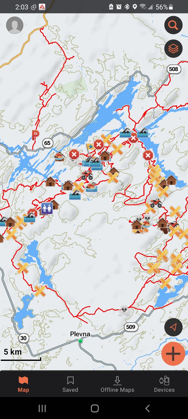

Tracks and waypoints in Explore on phone 5km scale:
Explore - 5km.jpg (275.62 KiB) Viewed 742 times

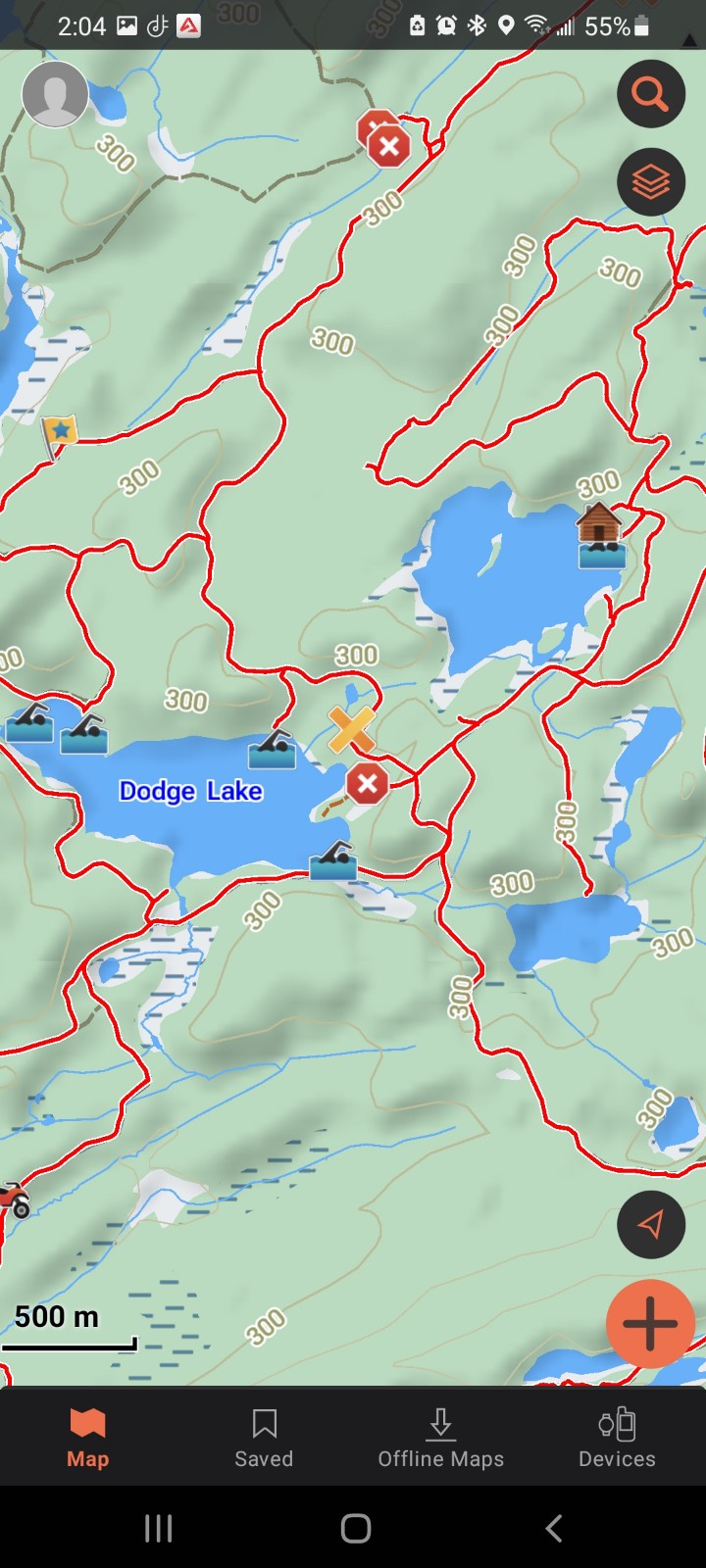

Tracks in Explore on phone 500m scale:
Explore 500m.jpg (213.25 KiB) Viewed 742 times

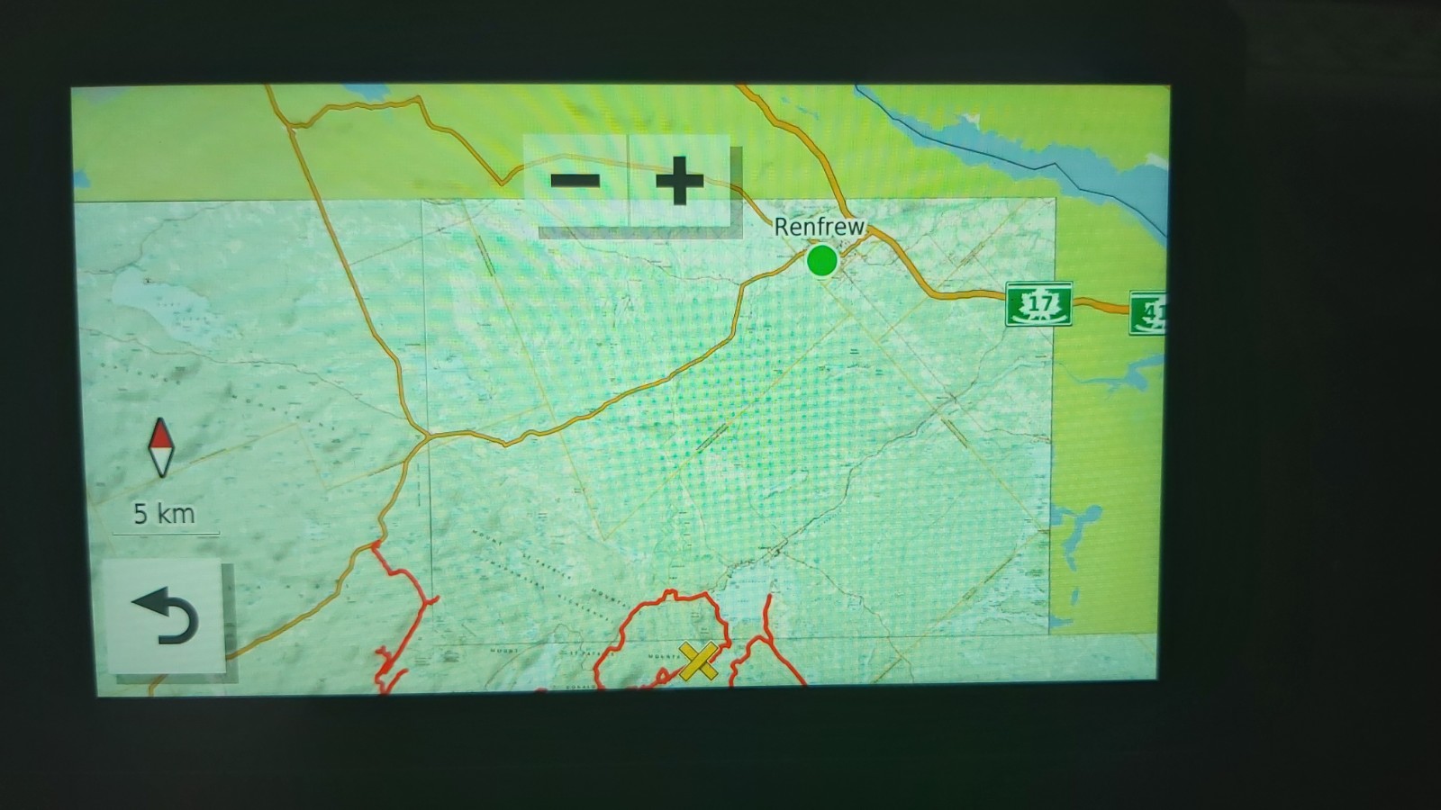

Custom Topo on the XT - 5km scale:
XT CANTOPO 5km.jpg (251.92 KiB) Viewed 741 times

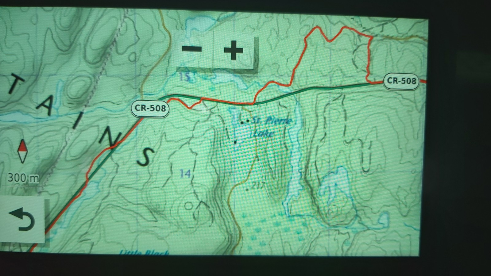

Custom Topo on the XT - 300m scale:
XT CANTOPO 300m.jpg (362.76 KiB) Viewed 741 times

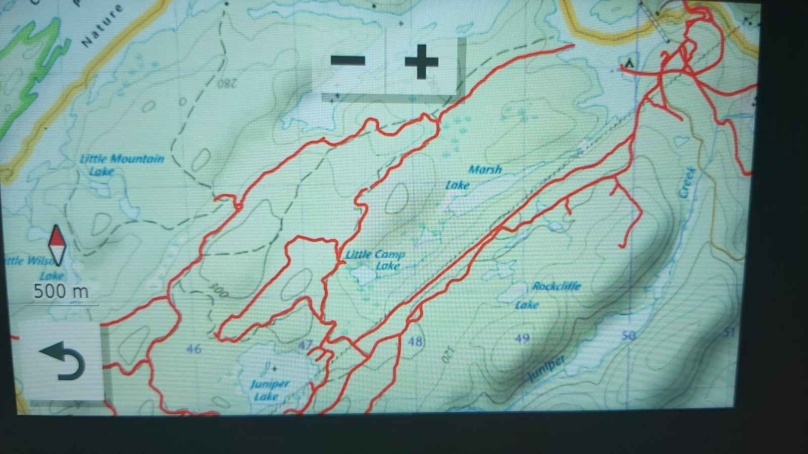

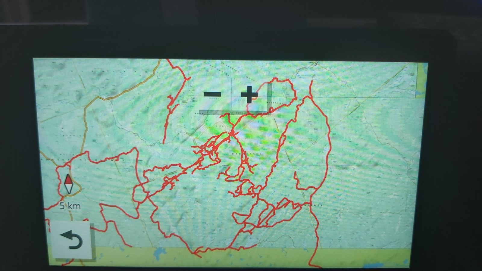

ATV tracks on the XT with custom topo layer underneath
@5km scale:
XT CANTOPO Tracks 5km.jpg (291.24 KiB) Viewed 741 times
@500m scale:
XT CANTOPO Tracks 500m.jpg (397.94 KiB) Viewed 741 times

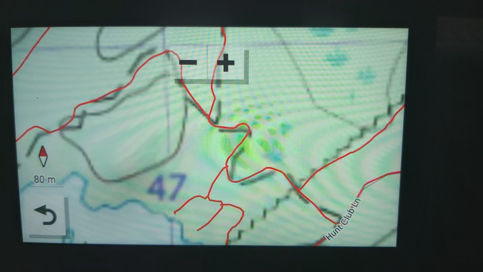

@80m scale:
XT CANTOPO Tracks 80m.jpg (228.49 KiB) Viewed 741 times

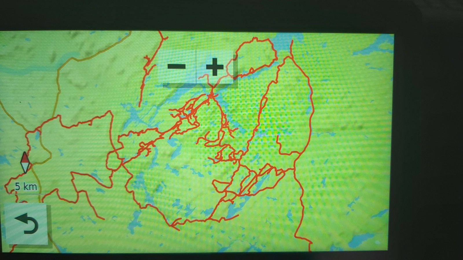

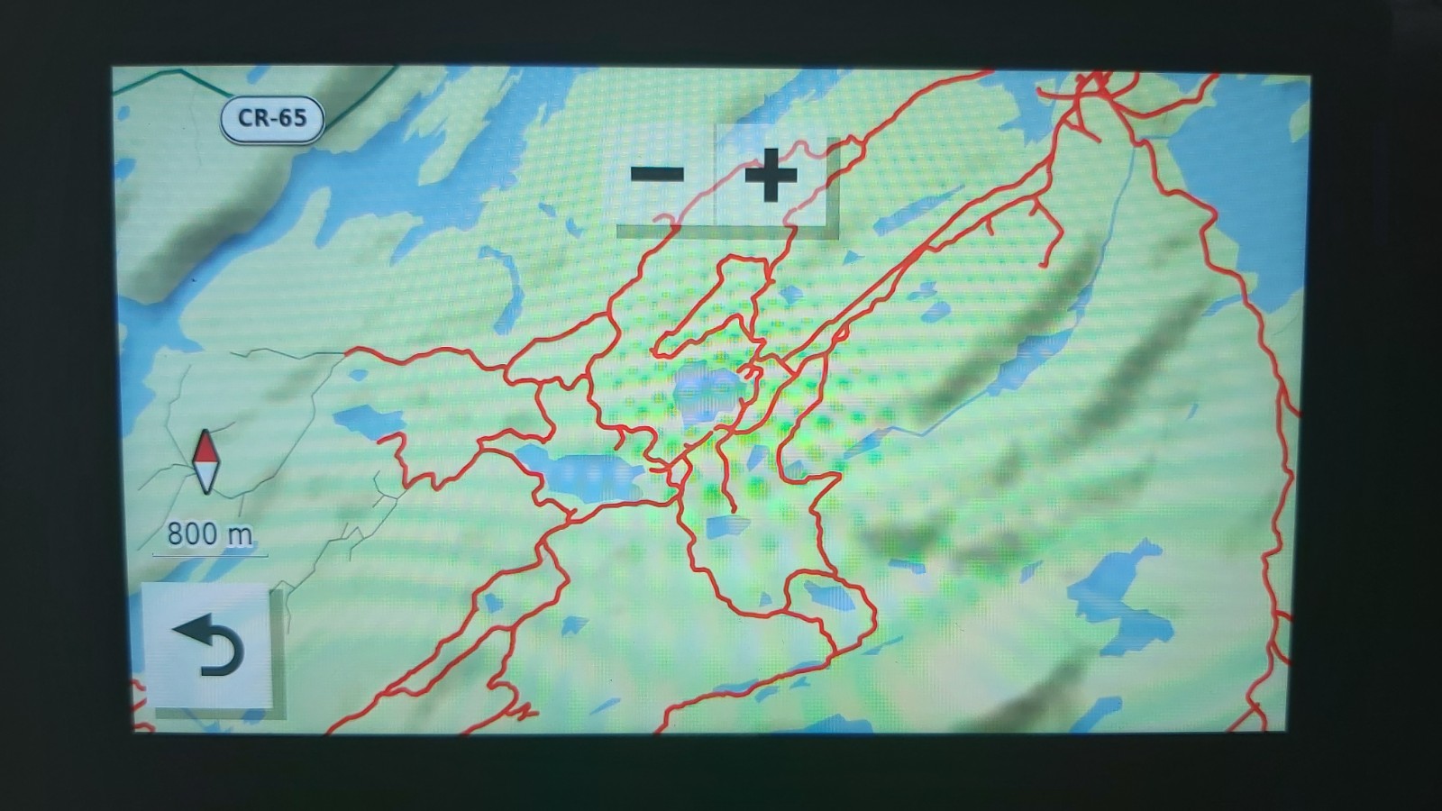

ATV tracks on the XT just using XT maps:
@5km scale:
XT Tracks 5km.jpg (338.69 KiB) Viewed 741 times
@800m scale:
XT Tracks 800m.jpg (278.16 KiB) Viewed 741 times

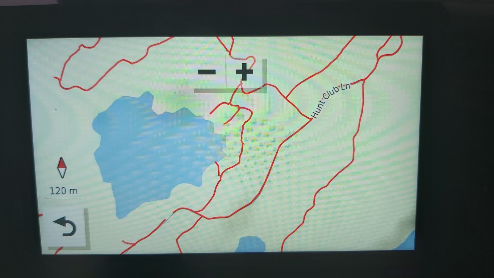

@120m scale:
XT Tracks 120m.jpg (215.94 KiB) Viewed 741 times
