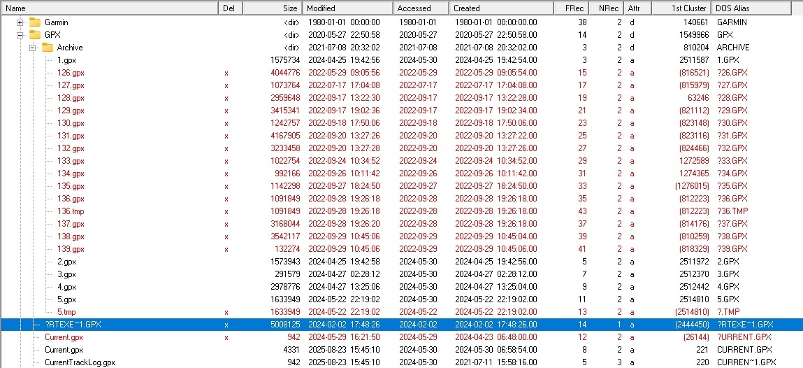

The screen shot (click on it to see it in original size) is of Drive G: - An attached Garmin Zumo 590, which I bought second hand off the internet cheap. It had dodgy case - but that was OK - I was replacing the circuit board. I've never taken it out since I bought it a few years ago - it has only been used as a desktop aid for reference. It is set to use Mass Storage - becasue that is the only way tthat you can make the .System drive visible on the 590/595s.
So my Disk Management Software (PrivateDisk) can read all fo the file names of valid and deleted files and it can make a good stab at recovering the data from the disk drive - if it has not been over-written.
All of the red entries are deleted files. The black ones are current. They are dated April 2024. They are mine and contain only the tracks that have been recorded while at my desk ! I'm surprised that it has used up to number 5.
The deleted ones are from May to Sept 2022. The 1st Cluster column at the right hand side - some of them are in brackets, which means that the first cluster has been overwritten. 3 are not overwritten, so I asked the software to recover the files.
What I got was gobbledegook. The first cluster may not have been over-written, but it must be pointing to the second cluster which definitely has been overwritten. And that is just from me turning the Zumo on and off without any further tracks being recorded.
So it looks like even if you managed to get access to the drives, they are not going to give up a great deal of information.
