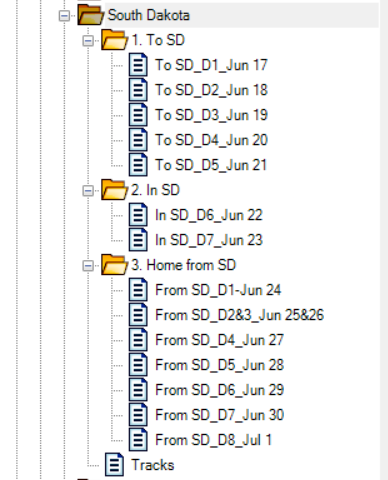

I do not know what you refer to as a "collection" in Basecamp. I use tiered list folders. For instance, last year I made a 15 day trip to South Dakota. My Basecamp structure looked this: I export individual routes and tracks, each one as a separate export so that each one is in its own .gpx file. The export goes to my local hard drive from which I copy to the SD card. The folder structure on the HD and SD card would be similar to what I did in Basecamp. This allows me to have granular control over the files. If I need to change a route the day before departure I can delete the two .gpx files associated with that day from my HD and SD card and replace them with the new ones. Same goes for modifying a route while in a hotel room mid-trip. Some people consider this too difficult. I understand that however I am a borderline computer geek; I think at the file level (one file per route, one file per track).Philomène8 wrote: Thu Aug 21, 2025 8:36 am Also, have you tried using collections in Basecamp instead of separate lists? You can still export them individually as GPX but it keeps everything under one trip umbrella. Might save you some file management time.
