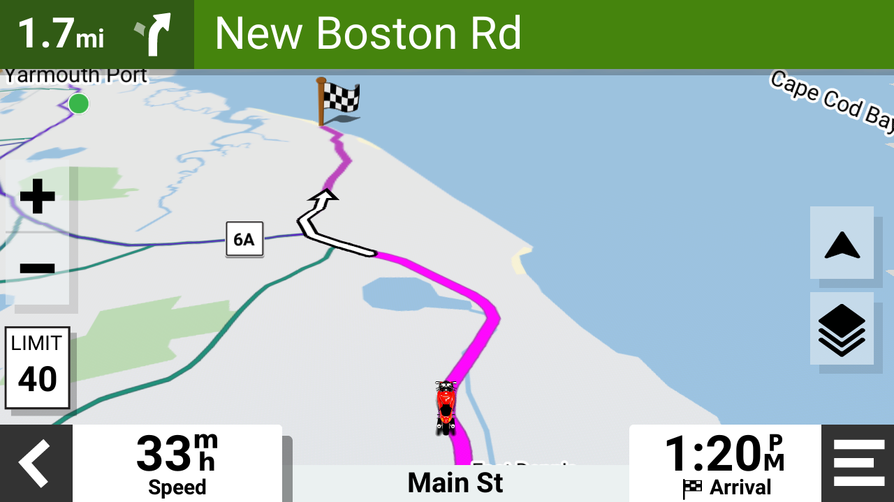

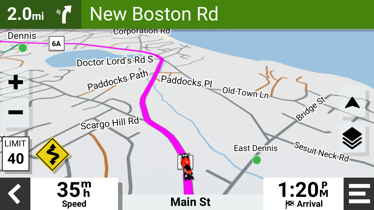

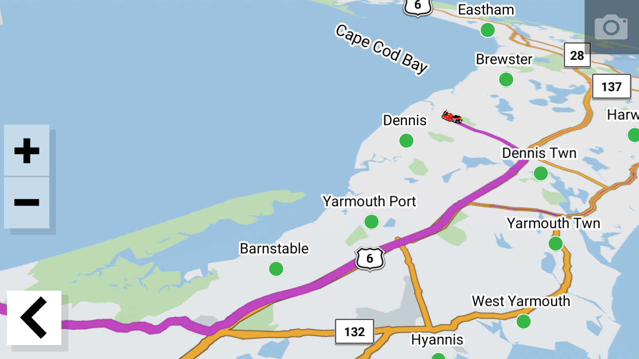

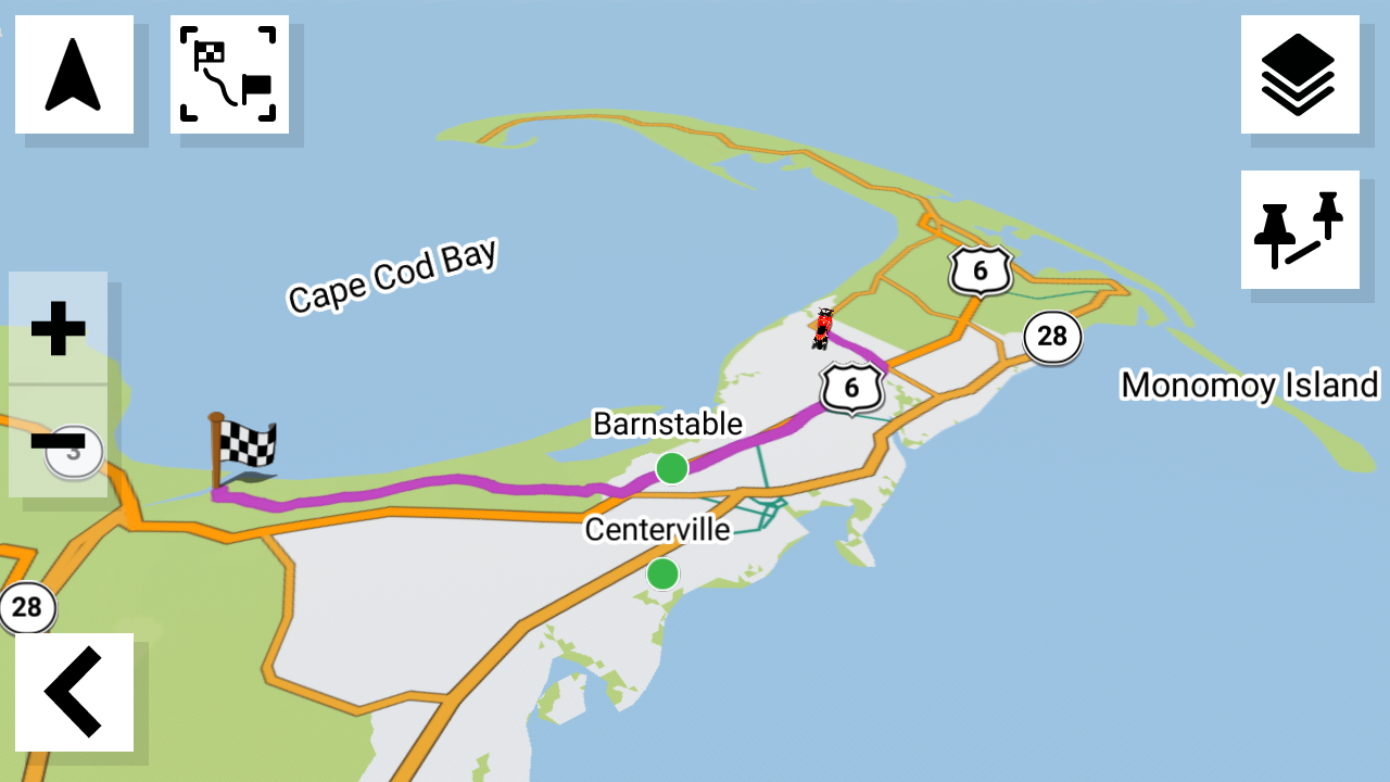

To check this for you, (while stationary), i just tapped "where to", entered a location miles away, tapped Go and zoomed out. The map filled in just fine. Screen shots below.
I did not have anything else going at the time. I do not use the Tread app at all.
This doesn't give you any info as to why the issue you report is happening, but hopefully it helps a little at least.
